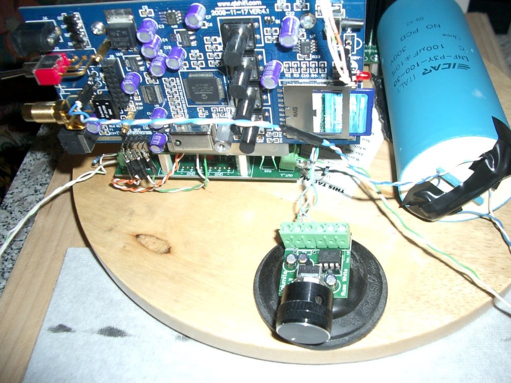

Heres one I did a few mods to.
Upgraded the onboard 3v3 LDO regs to Paul Hynes Micro shunts.
Changed the stock XO to a Tent
Changed the SPDIF RCA to a 75R BNC.
Added a SIL pin socket to the I2S pads (not tried I2S out with it yet)
I'm pleased with the results, I've tried the QA-550 with a modded BuffaloII, Monica3 and Audial AYA II.

also, do you guys know what the big reg above the angled oscon in leo s picture do? giving 5V to the LDOs and to non-audio related devices?

It's a 7805 (5V) regulator.
Can anyone tell me the values of the oscons and the smd bypass caps?

I started to have a play around with one of these just out of inquisitiveness. The board is a Rev 3.0 (2009) & looks a bit different to Leo's pic. I tapped I2S out of it. I'm running i into a Sabre ES9022 DAC. The sound in between clicks & buzzes isn't stunning, by any means! I'm using the MCLK from the QA550 into the Sabre, ie. synchronous, I will try the Sabre DAC in asynchronous format to see if it helps things. But the convoluted length of the I2S traces from the PIC chip is not optimal. This may account for the bad I2S signal or it may be the relationship between the clocks - the MCLK is 256fs, isn't it? (LRCK 44.1kHz, MCLK 11.2896MHz)
I2S is also fed into the CS8405a DIT - no buffer between this & the I2S outputs on the board. This could give rise to problems also.
Euvl, is the sound feeding I2S into ES9022 as good as you say? Are you just using a stock QA550 or with mods? It might be my ES9022 that's at fault - I'll try another one!
