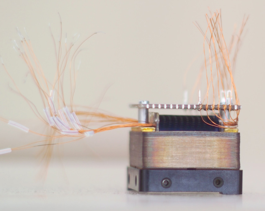

To further simplify and purify my DAC setup, I wound my first TVC.
It will convert from balanced to SE and provide 25 taps on secondary for volume control and give very low output impedance directly from the parallel DAC chips and the low impedance passive filter.
First impression is very good.
Primary has 2 x 500 windings and I did what I have seen on Siemens transformers.
Instead of 500 windings they used stranded wire composed of 10 single enameled wires and made 50 windings only. The ends are connected outside such that all windings are in series, as if it was a single wire with 500 turns.
Any advantage from that trick (?) ?

Just finished the first one.
Measured frequency response flat 0,1 dB from 10 Hz to 20 kHz with 10 k load.
25 taps, 2 dB steps plus one each 3, 4, 5 dB steps on the lower end.
6 dB gain, 1000 primary to 1995 secondary, wound on old Siemens core, 0,1mm sheets with MU shield.

Just finished my second TVC, here a picture of unfinished chaos...

Would you mind describing the winding geometry? Have you got any data on the cores?
analog_sa said:
I suspect that the primary inductance is quite low. Maybe tubes won't be so happy driving it.
Bernhard
My L-meter told me 27H primary inductance with secondary open.
It has 1000 windings.
I have no data for the core but the metal sheets are very thin and fine polished.
No special geometry, see first posting.
