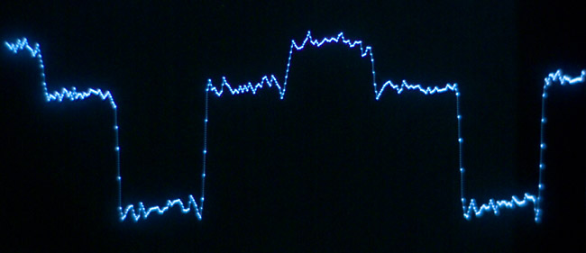

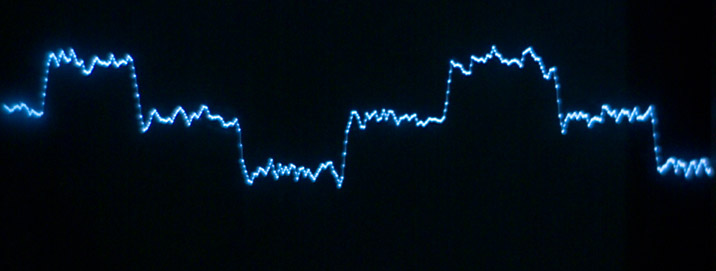

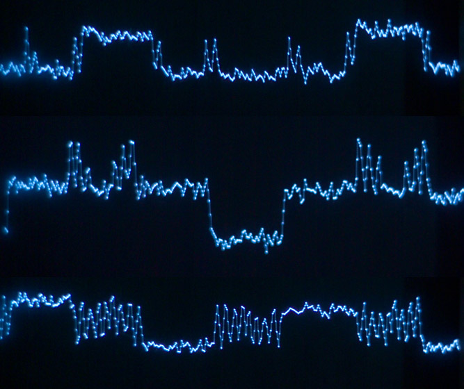

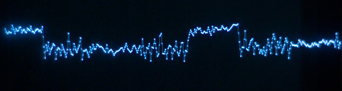

Analyzer with 500mV full scale and 40x preamp:
PCM56 8x os Yamaha CDX-5000 good adjusted MSB track 15
Click the image to open in full size.
PCM56 8x os very bad adjusted MSB track 15
I measured also PCM63, less noise but no better linearity.
TDA1541 4x os Philips CD960 MSB track 15
TDA1541 bad bits ( various tracks )
It also has a few good ones
  Reply With Quote
Old 2nd January 2008, 10:38 AM   #10
AndrewT is offline AndrewT  Scotland
R.I.P.
Join Date: Jul 2004
Location: Scottish Borders
are they supposed to be square waves? or square waves being gated on and off?
