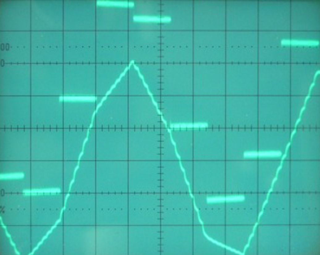

Interesting riposte, EC but overlap is simply impossible.
Each dac is triggered after WS
Click the image to open in full size.
It makes no difference which DAC it is, they are all separated by 8 BCK cycles. When DAC1 is triggered by the relevant WS signal DAC's 2 to 8 are still loading their internal serial to parallel registers with data. DAC2 won't trigger for another 8 BCK cycles and when it does, DAC1 will already have started loading the left channel data of the the next sample and DAC's 3 to 8 will still be loading the current sample.
The whole point of this technique, and it dates back to the the 80's where CD is concerned, is to trade physical resources for dac performance. One creates a composite dac out of 8 dacs that performs as though it were a single dac running at a 352K8 sample rate, something a single TDA1541A can do but thats another story.

> If overlap would simply be impossible, there would be no resolution enhancement and no higher maximum amplitude from the 8 DAC's . I already posted some oscillograms earlier as "evidence" .
If the TDA1541A would output it's sample only during 32BCK, you probably end up with a squarewave signal when 1 DAC is used , as 32BCK gaps would occur when the DAC outputs are zero volts or in tri state?
If I am correct, the TDA1541A outputs its sample after the negative going edge of WS and the following positive going edge of BCK plus a typical 500nS delay. The output sample remains there (TDA1541A internal L and R output latch as indicated in the Philips datasheet) until the next negative going edge of WS plus 0.5 BCK delay, so the sample REMAINS on the output during full 64BCK cycles. During this time, the next sample is already clocked in and is stored in the input latch, and it can take full 64BCK cycles to shift in both L + R channel samples.
Timing chain delays always stay WITHIN this 64BCK window. Max. delay time (DAC6) is 56BCK, so this is still within the 64BCK window.
When DAC1 starts outputting sample n, 8 BCK later DAC5 has also completed loading the same sample n and outputs it, as DAC 5 received the complete bitstream only 8 BCK cycles later [post#414], and in fact is loading it's bitstream together with DAC 1. Similar happens with DAC3,7,2,8,4,6 in that sequence. Remember, the shift register delay circuit delays the entire bitstream, all individual databits included, so it also acts as a serial sample BUFFER / memory. Same applies for WS (very important), it is not just delayed, it is serially buffered by the serial shiftregister and remains fully in sync with both BCK and the delayed data. So the D-I system needs serial memory to function correctly.
That is why I call the samples from DAC's 5,3,7,2,8,4,6 clone samples, as they are merely exact copies of DAC1, spread out within 64BCK cycles, at 8BCK intervals.
All 8 DAC's are clocking in the same bitstream of sample n, the only difference is, they complete this operation at multiples of 8BCK in this case. So all 8 DAC's can output sample n in a way that causes a partially overlap of sample n. This can be verified by the higer maximum output voltage, as this increases with the amount of DAC's used. If there was no overlap, the maximum output voltage had to remain the same and there would be no resolution increase. Resolution increase of both amplitude and virtual sample rate can only be obtained by partial overlap. During the output of the combined sample, part of samples n-1 and n+1 are also added to the output as illustrated in dip1.jpg [post#414]. So 3 sequential (new) samples are being interpolated within the combined sample.
If a similar result needs to be created with only one 20 or 24 bit DAC, there is no other way but increasing BCK rate by 8. Interpolated values have to be calculated and temporarily stored for both L and R channels, these values then have to be placed in the serial bitstream. This would be much more complicated, I love to see a circuit diagram of this .
Maybe this octal D-I DAC system isn't that bad after all, considering this alternative.

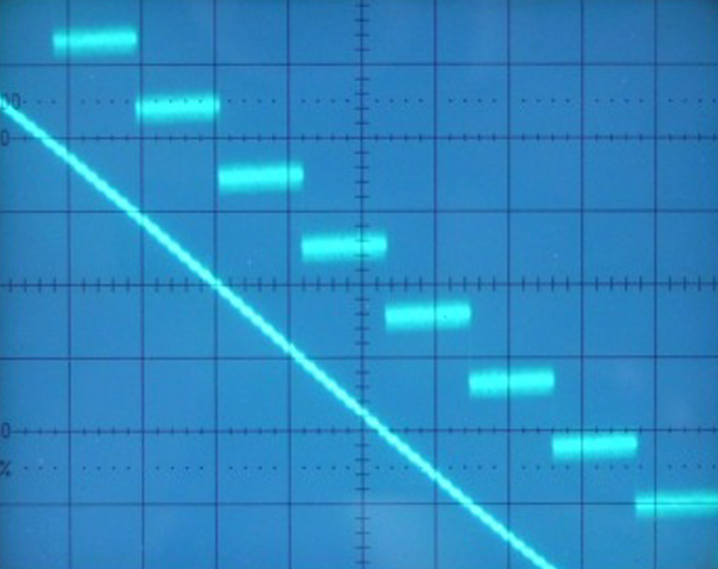

Very simple proof that it is tue what I posted in post #404
1 DAC carries current of new sample & 7 DACs carry current of previous sample -> 2 DACs carry current of new sample & 6 DACs carry current of previous sample -> 3 DACs carry current of new sample & 5 DACs carry current of previous sample -> 4 DACs carry current of new sample & 4 DACs carry current of previous sample -> 5 DACs carry current of new sample & 3 DACs carry current of previous sample -> 6 DACs carry current of new sample & 2 DACs carry current of previous sample -> 7 DACs carry current of new sample & 1 DAC carries current of previous sample -> 8 DACs carry current of new sample & 0 DACs carry current of previous sample -> starts next original sample...
Blown up pics of what EC posted.
Clearly one non-os step is transformed to eight steps.
This is only possible if after first DAC "0", all DACs "n" are delayed by n/8 sampling period with n = 1 to 7

EC, look closely at your own diagram from post 420. The series of short arcs run end to end. Yes the sample remains for the entire sample time but the effect of linear interpolation is to create a composite dac that runs 8 times faster. The sample time for the composite dac is 2.84 us or 8 cycles. You have to look at it as a single dac.
