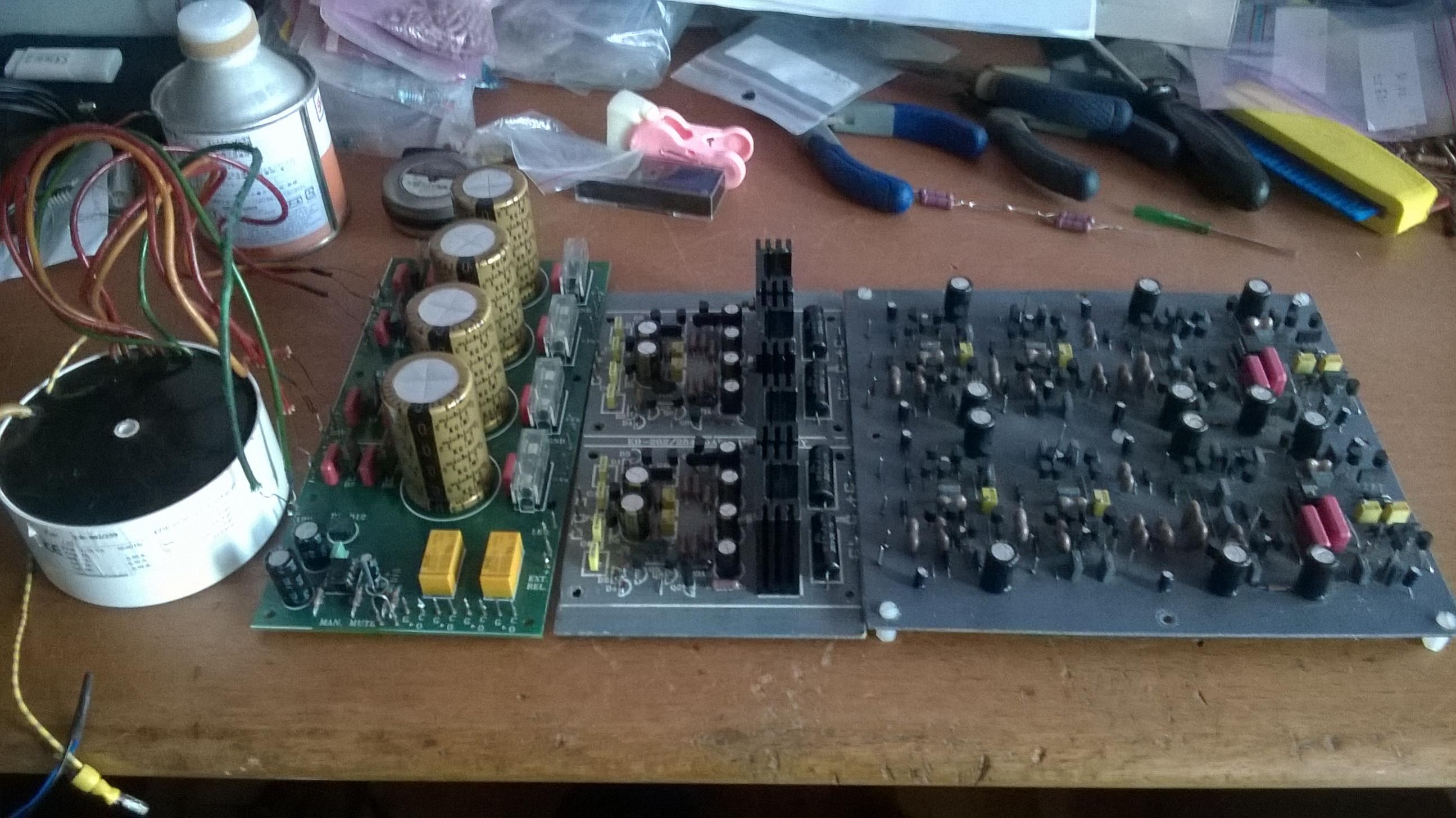

As I/V I used Erno Borbely stuff:
EB-201/214/DAC13 ALL FET I/V CONVERTER & FILTER FOR DACS
(Teflon PCB, Black Gates, Caddock, Welwyn RC55)
EB202/254 ALL FET DUAL LOW-NOISE REGULATOR 5uV NOISE
(Teflon PCB, Panasonic FM & FC, Dale RN60)
EB-1198/309 PSU
(4 Nichicon KG Gold Tune 10.000uF 35V, delay)
EB-802/259 TOROIDAL POWER TRANSFORMER
Prim I 50VA 115V
Prim II 115V
Sec I 0,50A 22V-0-22V
Sec II 0,50A 22V-0-22V
Sec III 0,50A 0-12V
EB-1198/309 PSU
Prim I 50VA 115V
Prim II 115V
Sec III 0,50A 0-12V
No.Thanks, do you compared the sounds quality vs PMD100 or DF1704 or others?
Tried to search for the schematics of this but failed - borbelyaudio.com seems not to be responding. If its using passive I/V then the DAC power supply becomes extremely critical. These days I don't recommend passive I/V for this reason.
