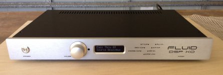

This is my version of it in a custom made chassis.

Hi Fluid
Your cabinet work is beautiful! On quick inspection, it appears that the analogue outputs are RCA only and I would prefer balanced, to accommodate the Yamaha P2200 driving the Plannar tweeters, and Crest CA-18, driving 18 inch RCF bass cabinets. The Saffire seems more of a recording studio tool at first glance but I will investigate further, thanks.

Thanks, it came out very nice. Yes the Najda has single ended output. I use it with balanced Hypex amps and use single ended to balanced cables (very easy to make). This works really well and still achieves 40dB of common mode noise rejection. The balanced input is the most important part and you already have that. The main benefits of a balanced output and input are the higher signal voltage level and increased noise immunity. Neither of these are necessary in a home setup. The Najda can put out 6V over the RCA due to it's analogue volume chip that has 15dB of boost, although I would be surprised if you ever need more than 1 to 1.5V. With mine set at 1.5V even with 15dB of cut due to the EQ I am using I cannot tolerate the volume at 0dB for more than a few seconds.
