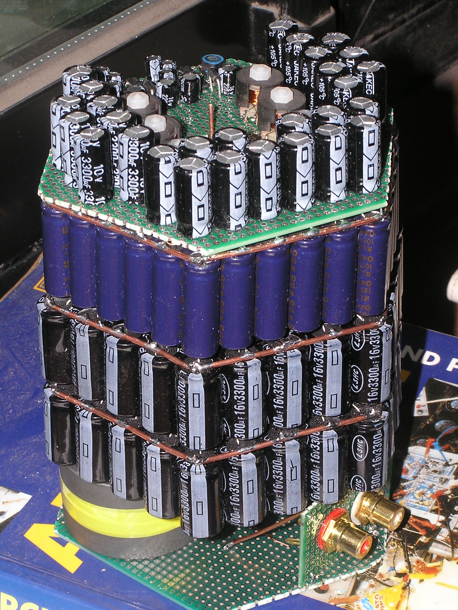

Thanks for sharing that pic, an excellent example of sucky power supply layout. Look at the distance between those 3-term regs and the opamps they feed.😕

Since I noticed adding lots more capacitance (I'm up to 105,000uF now) makes a difference to the bass, I don't much care where I stick the extra caps. At LF, series inductance is having a negligible effect on the supply impedance so caps can be a bit remote from the chips they're decoupling.Each TDA1387 chip seems to have a 100nF cap on its 4/5 pins, under the PCB and still on mine, +5v supply, again something to be gained like the use of BG without such 100nF at each chip supply pins? That was done in the hot days of CDPs...
