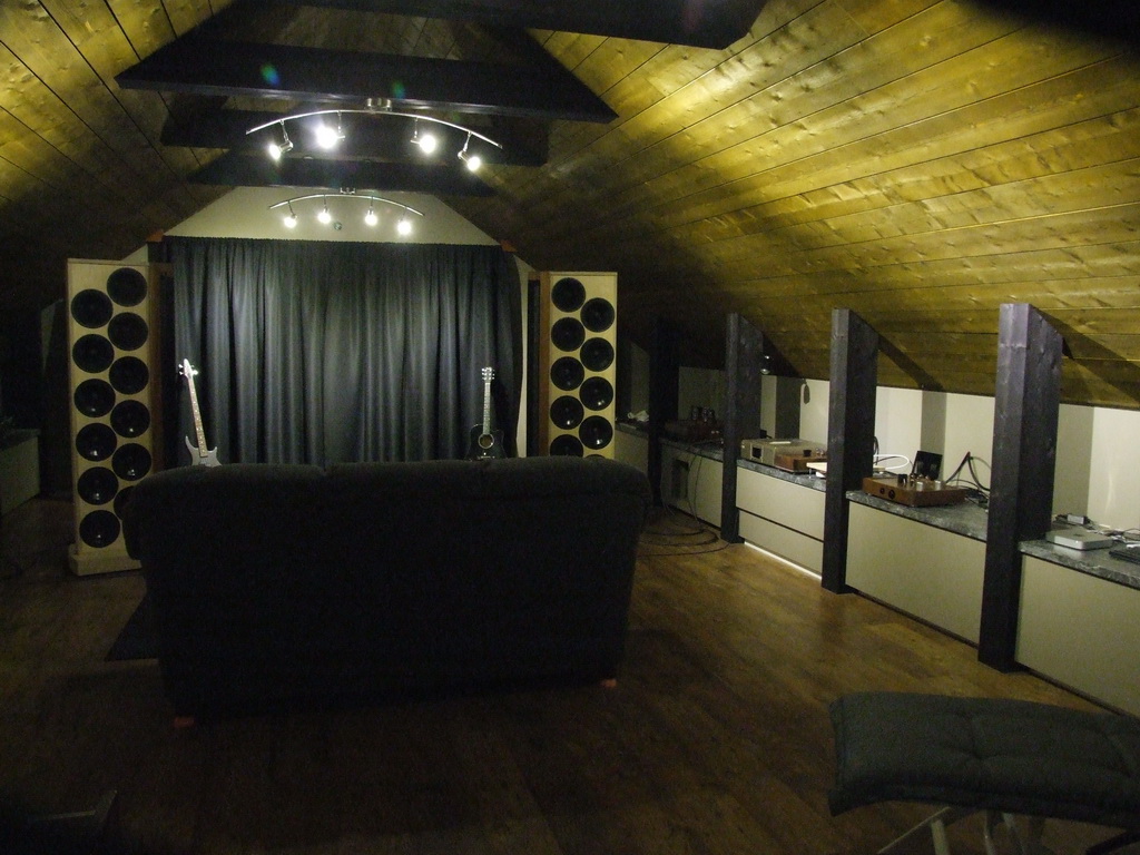

This is where I'm planning on spending the holidays doing dsp
configurations, twelve days to christmas 😱 😎

That's a really nice Men Cave!!!!!!!!
Are there Bunny girls behind the curtain?????😀😀😀😀😀😀

Hope not, the wife wouldn't like it 😱
