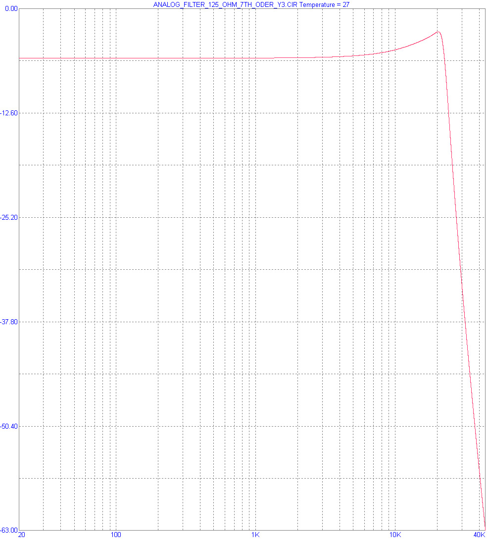

Quote:
Originally posted by Vadim
Even accounting for the �zero-order-hold� of the D/A, which is a low-pass filter in the shape of a sin(x)/x or sinc function, contributing a few dB of attenuation, still the anti-aliasing low-pass filter will have to be of a huge order, completely impractical, in fact not doable.
Vadim, I totally agree with you, non os needs a proper reconstruction filter.
This is what I use: 60dB/oct. & includes anti sin(x)/x, not trivial but doable...
Click the image to open in full size.

LE: Even a filter like the one above that looks good (and hard to make), has only a -30dB attenuation at 30kHz - well into the image field. Thats' not even close of the -96dB that are easily obtainable with a 8x OS and simpler filters.
