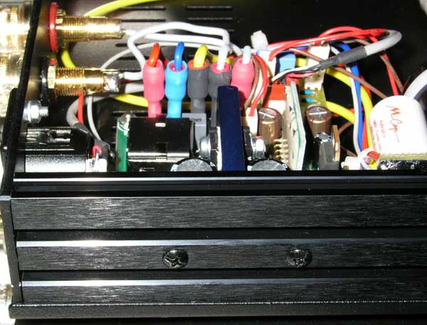

Very very nice.
How did you fix the "T in blue" to the chassis?.

With 2 black flat M3 bolts.
