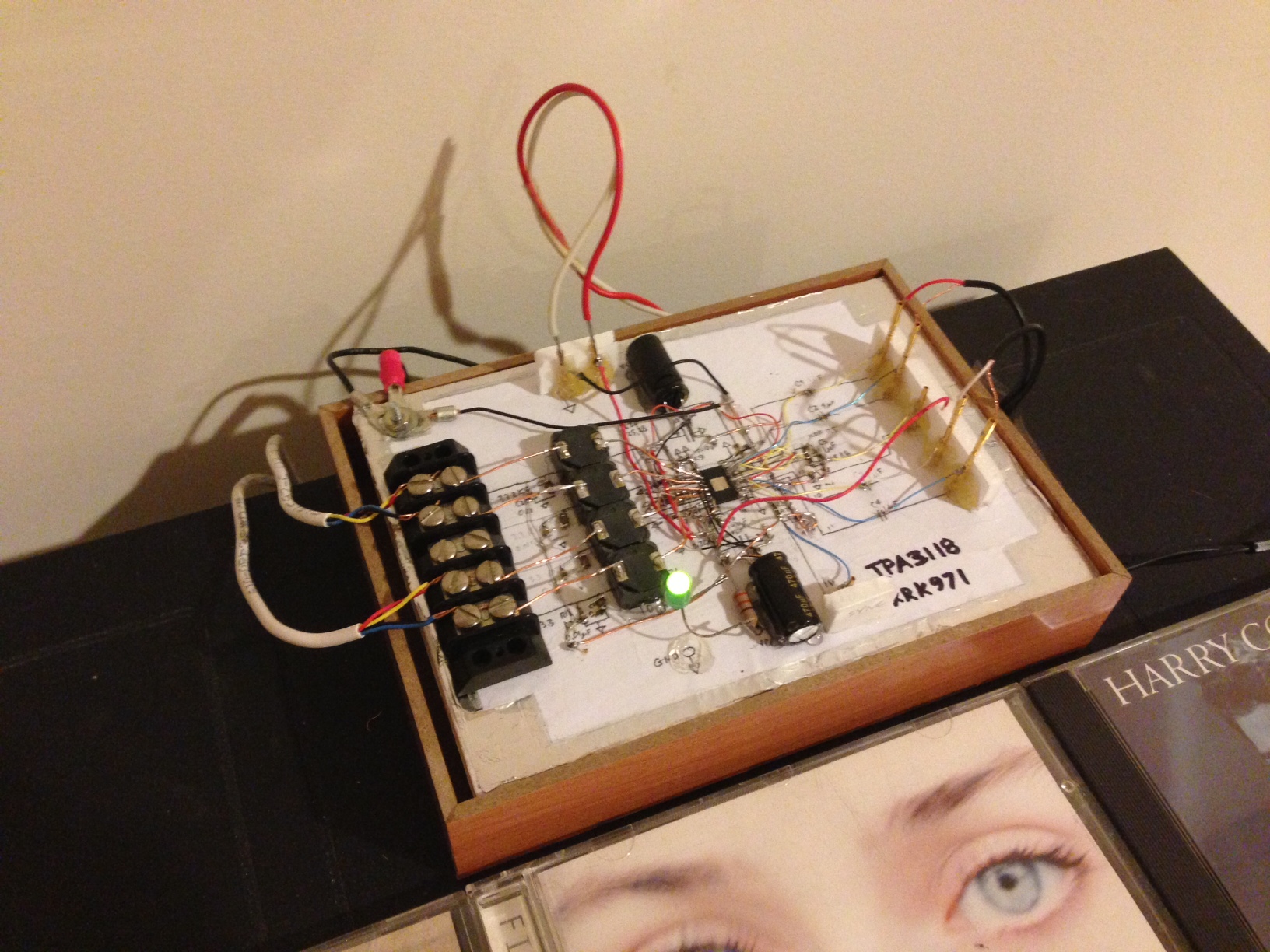

You guys are poo poo'ing this big thru hole board based on the fact that the traces are long and components are big. I am not so sure it makes a big difference. Have you actually heard what this board sounds like before relegating it to the dustheaps of poor sounding designs? I only say this because if you recall I was one of the first to build a tpa3118d2 dead bug style with point to point wiring. I used small SMT components but it was far from an ideal layout and it sounded great. I think it is important to keep the leads between the chip and the inductor as short as possible and keep the power supply bypass caps as close to the chip as possible. But I am not sure if there is detectable effect on SQ if they are a little longer. I would reserve judgement until someone buys one and tests it and listens to it.
Here is the dead bug amp
xrk,
Thank you for bringing this up. After I made my last post, I recalled your creation (the dead bug) which has a lot of long leads, and I did not recall you complained.
By the way, does anyone know which website sells this "big" board?

I understand as I usually don't like to prejudge.
Unfortunately with this board there are too many things done wrong that I can't really find a single reason for this board sound better than the other designs.
But I am just a newbie and maybe I am missing something in between the lines...
Please, point out atleast one reason for this board to sound better than the other TPA3116 designs ?
