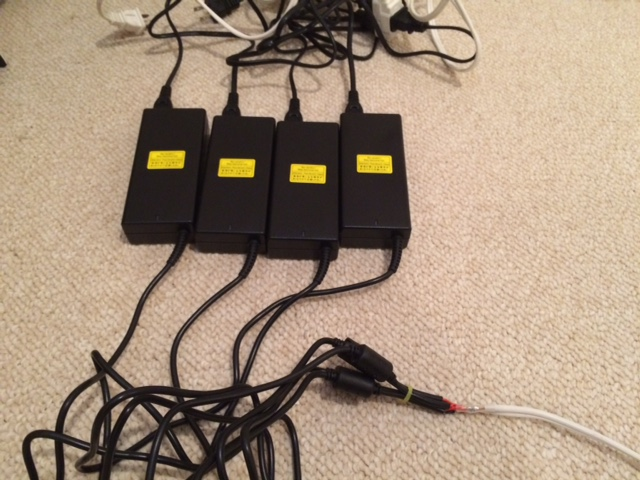

I have been meaning to test my theory of whether or not these laptop bricks if identical can be paralleled for more current. I actually started a thread on this a long time ago and there was no agreement. People just said test it and see if it works. If four $6 bricks can get me 19v at 18 amps - that is really something. Maybe just adding some big fat caps at the common junction to help filter out any psu-psu interactions might work.
Where this gets interesting is taking two sets of the high current SMPS parallel supplies and tying them together with a common tap for +/- 19v dual rail low cost supply for an IRS2091 switching MOSFET class D amp. Or even a 3386 class AB chip amp and forgo the huge and expensive toroid transformer and caps which are a substantial cost of these dual rail amps. Hey, you could even use it as a dual rail for a fancy class A. Nelson Pass uses SMPS for his ACA class A amp.
In order to do a center tap, you need to get a SMPS that is not earth grounded - two prong variety so output can float. The Vaio ones I linked above are two prong and can work. I may have to try this soon.
Paralleling a PS means that they should be able to share the current evenly. This means that they have to be the exact same output voltage for this sharing to happen efficiently with equal distribution. Easier said than done in practice. So once you have that figured out, you can proceed with caution. It is not a simple matter as just connecting them all up together.
As a safety measure you can diode isolate each PS using a low drop diode = schottky on each output that connects using a diode "OR" wiring arrangement. Of course adding the diode creates another v drop that has to compensated for.
Usually if you want to parallel supplies you want them all to share the same voltage reference, that way they are able to track since they all have the same reference. Then the feedback elements of the error amp also have to be corrected for, but that can be done using a calibration procedure.

Should I use a 500w halogen light bulb as a test load? I don't actually have an amp that can draw 18amps at 19v. Then what am I checking for? Voltage sag or how well each SMPS tracks? Or do I need 4 shunt resistors to track individual current from each SMPS? I have a 10ch divital strip chart recorder. Getting the feedback taps for each would be tricky. Need to dis assemble the units and know the schematic and break off the feedback trace.

A incandescent lamp is not the best test load to use due to its characteristics, draws very high initial current, which can trip over current logic. If that is all you have, well it will have to do. Measure the cold filament, preferably using a "Kelvin" connected ohmmeter (4-wire), to see what the initial current draw would be. If not measure the lead loss and compensate for it.
"Or do I need 4 shunt resistors to track individual current from each SMPS?"
This is a good idea, so can you measure each V drop across each shunt and adjust each PS o/p V, so that the PS voltages balance out, thus it will allow for similar I draw from each. Can be a bit interactive to adjust because assumption is each PS has the same load regulation, which will not be the case 100%. What is important is that the V balancing takes place at the maximum load current, which is the goal.

I ended up using a portable cook top as the resistive load. I wired all four SMPS in parallel and turned them on one by one. The voltmeter read 19.71 volts for any single SMPS alone or in parallel. With the hot plate turned on, the voltage dropped to 19.68 volts and the plate got warm. Nothing switched off and nothing blew up. I will have to figure out a way to see how many watts are delivered. Maybe heat water and measure temperature rise. If this works, we have a low cost ($24) 18 amp 19v power supply with lots of potential - maybe bass transients on TPA3116D2 in PBTL 2ohms will be better?
Here are the supplies before the plug got snipped off:
Here are the supplies soldered to a single parallel connection (a 120 v lamp cord):
The next thing I want to try is a +/- 19v dual rail supply with 9A capability. Could be useful for a chip amp or IRS2902.
