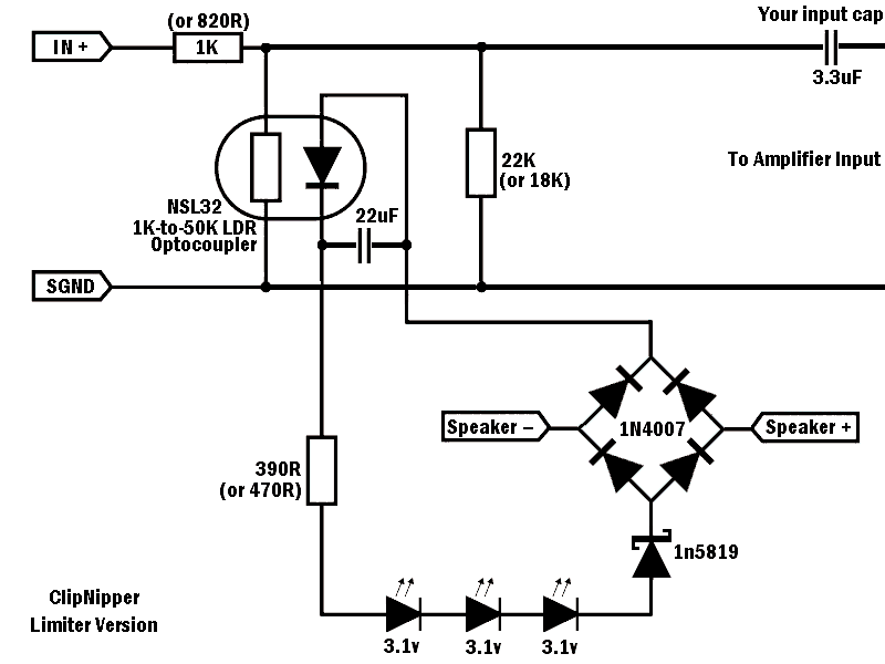

ClipNipper is a simple passive on-demand (doesn't activate until needed) compressor (booster like the Volumax) that doesn't consume your battery power and it doesn't reduce useful output power, but what you get is a headroom boost. This device mitigates/reduces clipping but it will not block everything and thus it doesn't reduce your bass. It will mimic the headroom advantage of a good tube amp.
This schematic is currently up to date.

Input:
As shown in the schematic above, the location of this fixed divider and its function is just like an ordinary 20k volume control turned almost all the way up. . . except for momentary LDR activations that constrain clipping.
Series resistance at input is within the range of 330 ohms to 1K whereby the larger value allows more volume fluctuation--set this to personal taste. I like 820R. Some optional gain management documentation is at post 17.
Substitutions:
3.1v Led: The 20ma+ 3.1v LED can be a white, Warm White, Green, Blue, Pink, or Purple LED.
2v Led: The 20ma+ 2v led in red, yellow, amber, orange can be used as four leds series plus two ordinary diodes series like (4*2v=8v)+(2*0.7v=1.4v)=9.4v total forward voltage drop, but I didn't test that--see settings/tuning below.
Schottky: You can use almost any Schottky or fast diode you happen to have instead of the Schottky diodes in my schematics.
Rectifier: The bridge rectifier doesn't have to be made of 1n4007. A miniature prefabricated bridge rectifier would work nicely too--the ~~ AC marks are for the speaker jack, but the +- marks run the ClipNipper's LED's.

330 Ohms is still very low for the input resistor. There are 2 problems:
A) If the amp is driven from a source with a low output impedance, then very little attenuation is possible. With maximum current through the LED, the LDR resistance only drops to 1 K. That gives less than 3dB attenuation with a 330 Ohm series resistor.
B) When the limiter is active, the input impedance is very low. this makes it difficult for the source component to drive.
IMO, 4.7K would be more appropriate for the series resistor. That ensures that the input impedance is never less than 5K, and also allows a more useful control range for the limiter.
And, yes it does run half wave....
The problem with half wave detection is that some musical waveforms are unsymmetrical, with very different amplitudes for the positive and negative peaks.
If you sense only the positive peaks and the music has large negative peaks, then the amplifier may clip badly without your sensor noticing.

Turn my soft clipper limiter into a regular limiter? Okay.
Input Control:
1k input loss (more than that will make bad limiter pulsing noise)
22k input load parallel with the LDR's onboard CDS
During clipping this is a "more than half" voltage divider.
Substitutes:
820R input loss will decrease limiter pulsing noises and that is also acceptable for the soft clipper limiter at post 1.
Speaker output Sensor:
1N4007 Full Wave bridge rectifier.
Sensor is these (components in series just like LED's in series):
5.6v Zener, 3.1v LED, 470 ohm resistor, LDR's LED, 1n914
A 22uF cap is parallel to just the LDR's onboard LED.
Substitutes:
If 3.1v led and/or 5.6v zener aren't handy, you can substitute an equivalent amount of LEDs, Zeners or ordinary diodes that add up to the desired voltage drop(s).
Advantages of this version: Better quality treble. More protective. It doesn't "miss" You are correct.
Disadvantages of this version: Somewhat less bass, and it "sounds like a limiter" as in less transparent.
The disadvantages were expected, but I minimized them.
Advantages of both versions: A noise reducer that is powered only by noise. No added standby consumption. BlareBuster compatible. You can play a tiny amplifier louder than heck without clipping noise.
P.S.
This amp TA2020 20W Class-T Digital Audio Amp wasn't as cheap as I thought since it does contain the 8 protection diodes on the bottom, it does contain the four upgraded inductors at the output, and it has a 3A schottky series to the power so as to seriously drop voltage during overcurrent condition. A Low ESR capacitor upgrade is useful for it. But, if it wasn't for harsh operating conditions in an old, yet solar powered RV, I would be using a different amplifier.
Thanks!
Okay I re-did the Full Wave type sensor for a bit louder bass.
Full wave bridge rectifier at speaker jack running:
1n5819, 3.1v LED, 3.1v LED, 3.1v LED, 390 Ohm resistor, LDR's LED
22uF cap paralleled directly to only the LDR's LED.
The ~3.1v led are InGan White or warm white LED that stumble across their knee voltage (better bass than the fast attack of zener). You'll get quite the light show. The resistor drain can be 390R to 470R. You can add more or less 1n5819 (schottky) to fine tune.

Thank you for the schematic. I have revised it. See the attachments.
Input:
We need an input load resistor because the 1k to 50k LDR optocoupler could (varies) go nearly open circuit when off.
Sensor:
We need to set the sensor's voltage range suited to TA2020, TA2024,
We need to do without a ground tap for sensor (bridge amp doesn't have an output ground),
We need to set the sensor so that the amplifier plays louder and still clean (unusual for a limiter)
Noises:
We need to reduce the effectiveness of the limiter enough to remove obvious pulsing noises,
We need to reduce the effectiveness of the limiter enough so that we don't require high gain/preamplifier noise.
Frequency Response:
We need to use LED and Schottky voltage drops because their sloppy knee voltage region will make a more transparent rendering and LOUDER BASS than abrupt zener.
Please check the attached schematics for polarity. I did test these actual components with the real amp. A 3.1v LED is an ordinary white or warmwhite LED ("on" voltage varies by current). You can fine tune voltage drop to match your amp by either subtracting 1 schottky diode or adding more schottky/fast silicon diodes.
