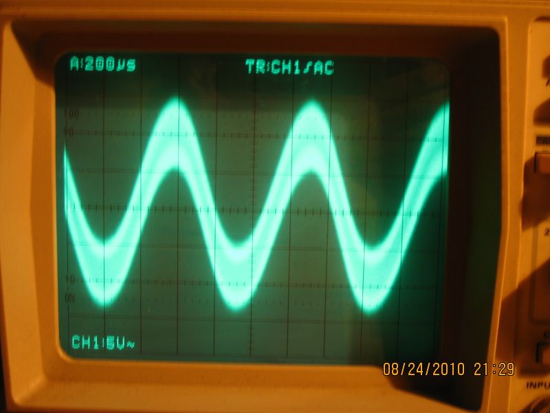

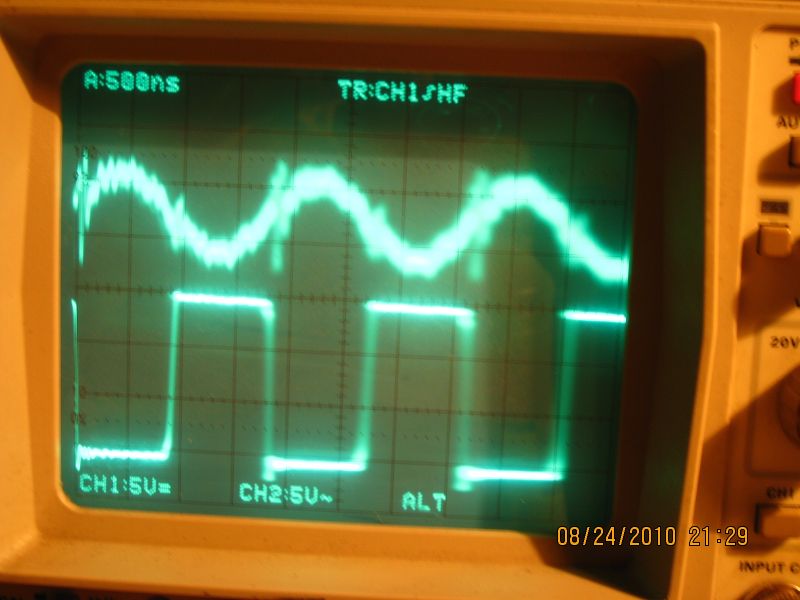

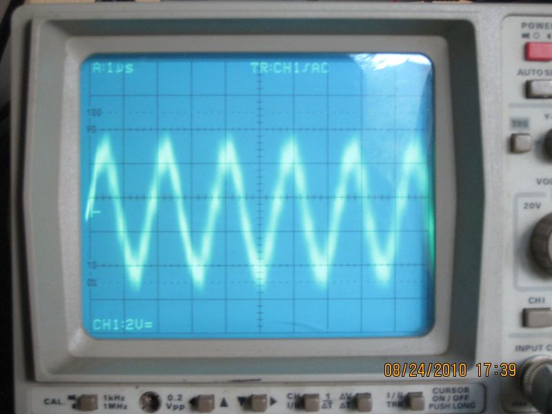

Hi

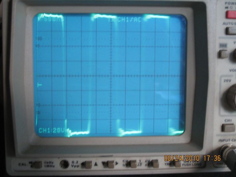

I got an Audio Research 300.2 amplifier faulty after a big electric shock (lightning).
It did'nt started so I changed the 4 output Fets (cc) and the Tripath TA0105A.
The amplifer starts, but there's is a big HF noise on the output terminals.
When a signal is applied, at mid volume, the signal begin to pump very quickly and the amplifier goes into protection.
All the power supplies are ok. All the diodes and little fet's have been tested and are ok. I did'nt seen any other part burnt.
Can you help ?
Here is a picture of the signal just before the RC output filter : (160 Volts PP, 500nS timebase)
Click the image to open in full size.
A picture of the noise : (8 volts pp)
An other picture of the noise : (timebase 1µS)

Old 24th August 2010, 06:54 PM   #2
mitch90 is offline mitch90  Canada
diyAudio Member
Join Date: Sep 2005
Hello tatchoune.
Check your LC output filter, both capacitor and coil.
MITCH.

The signal forms are exactly the same on the left and right channel... I do not understand.
I supposed too it was the fault of the rc filter; when I install a 0.22 uF in parallel with the original, the noise decreases !
Could someone post a picture of the residual noise on the speakers terminals with no signal at the inputs ?

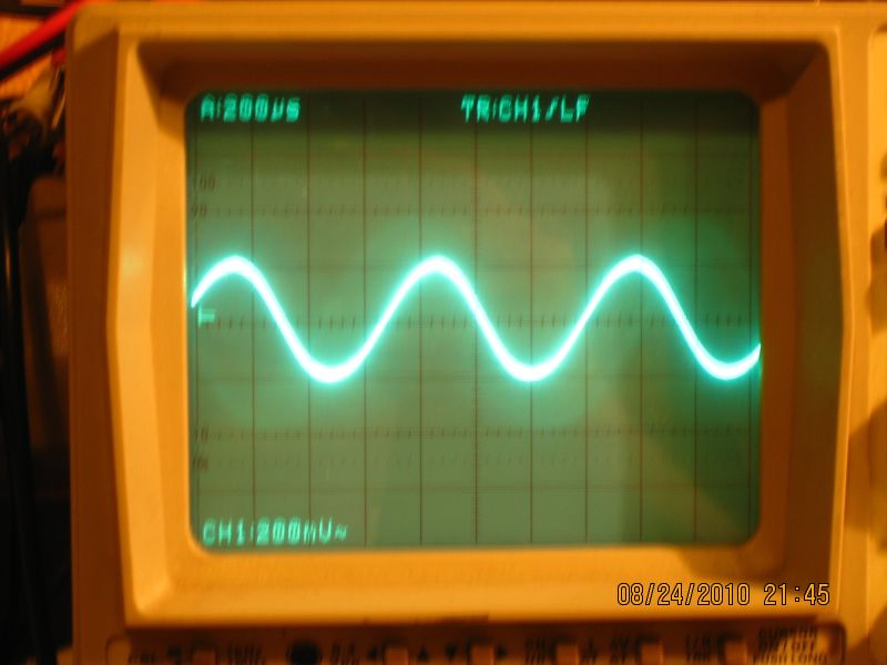

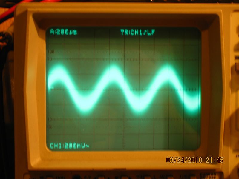

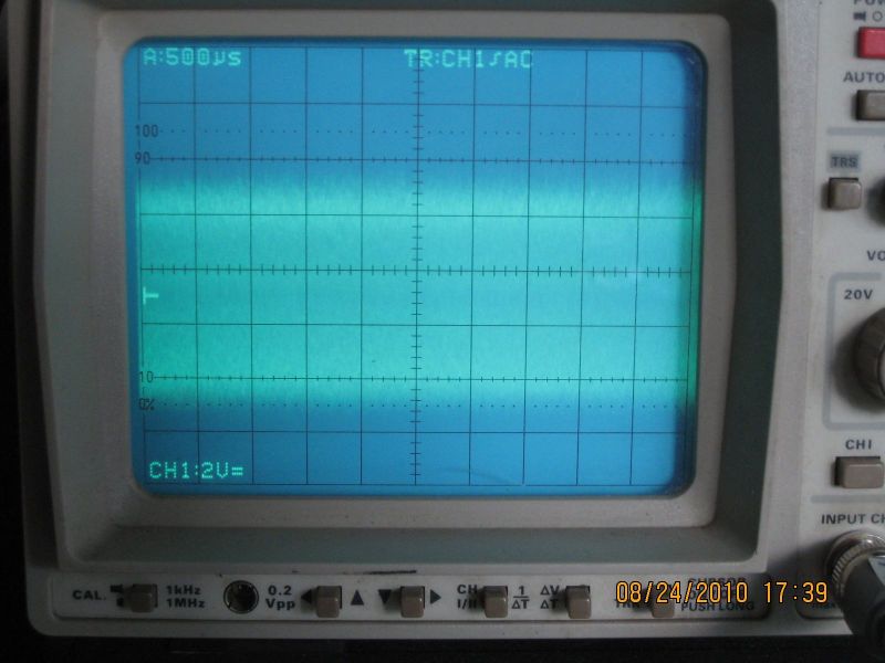

Old 24th August 2010, 07:35 PM   #4
diyAudio Member
tatchoune's Avatar
Join Date: Oct 2007
Location: Far from the sea
This pictures shows that the residual noise on the speakers terminals is surely coming from the FETs output, I suppose the RC filter is defect ?
But look at a 1000 hz signal .... how it's bad !
And worse than that, look at the 1000 hz signal on the input (amplifier power off)
And now, the same when the amplifier is on :

Old 25th August 2010, 04:24 PM   #5
diyAudio Member
Join Date: Sep 2005
Hello again.
I have noticed that there is quite a bit of ringing on the bottom MOSFET.
Do output transistors get hot without load?
MITCH.
