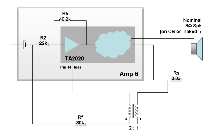

Amp 6 with current feedback
This is what I did last weekend.
Prototype of Amp 6 kit with transformer-coupled current feedback:
Simplified circuit:
Initial crude trial:
TBH, I was fiddling with it with no clue how it would work. 😱 ....
Speakers under test are a pair of 8" wide-rangers. Just to test the basic function of the system only, since I don't know how it sounds when playing fullrange (I used it as a midrange after I cut the whizzer....). They were put on the box and basically playing naked.
At first I tried the amp without the external feedback loop. Dipole loss was compensated by the upstream digital EQ, which was quite a lot as expected.
Then I added the current feedback to raise the output impedance. I don't know if I did it right, just gave it a try. This is what I think:
Assumed in a case the output current is 1A into 8 Ohm, then it's 8V across.
Now I add a resistor of 0.33 Ohm in series with load, then there'd be 0.33 V across this resistor under 1A.
The 0.33 V is then stepped up to 0.66 V by the transformer and feed in the negative input. The amp has a voltage gain of 12, so the -0.66 V is amplified to a -7.92 V at the output....
Now the strange part, previously there should be 8V on the output. Now it's eaten up by 7.92V, so only 0.08V is left... The voltage on the output is now only 1% of the original, so may I say the output impedance is 100 times of the load? (800 Ohm!!) Hmmm... doesn't look right.... 😕
And I don't know what the 50k Rf would do to the circuit, it's there to be a 'buffer' - I don't want the input to see the low impedance of the transformer and it's reflected other side. I have no clue how it interacts to the amp. 😱 I guess there should be some voltage divisions happening here, but don't know how to calculate. I have a feeling that I'm kind of an ape playing human's stuff.
Question is how it worked.
At the first trial with normal Amp6 and massive EQ, to my surprise, the poor little naked 8" wide rangers were singing quite nicely. In my living room of appox. 50m^2 (& low ceiling), overall tonal balance was OK. Severe beaming is for sure, but acceptable balance could be obtained when off axis by a little angle and overall room response was also acceptable.
Because of the massive bass EQ lift in the digital domain ate up the dynamic range of the processor, so it clipped easily. I had to attenuate it quite a lot, eventually used up the -15dB range of DEQ2496. At this stage, this system produced an SPL similar to loud indoor quarrels -- I had to talk quite a lot louder then normal to fight against it. Pop music was actually quite enjoyable with good balance and dynamics. (I never know a pair of naked 8"ers can do this!)
Then the modded amp with current feedback. As mentioned I don't know how much the feedback actually is, and it did play much quieter in the midband (compared at the same volume setting of course). So at least the negative feedback did work (in a way I don't really understand). Good thing was it also needed much less bass EQ (as the goal), so the overall shelfing was shallower by 10dB or so. Higher output level at the source, lower gain at the amp, in the end they cancelled out and played to almost equal loudness and in similar balance.
I won't go into the sound quality review of this mockup, but the one with current feedback (higher Zo) didn't sound tubey at all (to me, at least). TBH, 2 setups sounded almost identical after properly EQ'ed. (It's odd and fun to see 2 naked 8"ers playing bass heavy materials with their little busy cones jumping around. The excursion might hit 4~5mm one way in my eyes.)
In a more thorough and proper setup, they should be somewhat different because of different degree of EQ. I tend to like the high Zo approach for dipole speakers and I'll try more with this little thing in my main system.
Hi Circuitsoft,
I feel somewhat pity that it seems nobody else is interested in adding output impedance to any amp. Please go try your idea, and let us (or only me) know the results😀 I think there's no reason why a feedback loop mod can't be applied to a class D amp (or any amps). Class D is still holding its own good, we just 'adjust' it a little to suit our application, nothing wrong.
About my little trial, I'm sorry to say I haven't tried your suggestion. Maybe they'll come to a same result in the end, but fiddling with the original feedback loop kind of scares me off.
I did re-adjust the resistors in my proto-type, though. First I raised the voltage gain by increasing the original feedback resistor (R5) to 40.2K, thus raised the gain from 12 to 12* (40.2/22) = 21.9
Then I figured that the added (current) feedback should probably be divided by Rf and R2. So, re-calculate the feedback of the current content would be:
Assumed: 8 V / 1 A pass through Rs => 0.33 V across
stepped up to 0.66 V on Rf, then divided by 22/(22+30) => 0.28 V on input
V (of current Fb) = 0.28 * (-21.9) = - 6.11 V
Zo : Rload = 6.11 : (8-6.11)
Zo = 6.11 / 1.88 * 8 = 26 Ohm
Now this looks more like it. No?
