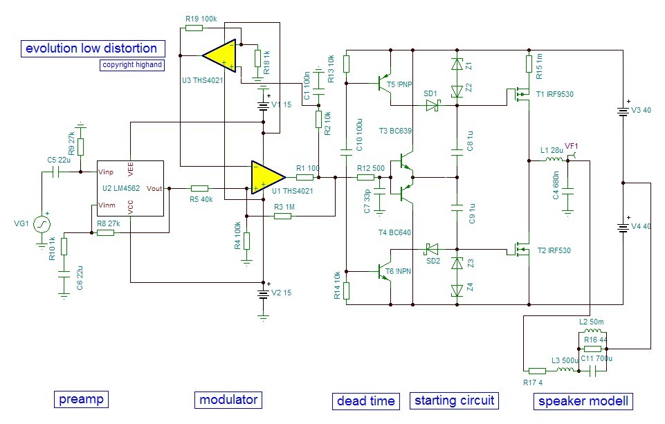

Quote:
Originally Posted by highand View Post
Just for the record, since few of them here can understand hungarian. (Highand I reccomend you to post a google translated link of the HE forum, so others can see the discussion),
I (and others) doubt the performance characteristics of this amp, as stated by Highand.
It has lot of issues, for example but not all:
- P channel FETs have bad diode, high Coss realteive to their high Rdson, due to material science reason (hole conductivity vs. electron cundictivity). They won't be so much beter, however N channel FETs have improved gradually, and they are still improveing.
Although Highand stated that schematic can be modified to all N-channel, then It looses all the pros Highand state.
Even though Highand stated, and simulations show that diode recovery lossses are decreased, I state that they are still higher than using modern all N-channel FETs. (also the zeners applied to to this "trick", dissipate much, so total some of dissipiation is not decreased so IMHO).
- lack of feedback gives absolutely no control about the output LC filter, it does not supress distortions in the half bridge (they exists and they are not neglictable, just see an IRF Class-D application note), and also does not suppress power rails variations.
Since Class-D gain is dependent on supply voltage, any ripple the supply has, or any decrease the supply has at high output pulses, it will show on the output.
- In a normal Class-D amp designers all do everything to make the amp produce as high and as low duty cycles as it is possible, to make as much ourput as possible from the same supply and the same votlage rating FETs, before the modulation error kicks in. Higher votlage rating FETs are always worse, or more expensive (if they have the same good specs). In this design the duty cycle must be limited due to the applied gate driving network. This is not a trick, this is absolutely bad design goal IMHO.
These and other issues are discussied in the Hungarian forum.
