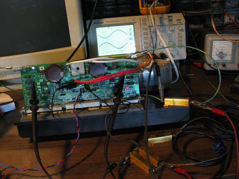

Default 3886 design that laughs at 2 ohms
The 3886 can handle 2 ohm loads, you just need to parallel them. At the bottom is a pic of a design I have been messing around with for awhile. It is bridged and paralleled with 4 devices on the + output and 4 devices on the - / inverted output to create the bridge.
In this pic the amp is putting 30v p-p across 2 ohms. If I push it much harder, the amp starts clipping because the PS is sagging so much.
Right after I snapped this pic I put a 8 ohm speaker in paralleled with the 2 ohm dummy load and cranked up the music. Sounded great!
To deal with the sharing issues that come with paralleling devices, I put each device under servo control (half of the parts on the board are for the servos) to take the output offset down to almost 0 and then had each device feed a .1 ohm ballast resistor.
So for you 2 ohmers out there, don't despair, it can be done.
