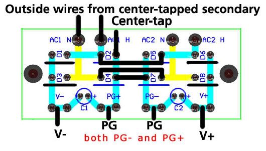

well, is this the only way for wiring a center-tapped transformer?
if so, i'm a bit confused. where to go PG+ and PG- holes on the amplifier board? should i connect both PG+/- holes to the PG? or may i wire them like this? thanks.
NO! I have built several GC power supplies using center tapped transformers. Let's call the three secondary leads from the transformer AC1, CT and AC2. Let's call the four connections on the dual bridge power supply AC1H, AC1N, AC2H and AC2N.
I wire AC1 to the AC1H connection in the PS. Then wire the CT to both AC1N and AC2H. Wire the AC2 tap from the transformer to AC2N.
Doing it that way you can use a CT transformer in a dual bridge power supply. The image shows an example with the BrianGT boards.
Sherman, thanks to schematic, i'll do it that way but i have a question;
AC1 and AC2 (from the transformer) are our hot wires, aren't they? why we don't wire AC1 to AC1H, AC2 to AC2H and then CT to both AC1N and AC2N?
