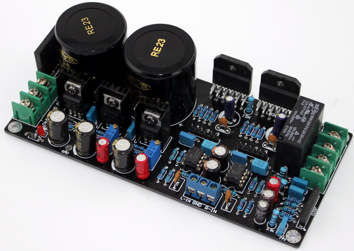

Has anyone tried one of these Chinese amps from Aliexpress? I figured I would give the LM3886 a try with this $40 entry. This one has an OPA2604 and speaker protection relay.
Wholesale Product Snapshot Product name is YJ LM3886+OPA2604 68W+68W Amplifier completed board + sound effect +Speaker protect

You may want to consider this from an American seller. Yuan-Jing has a good track record but I have never tried this board. I have built both the 3875 and 3886 amp and with my system the 3875 sounds better.

Thanks for the tip. The one I ordered uses a different op amp and has a relay for speaker pop protection. I ordered it already so just a matter of time before trying it.

The amp arrived today, looks well made. It has a couple of Burr Brown op amps on the front end. I was thinking of powering it with two 19v SMPS laptop bricks - will that work to just try out, albeit not at max power capability?
There appears to be a 3-position jumper in front of the chip amps, I wonder if that is used to set the gain via resistor network?
LM3886 Works Great with Dual 19v SMPS
I just hooked up a pair of $6 19v 4.65amp SMPS laptop bricks in series for a +/-19v dual rail supply. I had an old massive Pentium solid copper CPU heatsink lying around so drill & tap a couple of 8-32 threaded holes and screwed the chips on tight. Hooked it up to my full range PA130-8 drivers mounted in a Karlsonator. Listening to some Miles Davis right now. Sounds great! The speaker protection relay works - no popping. I think this is a great buy at $40. Skipping the big iron toroidal 24v trafo ($60) is a nice bonus. I think I have plenty of power with the two 19v bricks. 😀
Subjectively, this amp sounds very nice. 🙂
