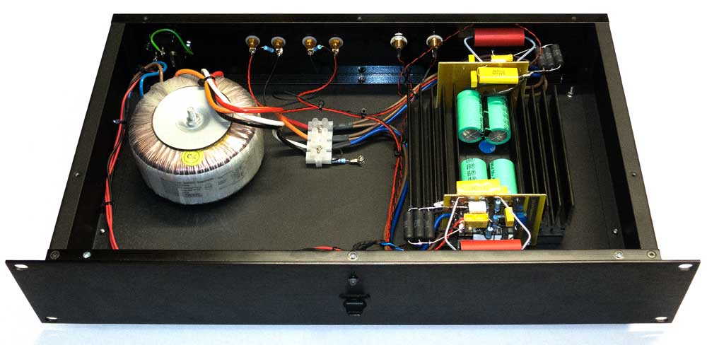

I built similar amp but with shorted R4 and R7 0.33 Ohm,
the resistance of my speeakers is 5.4 Ohm.
The sound quality is extraordinary, indeed like good tube amp, detailed and velvetlike trebles, etc.
The speakers are a little boomy but this not annoys me, it is acceptable.
The amp is mounted inside dead Philips F4220 from which I used power supply and input path.
I have large offset at the output (+350mV) and I am going to use 10k pot from negative rail to inverting input to cancel the offset.
I use 7824/7924 regulators decoupled with 470uF/63V Panasonic FC.
Probably soon I will post the pictures.
I tried to listen to the music very loud but the meters of power indicators in the front of the amp were far away bellow 1W!!!
clipping
after mounting inside the enclosure
I can listen only left channel.
When I turn the balance pot max on the left the music is clear and beauty only in left channel.
When I try to put balance pot in the middle both channels are overdriven and clip😱
oscillations???:bomb:

fixed!
the issue solved!
now every amp chip has independent supply (what took only 2XL7824 and 2XL7924C stabilisers for 2XTDA2050) terminated with 470u/100V Muse KZ caps and within burning in process the sound is better and better in every minute.
There is not aggresive sign even with louder levels!

offset...
During the work I burned one TDA2050
and now left channel works with 2050
and the right with LM1875.
For TDA2050 I have the offset 146mV, for LM1875 47mV.
Attached is the schematic with V4 voltage source which is injecting DC voltage to null the offset.
Please propose a precision circuit which could help eliminating the offset in practice, the trick with connecting inverting input to negative rail via 10k potentiometer does not work with those chips...
if the inputs to a tda2050 is a pair of BJT transistors, then the usual rules apply.
The inputs should be sufficiently well matched such that arranging the same resistance for each to the reference voltage SHOULD get a lowish output offset.
Then trimming of one or other resistance can adjust the offset to zero.
Hi
thank you for the respone.
I changed 2050 into 1875 into left channel and the offset was +40mV in both of the channels.
Then I loaded the input resistance R2 of the nonirventing input from 100k to 13k and the offset is now -8mV for the left and -5mV for the right channel.
I guess that ~20k is the value for 1875's to keep the offset closest to zero.
But for me the offset like now is acceptable.
Maybe I will experiment with the input loading in the future?...
Now I have great sounding amp in nice enclosure with power level indicators!!!
After cranking up the volume it not screams, there is only "more of the the music"!
