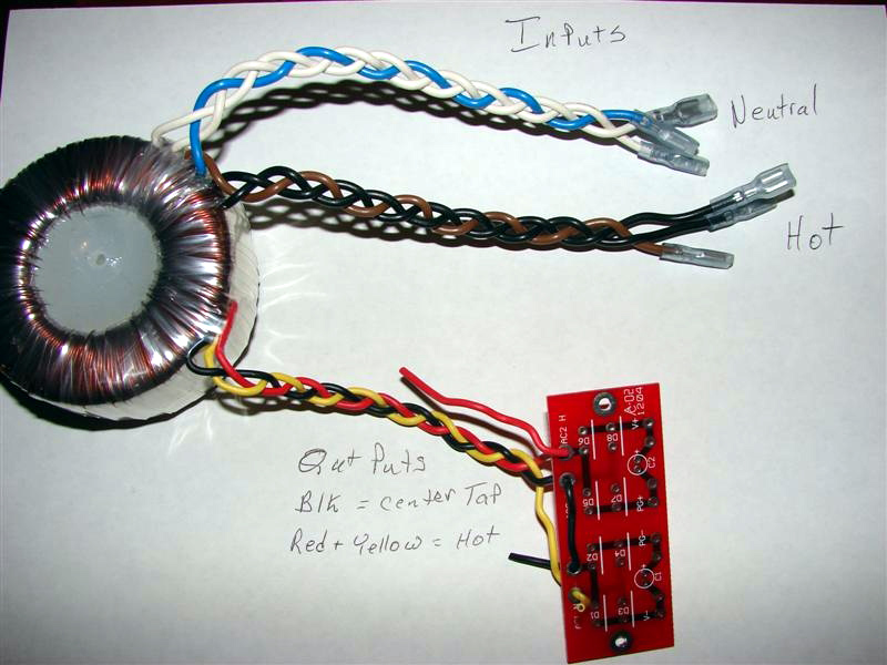

Is it just me or is this pic at Apexjr showing how to hook a center-tapped transformer up to a BrianGT power supply board dangerously wrong?:
Click the image to open in full size.
(on the page http://www.apexjr.com/miscellaneous.html )
those instructions seem OK until PG+ and PG- are joined together somewhere on the amp board, and then the transformer is being shorted for half the cycle as the output from Yellow to Red is being dropped directly through two of the diodes...
It will seem to 'work', as in the output voltages will seem correct, but the transformer will be buzzing like Hell... until something melts...

No it's fine. It is not the transformer that gets shorted, it's the lower two diodes in the top bridge and upper two diodes in the bottom bridge, thereby making them redundant.

Uhhh.... no. You *can* use this board with a center tapped transformer, but *not* the way it's illustrated. Ie, the proper way to do it would eliminate four diodes, jumper the connections into a single bridge, and tie the CT, PG+ and PG- together.
The way it's illustrated in the pic will cause either the transformer to catch on fire, a diode to blow up or the fuse/breaker to blow.
[edit: had an extra BrianGT rectifier board and CT transformer around. Wired it as displayed and sure enough, transformer buzzed, lights on workbench dimmed, then fuse blew when I alligator-clipped PG+ and PG- together. But, multimeter read 60v across +/- as 'expected'.]

Thank You Dave and Roddy for the heads up...
I've been selling toroids for the Brian Gt's boards and
Troystq ( Troy St Geramain) sent over the picture which
he used to hook up the boards...
Looks like I'll have to take it down...
