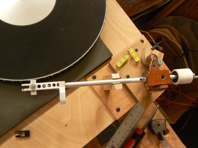

Having made the Nanook uni-pivot, I have sort of been enthused to start a small production line. I only have five TTs and will need a few arms for when I get numbers 6 and 7.
The one problem I had with the Nanook was feedback. Above a certain volume it just went out of control. Not sure why or if anyone else has had this problem.
Anyway, I was taking some old hard disks apart and the motors looked perfect for using as the horizontal bearing in a tonearm. There is absolutely no play and they are very free running.
I converted the uni-pivot into a 10" and have built a 12" as well.
Details to complete but given the sound with the 10" just resting on an old Garrard SP25, there is definitely some performance in these arms. I will make a suitable support for my Origin Live based TT and see what they are really capable of. There is only a Shure M75ED in the 10" so more to come in that direction too.

What a setup. You gotta say whoa.
<< The one problem I had with the Nanook was feedback. Above a certain volume it just went out of control. Not sure why... >>
It's an off chance, but it might not be feedback, it might be mechanical resonance. You might try changing the mass of something, or the length of something, or...something.
Or another off chance, it might be feedback from the speakers to the tone arm. The sound waves from the speakers being strong enough to vibrate the tone arm.

Thanks for the help. You are quite right. It is an arm resonance problem. I wrapped the arm tubes in plastic tape and the feedback has 'almost' disappeared. The volume has to be at insane levels to set it off however.
Now I've done that, the 10" arm sounds better than the 12" whereas before, it was the other way round. All strange stuff this. Having absolutely no technical knowledge and just bunging stuff together to see what works makes for a lot of fun
