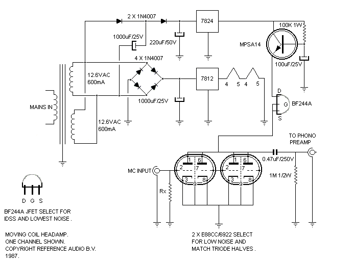

Found the diagram of the original design, in good old Tubepad:
As you can see from studying this pretty basic MC stage the design criteria are obvious:
No input cap, as low noise as possible, no inverting signal polarity and enough gain to match an existing MM phono stage.
In theory there are lower noise valves out there that could reduce the number of //ed triode to two. In theory.
The PS is dated and truth be told was designed to be as cheap as possible. I'm sure we can do better nowadays.
Forget the BF244A, it's obsolete as is it's successor the BF245A J-FET. No big deal, all you need to keep in mind for this particular circuit is the Idss of this device.

Further to the schematic as posted in post #2:
In order to be able to build this by everyone we need to solve a few minor problems.
First of, as mentioned above, the BF244A J-Fet that was used as a CCS is no longer available so we need a replacement that is easily available to everyone around the globe and if we can do better than the ole BF244 then I'm all ears.
Secondly, the heater supply could do with a better reg as well. But, which one and why? Again, I'm all ears.
Thirdly, the cap multiplier using the MPS14A (at least that one's still around) may well benefit from something more noble than a cheapo electrolytic cap. If so, then again I am all ears.
Once that's sorted I will propose a balanced version with a balun quite similar to John Broskie's circuit discussed here:

For those who recognize it, and I'm sure some will, don't panic. The requirements for a mic headamp and those for a MC headamp are quite similar.
For the moment I'll stick with the ubiquitous 6DJ8 as it's low enough in noise once //ed and has just enough gain not to overload a MM phono stage.
Although I wonder if going balanced won't up the gain too much after all....
Of course I won't leave well enough alone and add my own twist to the idea but basically I think I'll have the balun in a separate casing, using its own dedicated and regulated valved PS so it can be put close to an existing MM phono stage.
In that way the benefit of running a diff amp can be exploited to the full, the umbilical cords will carry DC and balanced signal so it should be well shielded from interference.
And the MC headampcan be tucked away close to were it belongs: the TT.
As the balun will be a stand alone unit it can also be put to good use for those fiddling with their DACs. Now, isn't that a good idea?
I'm well aware that some are allergic to paralled valves but if it works for mic amps then why not for a MC cart?
