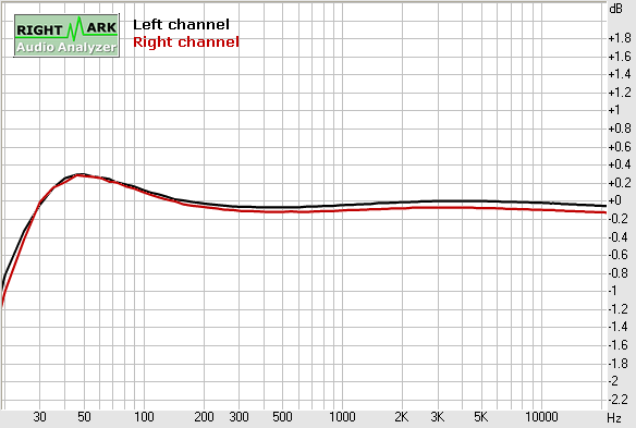

I see your phono-pre was tested by 'Inverse RIAA'.
I am interested in making a 'reference' network at present.
I have looked at various 'takes' on Inverse RIAA.
All but 1 seen so far, remain for me, less than convincingly accurate ( or just plain crazy ! ).
I'm guessing you have your own 'take' on Inverse RIAA for your testing.
Perhaps you have adopted your own referance network.
Would you have any general comments to make about Inverse RIAA.
Perhaps you have a schematic of your own network, you might post.

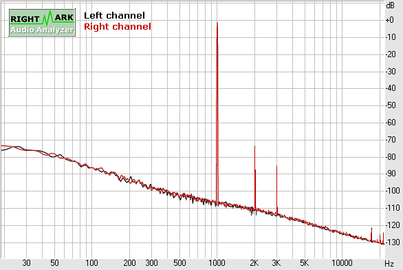

Here is a noise floor comparison between the Kora 3T MM SE and MM LE units I've done some while ago.
