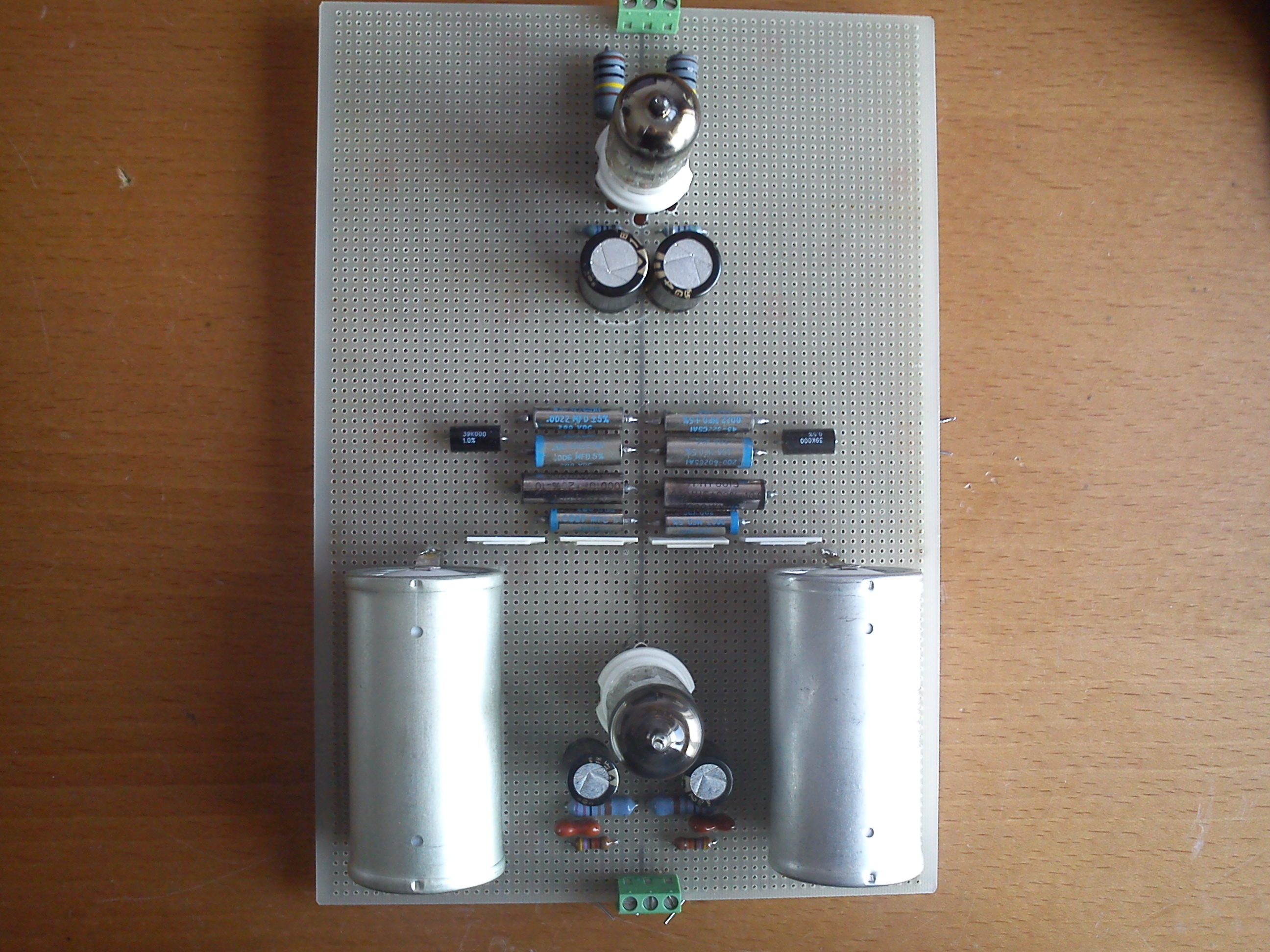

I'm open this new thread to fine tune my Puresound P10 phono RIAA, also I would like to know output impedance of first stage? schematics & real unsoldered components values as follows:
Left channel
R1 329K CADDOCK TF020R
R19 998K CADDOCK TF020R
C9+C8 .00270 paralleled .000106 = 2.806nF teflon film & aluminium foil
R17 38K9 CADDOCK TF020R
C7 .006 paralleled .0022 = 8,2nF teflon film & aluminium foil
R18 99R9 SHINKOH
Right channel
R19 999k CADDOCK TF020R
R18 99R9 SHINKOH
Any help will welcome.

Based on the info here: On 'RIAAEqualization Networks´ and following Lipshitz calc I devised a simple simulator. http://forums.melaudia.net/attachment.php?aid=1301
Excluding the effect of first stage output impedance and also the miller of the second stage, my initial test would be to use:
R17 = 38K9 // 478K = 35973 r
C9//C8 = 2.7nF // 106pF // 220pF = 3.026nF
C7 = 6nF // 2.2nF // 640pF = 8.84nF
Let me know what real values you can get so we can choose the best options.
Of course, all must be recalculated if there is significant output impedance on the first stage and we should also consider miller effect of second stage (I do not know if there is any "forward" miller from the first stage also).
I hope we can get enough input here to come to a consensual result.

My assumptions are based on the results of enumerous experiments with Salas Simplistic.
IMO, the 500,5Hz "zero" pole is of fundamental importance to the correct reproduction of the instruments timbre.
> 500,5 Produces less attack
< 500,5 Results in more nasal sound with more attack
= 500,5 Provides perfect Instrument Timbre
According to the simple formula f = 1 / 2pT
500.5Hz corresponds to 318uS time constant
This 318uS is what I am aiming to.
In this case we have R17 = 35973 ohm and C7 = 0.00884uF
R17 x C7 = 318.0013 Very close to 318.
The low frequency pole 50.05Hz and the high frequency 2122Hz are also corrected by my simulator but these depend on the impedance and miller effect on the amplifying stages.

You can reduce C8/C9 by the sum of the Miller capacitance and grid to cathode of the second stage. Miller C will equal second stage gain (likely to be 25 or so) times the grid to plate capacitance (you can find that on the data sheet).
For E88CC I found the following values (Hope these are ok as my German is very bad) :
Grid to Cathode 3.1pF
Grid to Plate 1.4pF
Miller 25 x 1.4 = 35pF
Total = 38.1pF
This is a very small value and will not introduce any nasties in the C8//C9 combo.
Anyway we can use C9//C8 = 2.7nF // 106pF // 180pF // .0381pF = 3.024nF
Now we just need input about first stage output impedance.

So I only have to add 218pF in each channel
I would determine that resistor value experimentally- in that design, the ECC83's output resistance is very significant and is likely to vary quite a bit from tube to tube. Measure the output of the preamp at 50Hz and 1kHz. If the difference is less than 20dB, add a bit more resistance. If it's more than 20dB, reduce the resistance.
As the preamp tubes age, the RIAA conformance will drift. That's a serious issue with any design that has a high rp tube feeding a passive RIAA filter.

I agree with you but just as a starting point, what would be the 1st stage output impedance ? (Let us know your best guess please).
How can we make the first stage less dependent of tube ageing ?
How can we make this design less dependent of this tube rp ?
PS: reading this: TUBES: its RP, not MU, that's important! [Archive] - The Gear Page gave me a starting point relative to rp importance.
Well, what's the current in that stage? rp is a VERY strong function of that. It could be anywhere from 50k to 250k.
Well, those values are so high that if I try to include them im my simulator (excel calculator), It produces big errors to riaa.
The highly tuned design in attach is very similar to the Puresound, appart from the plate resistor that is 5k against the 120k in the Puresound.
It seems to me this schematic also disregards the effect of the the first stage output impedance so I would have a go with the values already determined.
