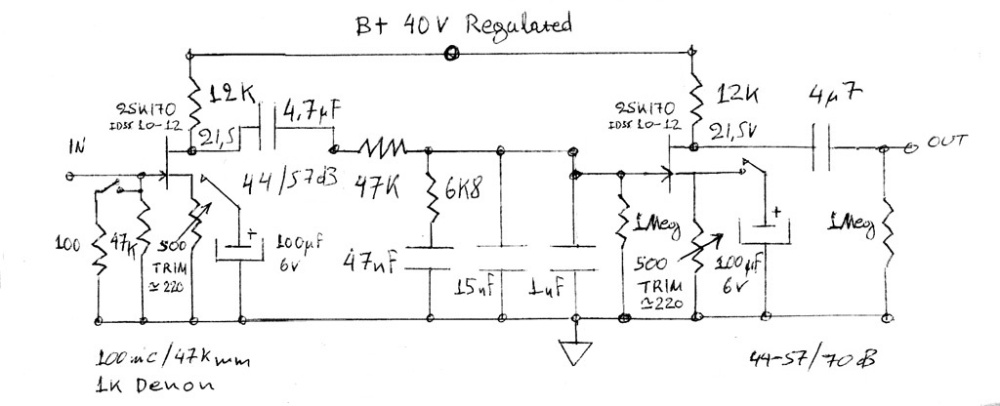

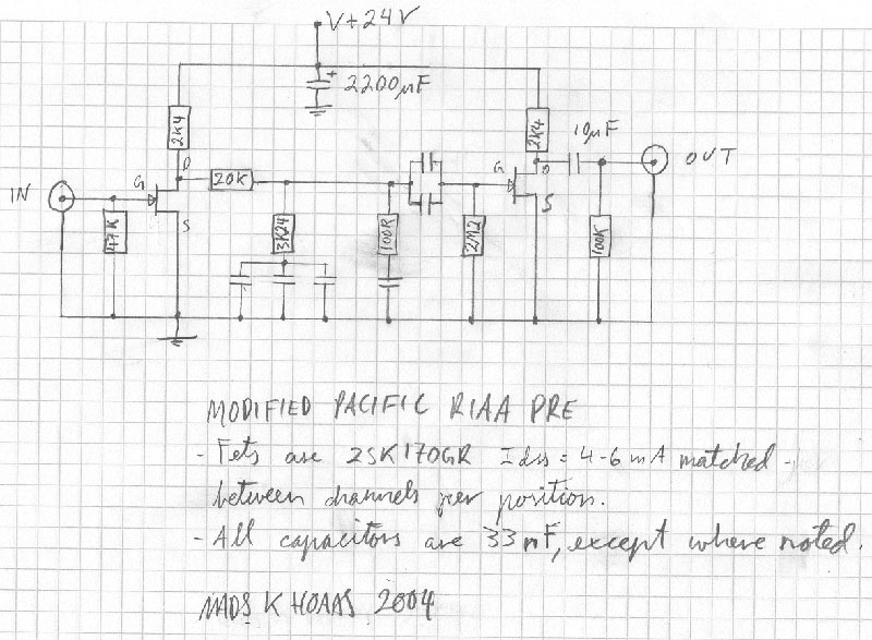

Do you mean this one.
I made in 2005 something similar to that one I had not enough amplification and difference in amplification between left and right i didn't solve the problems because with two Jfets I could not raise amplification to 28dB.
This one is similar to the Salas one maybe the second Fet has to be replaced to by a two stage bipolar transistor end-stage to get higher amplification. And raise the power supply to 40 volt.

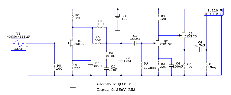

Or this one.
All these designs have Jfets to get low noise but they use 680K and 1meg resistors. Resistors make noise to.

The last design looks nice with J1 and J2 that make a srpp I believe. Only J3 shout be used as buffer with gate to R5. And a opamp lme49860 to get the right amplification, Only a thought.

I am thinking about a 2sk170 input and lme49860 output simple and as you state probably unbeatable specs.
