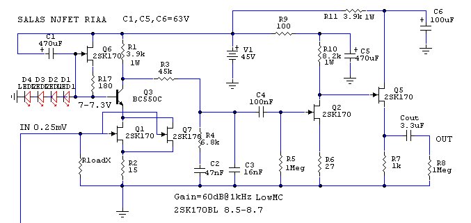

Hi I'm looking for an existing design DIY friendly for a shelter 501 0.4 mV output. My current tube phono stage has 44 dB gain with 78 dB SN. There three main designs in this forum collectively have over 6000 posts. With so many circuit diagrams produced, in the end i didn't know what i was looking at and whether it was a functioning circuit. Ideally id like some switchable gain steps as well as adjustable loading. I prefer discrete components unless there are going to be a number of transistors, then an op amp makes some sense as i prescribe to the kiss concept..
Hoping some one can point me to the right option.

Regulator thread Simplistic Salas low voltage regulator Page 190 post 1893 schematic:
Click the image to open in full size.
Simplistic Salas NJFET RIAA phono Page 366 post 3655 schematic:
You can use this RIAA for low MC 0,2mV till 0,4mV.

Thanks merlin. It gives me somewhere to start although i wasn't looking for riaa, just a head amp to go in front of my existing tube mm pre amp.

Just a head amp to go in front of your existing tube mm pre amp, I only know 2 solutions:
-Commercial I know only Piccolo from Jim Hagerman (I built a couple with BG & some exotic resistors, one with PSU another with batteries & both sounds very good).
-DIY Hiraga, It's an old design I do it with batteries, sounds very neutral & it's easy to do, do you have the schematics? if not I will search to post.
