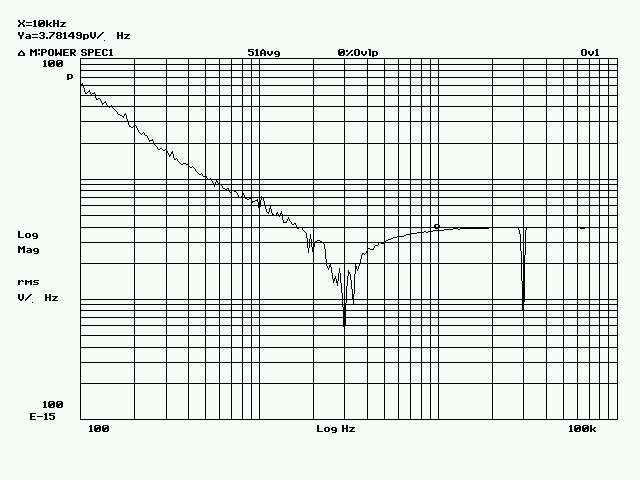

Here's the HPS4.1 current noise plot. Unfortunately the RIAA correction is already installed, so the increase of the current noise with frequency is masked by the RIAA gain drop at high frequencies.
Anyway, the equivalent input current noise @1KHz is about 5pA/rtHz. This maps to a negligible current noise contribution to the total noise, for a 10-20ohm MC.
However, for a MM cartridge having 500ohm, the current noise contribution is 2.5nV/rtHz, which adds to the 0.3nV/rtHz input voltage noise and the 2.8nV/rtHz cartridge noise. This clearly shows that HPS4.1 is not recommended for MM cartridges. OTOH, using something of the HPS4.1 complexity for a MM cartridge doesn't make much sense anyway. A simple, low noise JFET construction with a gain of 40dB (like HPS2.0) will do just fine.

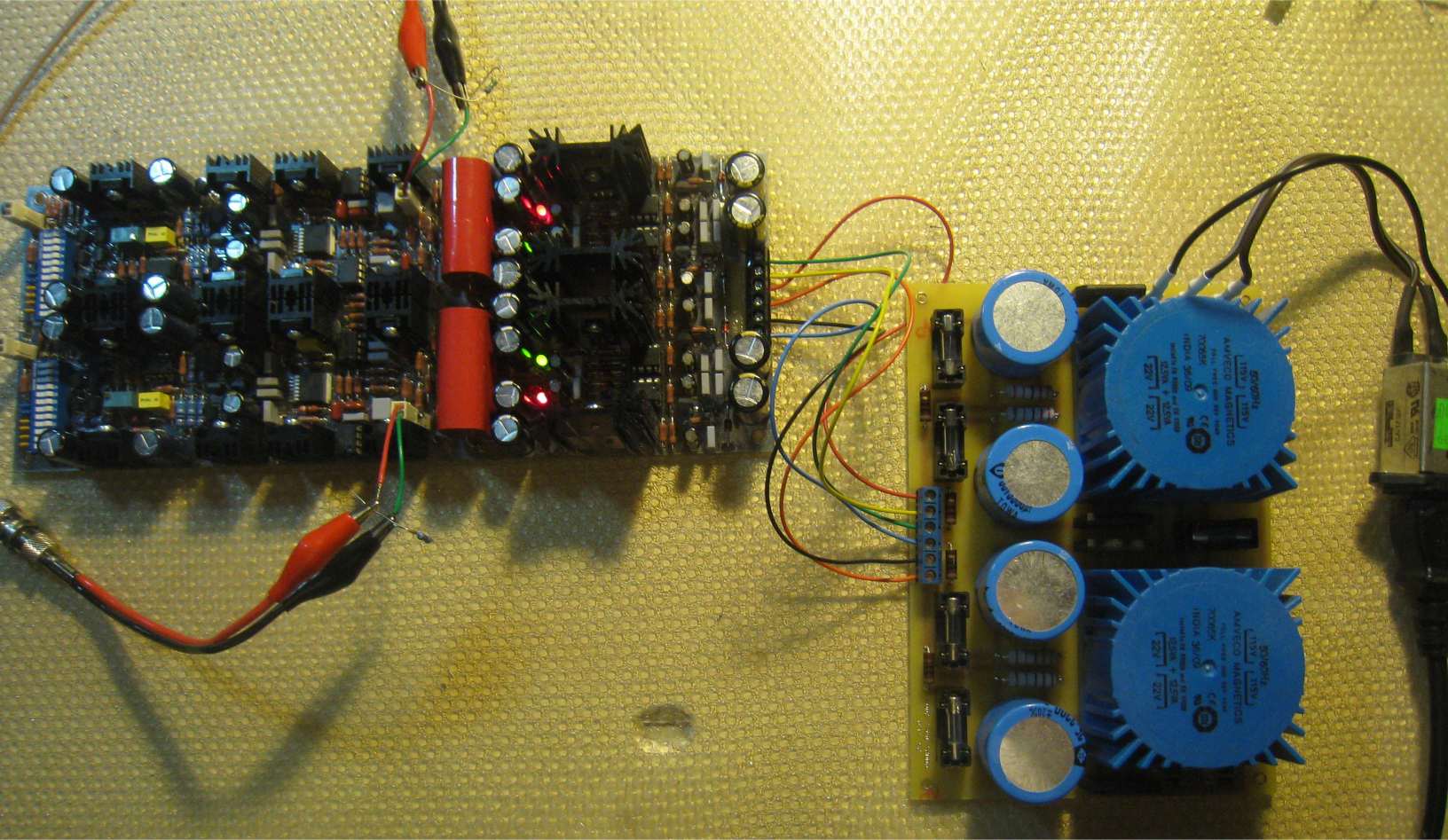

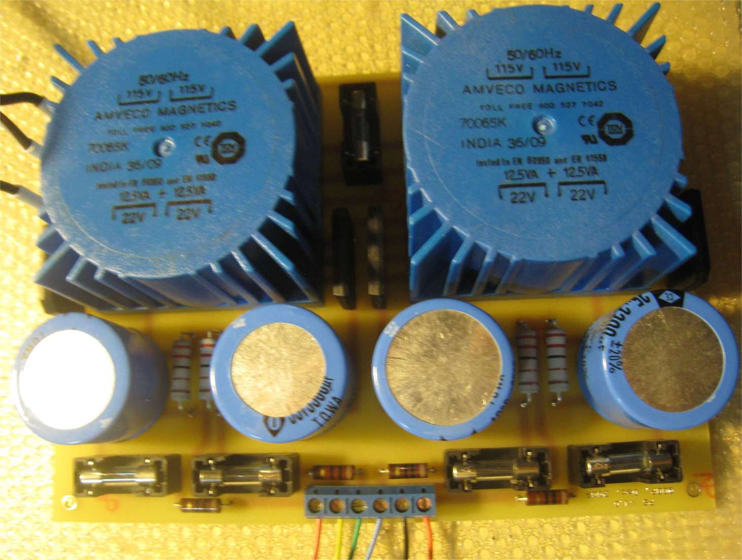

Default Power supply
I have decided to do a PCB for the raw power supply (rather than using perf board and wiring). See the attached pictures.
Testing went very well, 0.28-0.3nV/rtHz and 0.008% distortions at all frequencies and output levels up to 40Vpp. I also got only 25uV output hum (input shorted), before even throwing everything in the steel case. This is an excellent level, equivalent to 2.5nV input hum. It's actually a little better than HPS3.1 in the same stage (before case), probably because of a better layout of the input stage. But the key to low hum is the dual mono construction and the ground loop(s) handling, as described on my web site under "wiring".

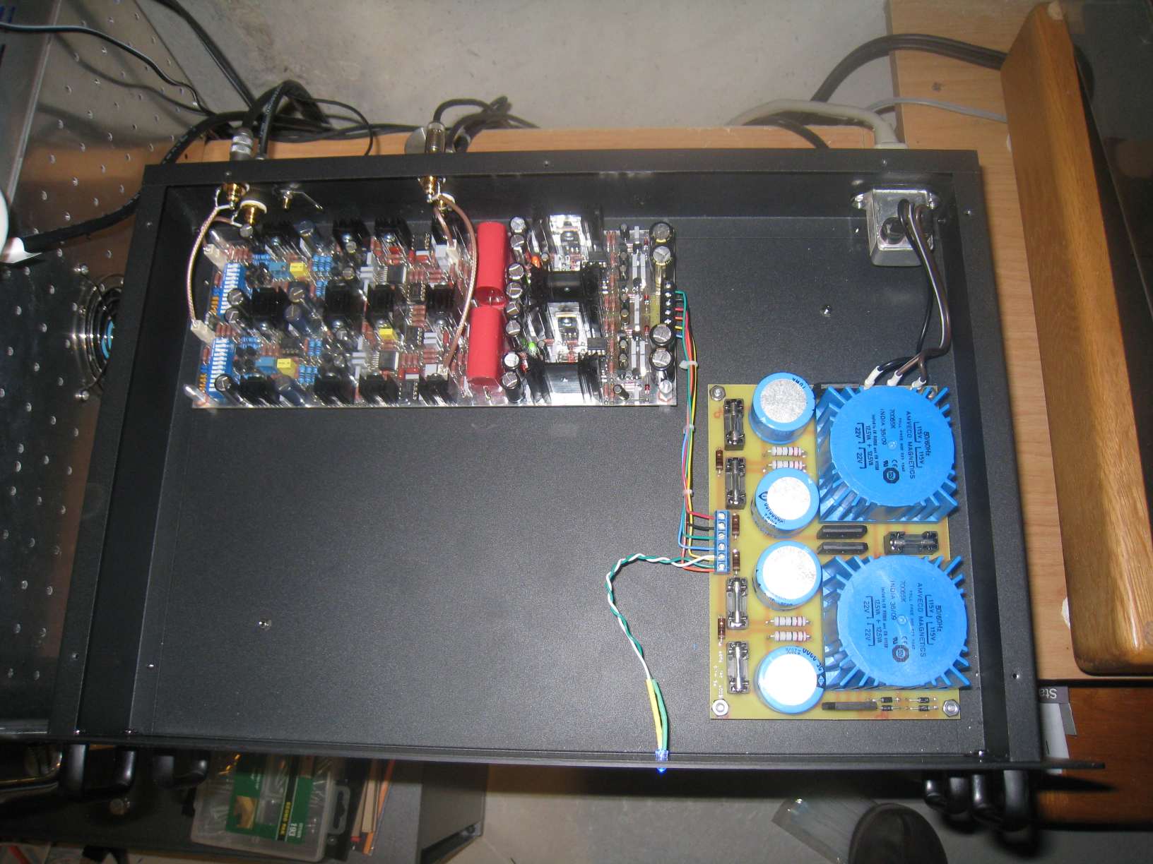

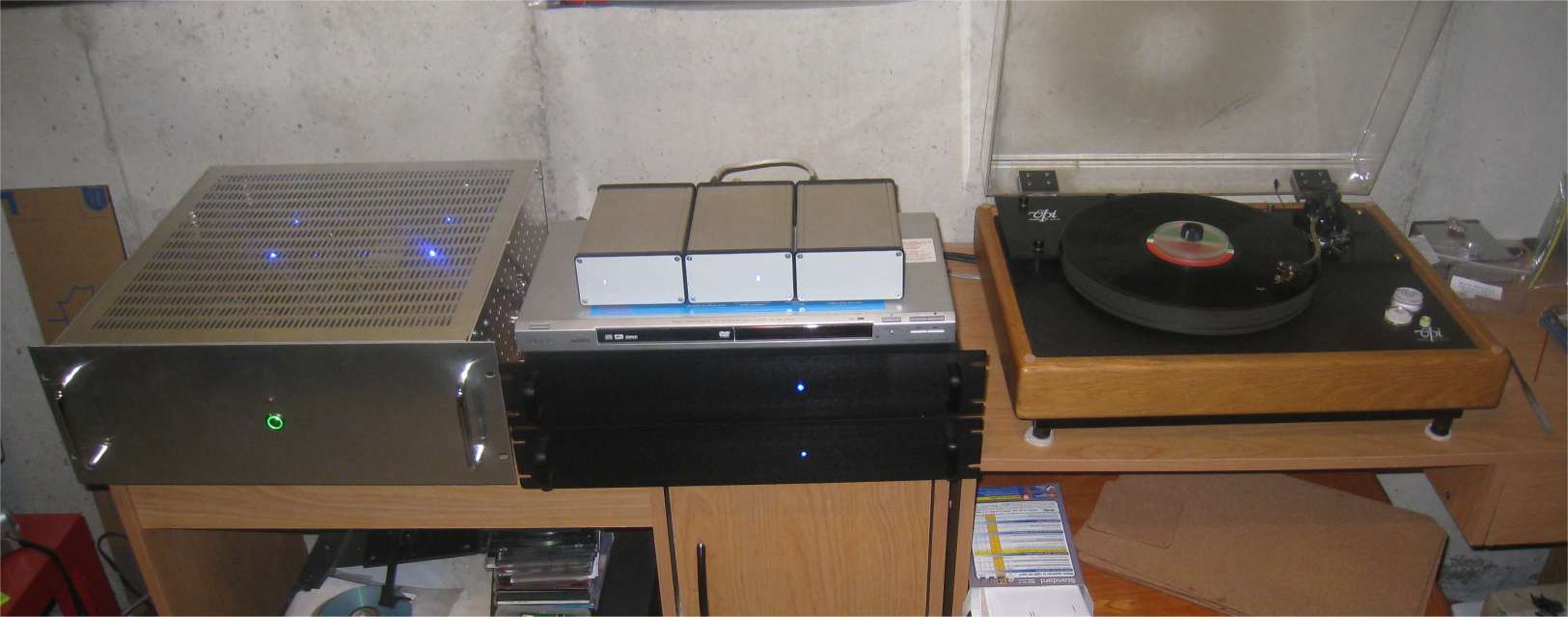

Default Case closed
Before closing the lid:
Click the image to open in full size.
The new box installed in the phono stack, ready for listening tests.
All I can tell so far: after 108dB of gain at 60Hz, zero hum, ear on grille on my 97dB horns. And also zero hiss.
