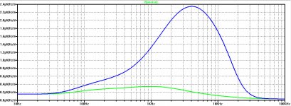

Since a picture tells more than a thousand words, I took a LT1115 op-amp, having 0.9nV/rtHz and 1.2pA/rtHz, even a bit better than the AD797.
Go back to posting #80 and look at the two noise graphs, one short circuited and the other with Cart connected giving resp 76uV an 94uV noise.
Now look how the noise graphs are with the LT1125, again resp. short circuited and with Cart.
Noise in both cases is now resp 27uV and 234uV or the equivalent of resp 88dB and 69dB SNR A-weighted ref 5mV@1Khz.
This will make it quite clear why a Fet Op-Amp is by far the better choice for an MM.

This last graph really illustrates your point Hans. That's quite a difference with the cartridge connected.

It's the QA400 picking up noise from the laptop's power supply. The peaks are the same even if I disconnect the cable from the phono stage to the QA400.
Here's a screenshot I took with the NJM2068D in the phono stage, laptop PSU disconnected:

Thanks AndrewT,
I suspect that the noise is injected in the QA400 through my laptop's USB interface. Although it's always worse at night when it's dark, even if I turn off all the LED lighting.
But you're quite right, I do need to be able to make repeatable measurements. I'm going on vacation, so it has to wait for a while.
Here's the same measurement as yesterday, with the old Dell charger disconnected from mains power. The QA400 only shows one decimal, so it's not clear if it changed a full 0.3 dBV.
I left the aluminum enclosure open last night, and now I closed and screwed it shut.
