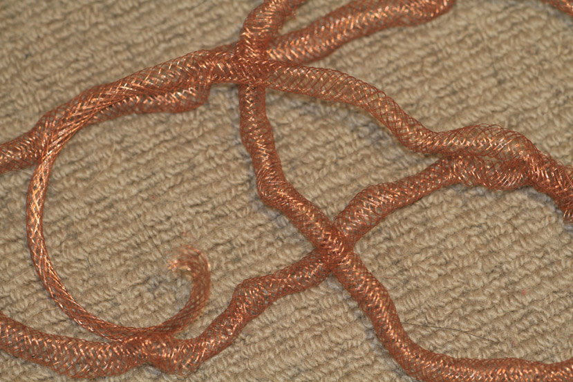

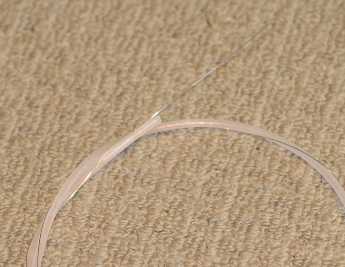

1) Strip the insulation from a length of coax that is about 1.5 times the length of the IC you want to make. You can normally do this by cutting the insulation for a few inches, then pulling the center so it cuts the rest of the outer insulation. My coax looked like this:
Click the image to open in full size.
Remove the copper braid carefully. Best to run your fingers from one end to the other so it bunches up. Save this as you need to put it back later. It looks like this:

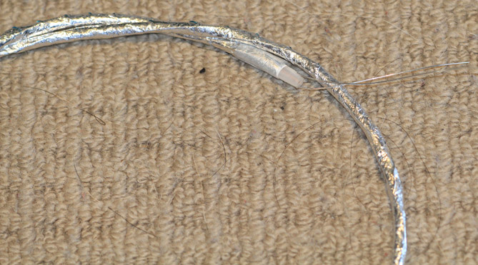

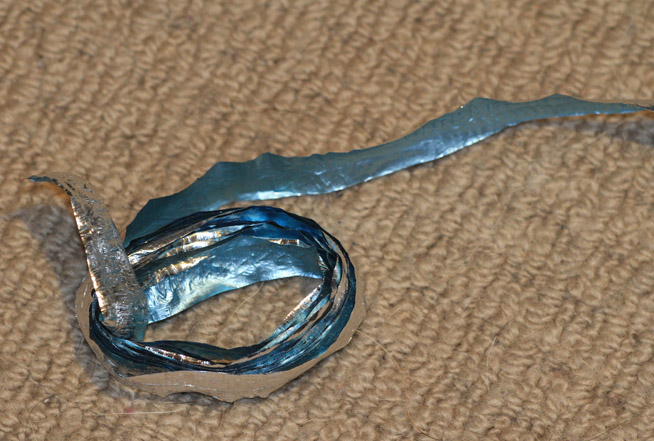

Also strip the mylar shield and put aside.

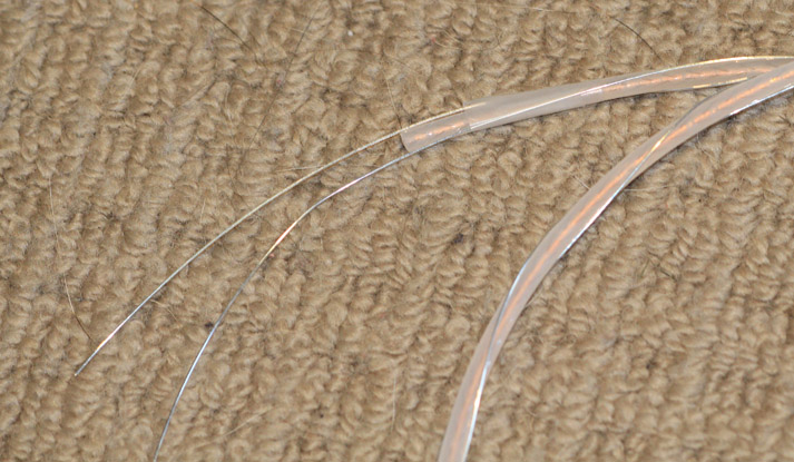

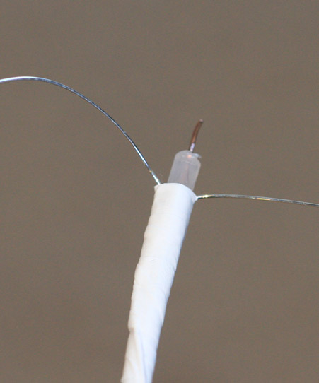

2) Now comes the wire wrapping. Cut a length of wire that is about 30cm longer than the IC you are making. Tape one end to the inner of the coax, leaving about 1/2 inch of the coax inner sticking out. You also need to leave 2-3 inches of wire so you can terminate to a phono plug.
Wrap the wire around the coax inner. Aim for a pitch of 2-3 inches. When you get to the other end, tape it.
Now tape a second length of wire to the other side of the inner, and wrap this to produce a double helix. Don't overlap the helices, but don't worry unduly if the wires touch in places. We'll sort that out in the next step.

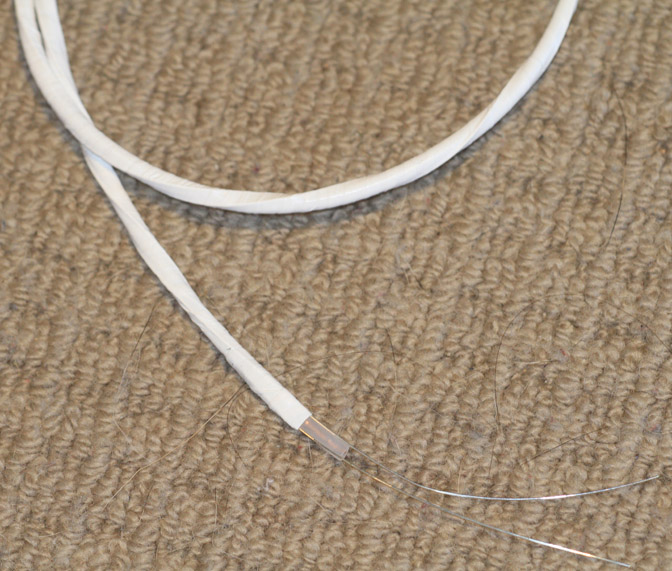

3) Wrap with the plumbers tape. This can be a frustrating step.. Start by wrapping a few turns at one end to get the tape fixed. Then work your way along the cable, about 2-4mm pitch. As you go, keep an eye on the wires and if they get close to touching, adjust as you go. When you are done it looks like this:
4) Now wrap the mylar shield back. You will probably need the shield from a longer length of coax than the length of the IC you are making.

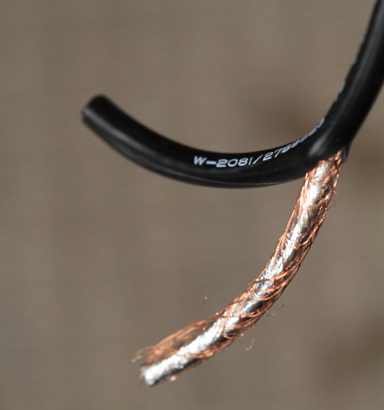

5) At one end of the cable, cut a short length of the inner off so you expose the center conductor. We will need to connect a wire to this later on.

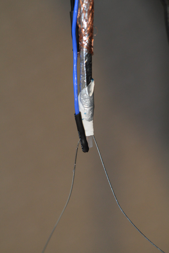

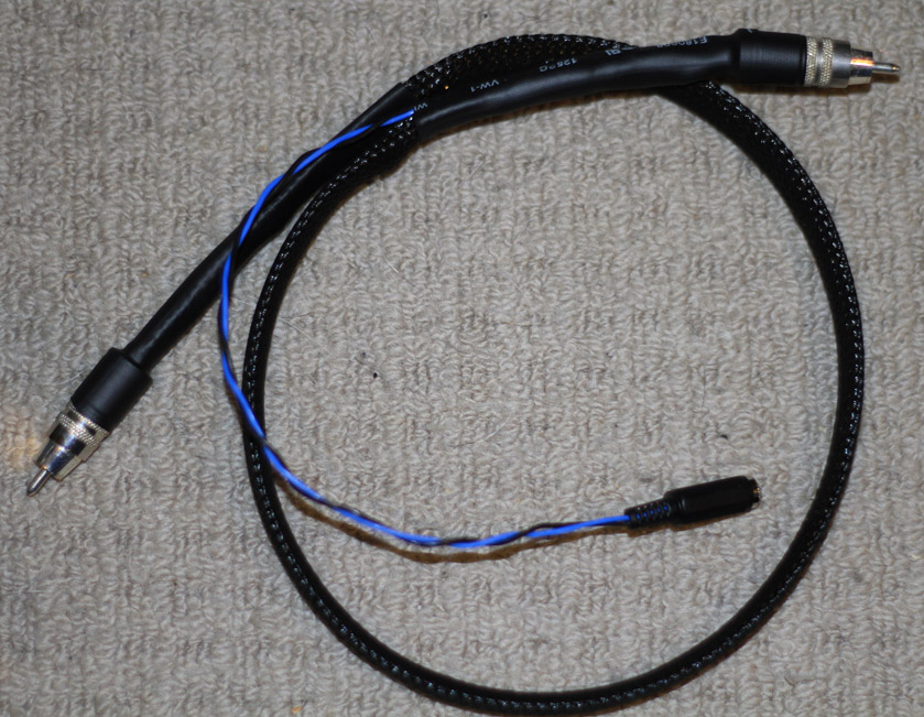

6) Now the fun part.. You need to put the copper shield back on. Slide in on carefully and it's easy.
7) At the end where you exposed the copper center conductor, leave some spare outer copper shield so you can connect a wire to that. Solder wires onto each and cover with heatshrink.
8) Now you just need to terminate each end with an RCA plug. I did this by using teflon tube that was just slightly larger than the wire I used. This insulated the wire from the end of the cable up until it was soldered inside the RCA plug. There's no strength in the cable like this however, so you need to cover with heatshrink to give it strength. The final thing:

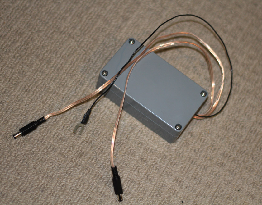

BATTERY BOX
I started with a simple set of batteries, but developed the circuit by ear until I had this:
I use a total of 6 x PP3 9 volt batteries. But I found it sounds pretty much the same with 4 x PP3. You can use any batteries you like.
You can connect all of your interconnects to the same battery box. Just parallel the outputs.
The earth connector should be connected to a chassis earth somewhere.
I put mine in a small plastic box:
Leave the battery box connected all the time. There is no current flow to speak of, so the batteries will die of old age.
