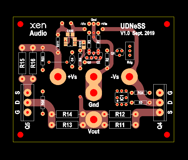

Thanks Patrick, any thoughts of someone producing a suitable PCB design for the circuits and turning them into a group buy. I think you will get a lot of interest, especially from those that might miss out on the Semisouth GB.
Even if you have Semisouth's, I think this is still a very good exercise before an SJJ.
I'll publish Gerber files for the UDNeSS perhaps in a week.
35µm double sided, within 10x10cm.
Same as the SJJ published at the Pass forum.
I'll let you figure out how to hard wire parallel FETs by P2P for the ProUDNeSS.
I have not built. We don't have US FETs in stock.
So be warned.
Patrick

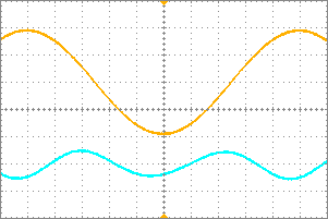

As to the phase of the second harmonics, I quote Nelson in his article :
http://www.firstwatt.com/pdf/art_h2.pdf
"So why is the phase important?
Well, it's a subtle thing. I don't suppose everyone can hear it, and fewer particularly care,
but from listening tests we learn that there is a tendency to interpret negative phase 2nd as giving a deeper soundstage
and improved localization than otherwise.
Positive phase seems to put the instruments and vocals closer and a little more in-your-face with enhanced detail.
Your results may vary .....
Roughly speaking, listeners tended to prefer about 1% negative phase 2nd harmonic...."
By sheer chance, the H2 of the UDNeSS is negative phase.
Patrick

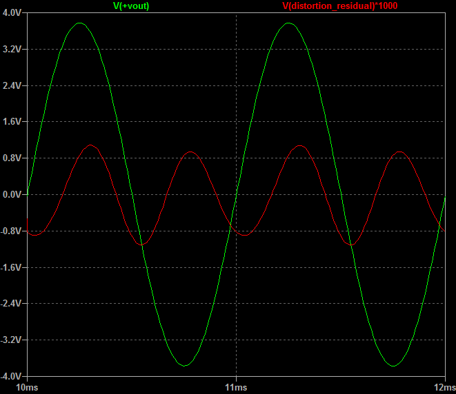

My sim indicates otherwise, please reconfirm. Ltspice seems to show inconsistent sign on phase of H2, correct on inverting circuit but shifted 180 on non inverting. I used Distortion_residual.asc from https://www.diyaudio.com/forums/software-tools/101810-spice-simulation-37.html#post133313 thread post #361 attachment.... By sheer chance, the H2 of the UDNeSS is negative phase...
Your plot shows that at 0° of the signal, the residual is at something like -80° phase.
Not ?
Patrick
Not ?
Patrick
~180 compared to J2 residual.
Please observe the alignment negative peaks of residual compared to both positive and negative peaks of the fundamental.Nelson Pass in Art_H2.pdf said:The red fundamental goes up and down at a 1 KHz rate, and we see that the blue wave goes up and down as well at twice the frequency, but aligned with the red wave in a particular way - the blue goes down when the red goes up and the blue also goes down when the red goes down. I refer to this as negative phase 2nd harmonic. Positive phase 2nd harmonic is the opposite.
Thanks Patrick for another intriguing design! I'm definately interested in building this. I hope the gerbers will match to the UMS specification. 🙂
I am pleased to say that someone (I trust) has agreed to be Alpha tester.
So he will get the prototype built and tested first.
Any necessary changes will then be implemented before releasing the Gerber files to the public.
It will thus take a little longer.
Hopefully before Christmas, 😉
Patrick

Hi Patrick. Following this thread and very excited about this project. Does the servo require a separate power supply? Hard to tell what might be happening on the underside of the board. Thanks for developing this Obtanium J2!
Servo uses the same power supply but have additional RC decoupling.
Too early to show everything till properly tested.
Good things take time. No point to rush.
Patrick
