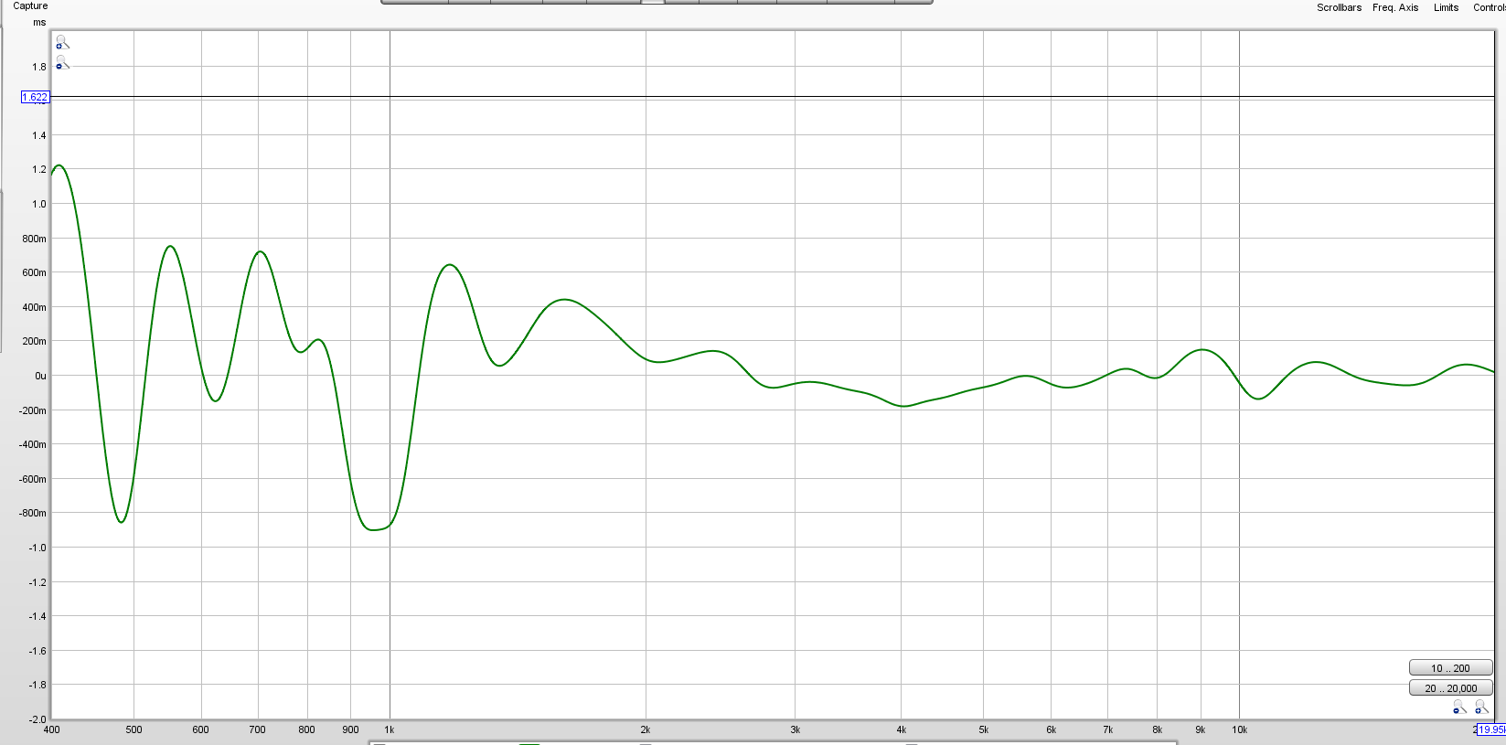

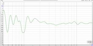

Clearly, my horn is already built so all I’m playing with are the crossover options. The Yorkville is well designed, at least as regards the mids “reaching” the “tweeter” (BMS4550). The stock HF x-over is 1250 Hz. My mid “cancellation notch” is about 1.9 KHz. The BMS4550 is rated down to 800 Hz. At higher outputs, I’m aware the CD is “happier” if it isn’t expected to play down to 800 Hz. Thus the Yorkville’s 1250 Hz, the SH50’s 1350 Hz x-over points. Yet, at least at first glance, it seems that Danley is crossing over much lower!
(RobWells, msg #21) quotes Danley: “A crossover hint. Next time you have your software open, model two band pass filters to make a pretend upper and lower speaker. Examine the phase response for each. Notice that the phase doesn’t approach zero until quite a ways above the low corners.
Our style xover ideally ends with a flat phase response like there was no crossover at all. So, what one can see is that if one were going to “shove” the two bandwidths closer together to knit them so that the phases were say around 90 degrees apart , that you have to be past the low corner of the upper driver. Also the less phase shift the corner has (shallower) the less rapidly the phase is changing”.
Here, I’m befuddled: yes, any driver (the BMS4550 in this case) will have a low corner, call it 800 Hz. It has a natural (acoustic) roll-off. But does Danley use this natural roll off? If so, how does he protect the delicate compression driver from unwanted lower frequencies?
Intuitively, I think I understand what he’s advocating: let’s consider the mid port’s natural low-pass behavior: in my case, at about 1.9 KHz. Sure, I can put an electrical filter there, it wouldn’t hurt anything if I left it out, but we are prone to unwanted “harmonics” of the ½ wave cancellation. We don’t want any output from mids > 1.9 KHz. So are we doing the same with the “tweeter” but as a high-pass? Sure, it can be done, and that’ll protect the CD somewhat, but again, how can you get a higher crossover frequency if you’ve set them already at the (in CD’s case) lower corner? Me is confused. OK, Tom, I’m baffled. Sure, your SH50 or whatever will have different crossover points, maybe not the BMS4550 (same CD, I think, as the Yorkville) but the mid’s ½ wave notch? Almost certainly different.
Can it be as simple as what I’m proposing here (e.g. my mids LP = cancellation frequency), and the “tweeter” HP at 800 Hz? I say “yes” because this uses the natural corners of each driver, and the electrical x-over is “protection.” But a frequency overlap of a whole octave? Well, why not? The phase is -- potentially -- wonderful in the middle of that range, but the phase is still going to be a dog’s breakfast at those corner frequencies, isn’t it? Perhaps the broad overlap smooths out the phases? Could be: the CD is well into its smooth phase operating range when the mids are getting sloppy, and vice versa.
I realize Danley does more: he still has to make the highs and lows meet up in time. He can do this with his secret crossover. I can (or should be able to) do this with simple delay.
“A changing phase is changing time.
This is why I have mentioned the lower response corner and phase of the bms driver, it makes it easier to do. If you examine the group delay for the sum and displace the upper driver to the rear, one can justify the GD to be equal. When you have the right electrical part and the right physical offset, it looks, acts, sounds like one driver covering that band. I can’t tell you what slopes to use because you end up with something with no name, it has to be adapted to the acoustic magnitude and phase responses of the sources. I can say that usually I can get away with something reaching a 4th order or higher electrical high pass for the compression driver.’ [Edited slightly].
Using a higher order to delay the highs a suitable time?
(Cask05 #23) writes: “Also, you will find that high-pass/low pass crossover filter frequency overlap will need to be increased using MEH designs. I find that using first order crossover filters automatically takes care of the phase/frequency and the polar coverage/frequency issues. I recommend first trying the high pass crossover frequency at about 50 Hz below the low pass point, as a start. You will need to iterate this to find the best overlap to use for your horn coverage angles and off-axis ports.”
The use of gapped crossover points is mentioned a few times. But again, what is the benefit, if these are far from the natural corners of the CD and mids, respectively? Those corners are set by physical constraints, you can’t change them. This is what is causing my brain to crash and reboot.

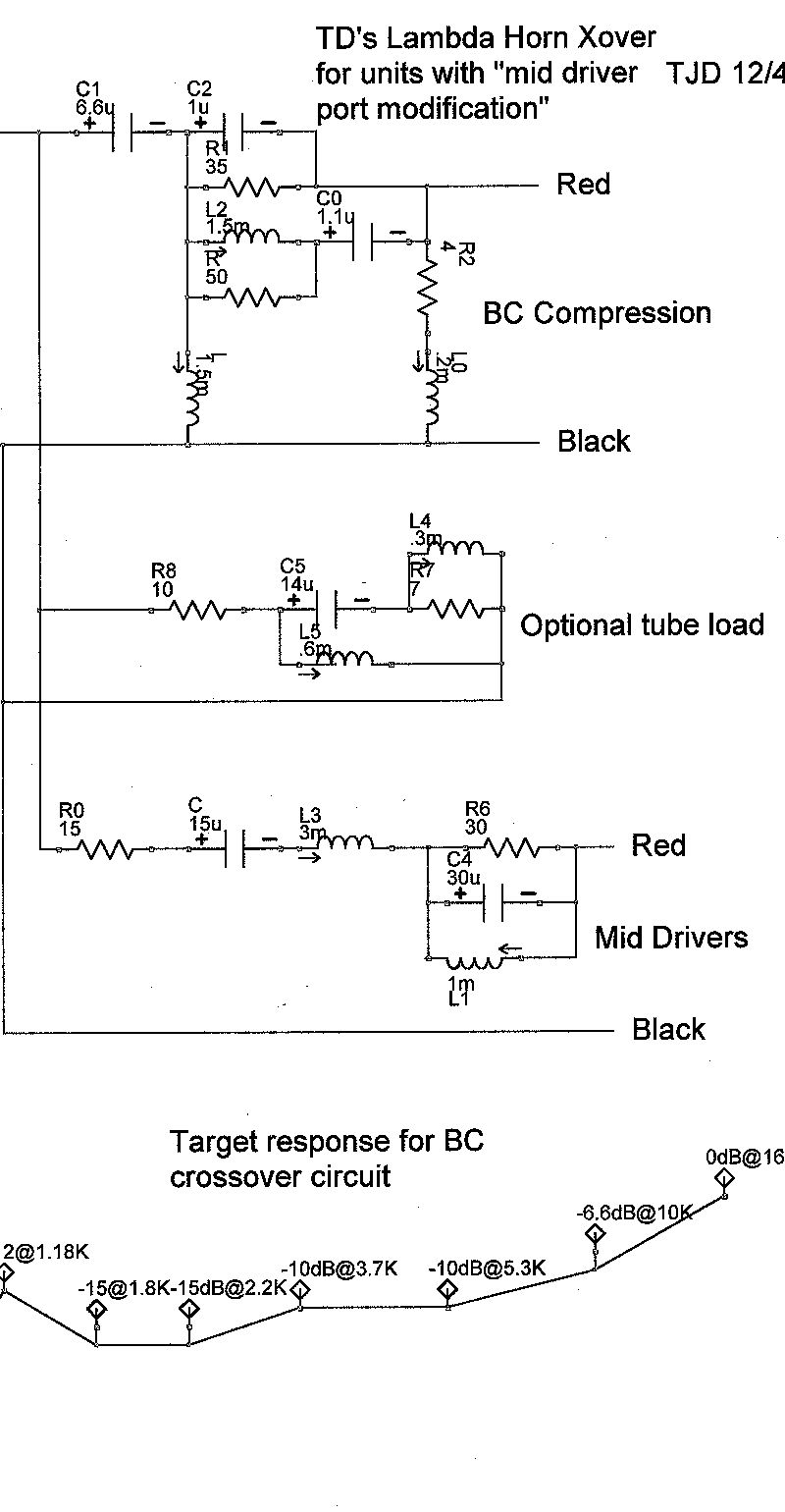

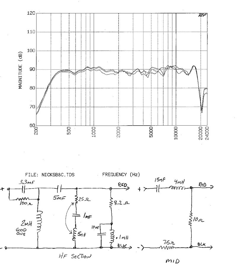

Interestingly the Synergy crossover is not described in the patent and is therefor not covered. This is especially interesting because the crossover is described as the main difference between Unity and Synergy horns. The only other difference is the smaller mid ports, which is covered by prior art.

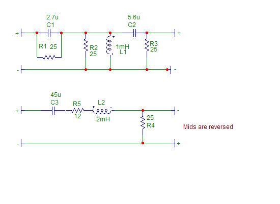

Soldermizer, I believe you are on the right track. Shelve your two responses down 6dB and have them overlap at that level for an octave or more. That should do the trick. Because of horn loading and the eq required for a flat response you are already down a long way at 1KHz. Even use a little boost if necessary to extend the response of your drivers for a bigger overlap. You'll be amazed just how hard you can push that 4550 in a domestic environment.
I've done many MEH active and passive crossovers and this recipe does work.

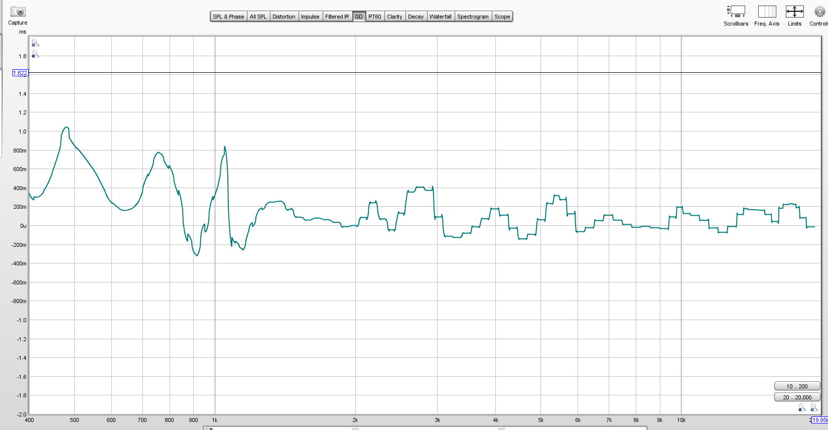

Yes, I have an ECM8000 mic. Patrick: not to worry: of course I meant to discuss the UNITY crossover 😀
One thing I haven't tried is first order filters. For light duty home use, there should be no stress on the CD, especially with all the available overlap between "tweeter" and mids.
I should dig out my test rig and play with the EQ some more. It's been a few years 🙂 One thing I've noticed listening to the Yorkvilles is they image well, and are fairly resilient even to various slopes, crossover frequencies, and so on. To screw it up, I have to make a major goof, like invert one driver's polarity. This I attribute to the Unity design, but it could be my tin ears as well. Perhaps the fact that most of my listening is to lossy codecs, which throw away those parts of the music that cause more sophisticated people to spend more on their audio system than they do on their automobile >🙂

moosebog.com is almost here! used to have the crossover schematic of the original Lambda unity horn. And if you looked at it, the tweeter xover was quite steep. Something like 3rd or 4th order.
With my xovers for my Unity horns in the last ten years or so, I use the solution proposed by LeCleach here: http://www.melaudia.net/zdoc/jml_crossovers_etf04.pdf
Here's a discussion that William and I had, about the original Unity xover, eleven years ago : Another Unity Horn
In a nutshell, it's quite easy to get flat response and well behaved phase response in a Unity horn. This is because the drive units are so close together; it's basically hard to screw it up. You can get quite good performance with as little as 3 or 4 passive components, total.
If you want to elevate things to the next level, the LeCleach paper explains one solution and I like it a lot.
Once "catch" with the LeCleach solution is that he includes a phase inversion. Whether this is taboo in a Unity horn is open to discussion.
I wish I was one of those people that could sit there and obsessively tweak a crossover until the loudspeaker can produce square waves. But, again, crossovers aren't my forte.
I will say that there's something truly eerie about the imaging of the SH50, and I personally think that the crossover has as much to do with it as the other elements.
The crossover is something else, and I get the impression that Danley has continued to refine it over the years. A real work of art.
When I rented those SH50s back in the day, I tried to buy them. They never replied to my email.

This?
TTBOMK these are the only Danley crossovers for the original Lambda Acoustics Unity horn.
I believe this is the xover that used to be hosted on the Moosebog site.
That goes way back, to the days of The Bass List. In 2001 I was working for a failing dot com, and I would basically study patents to kill time, while I waited for all of us to get laid off.
The Unity patents were one of them, and got me started on this crazy journey.
I think John Sheerin was on the bass list also, and I believe he was the first person to ever build a DIY Unity horn.

I have plot the group delay of the SH-50 to illustrate what the final result should look like (basically flat) (yes took ages I ripped the data from the graphs).
Hi kipman
I don't quite get it whether these group-delay graphs are from an actual group-deay measurement or if the were derived form the amplitude response.
My gut feeling is that they should actually look a little better. Or am I wrong ?
Regards
Charles
