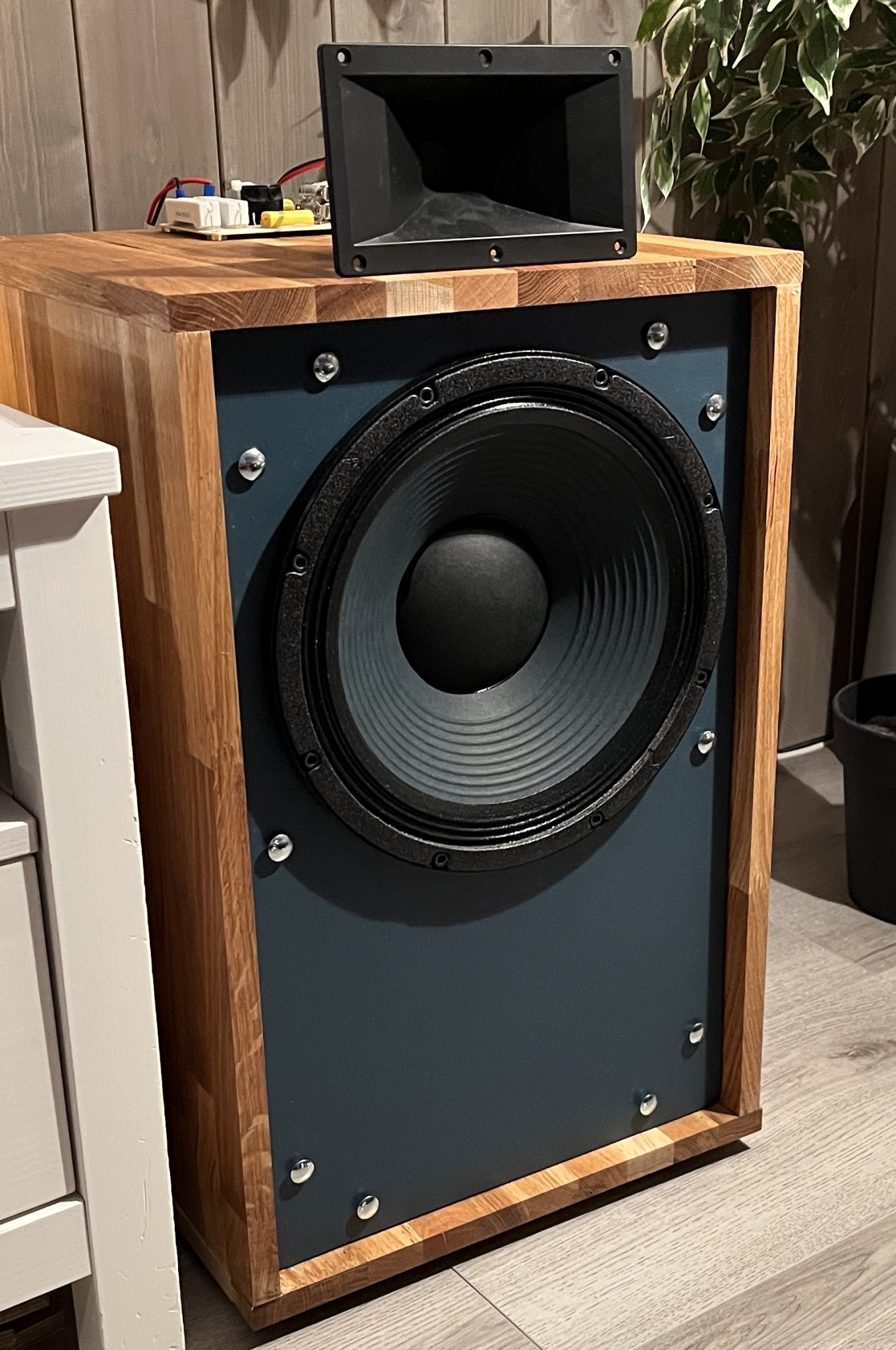

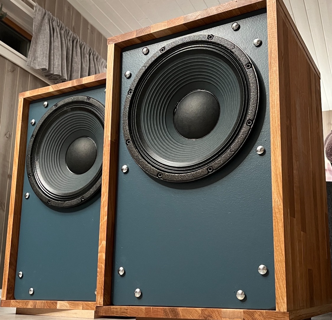

Story:
Inspired by the classic vintage speakers Tannoy Little Red & Gold Monitor(s), Klipsch Heresy, JBL 4312/L100, and the more recent and more applicable to this thread particularly, the JBL 4319, I’m now trying to up-the-game from 2-way to 3-way.
I've realized in my 5+ years quest that the end goal is increasingly more vague for every prototype and as the cost of this idiotic hobby is more and more difficult to argue I think I’m closing up on cabinets and drivers soon, and will enter crossover tuning and DSP for getting the results I want with what I currently have.
My most successful speaker so far was a Celestion coaxial in an oak cabinet using an Eminence stock crossover. This cabinet is exactly the same but the driver arrangement will be a 3-way system with Fane PA drivers. I’ve tried this before in a poplar ply cabinet using an Eminenxe horn mid/high combo instead but now aiming for a less PA sound.
As I’m still looking for a tweeter to fit I have not cut out the midrange and tweeter, and I’m using an Eden by Eminence bass driver with a Selenium CD while sourcing the missing parts just to try them out for an upcoming next project. Luckily all the bass drivers use the same cut outs and bolt diameter….
All in all, all my projects merge and mix and never completes and I’m losing track, but it’s great fun and learning.
Thought I just share a little of the build so far. I’ll post more pics as I find the tweeter I want.
Drivers:
Planned bass driver: Fane Pro 12-500
Current bass driver: Eden 12 something (from a sell out)
Planned midrange: Fane 5FRK Studio
Planned tweeter: to be decided, possibly
Eminence APT50 or ASD1001
Current tweeter: Selenium 220Ti in a Emience APT200 horn (if I remember correctly)
Crossover at the moment is a stock Eminence 1,6kHz which doesn’t fit as well. I plan to try the 2,5cx from the Celestion build in a few days.
Cabinet details:
Double MDF removable baffles 58x36cm
Inner depth 30cm, outer depth 40cm
Reactions: 1 users

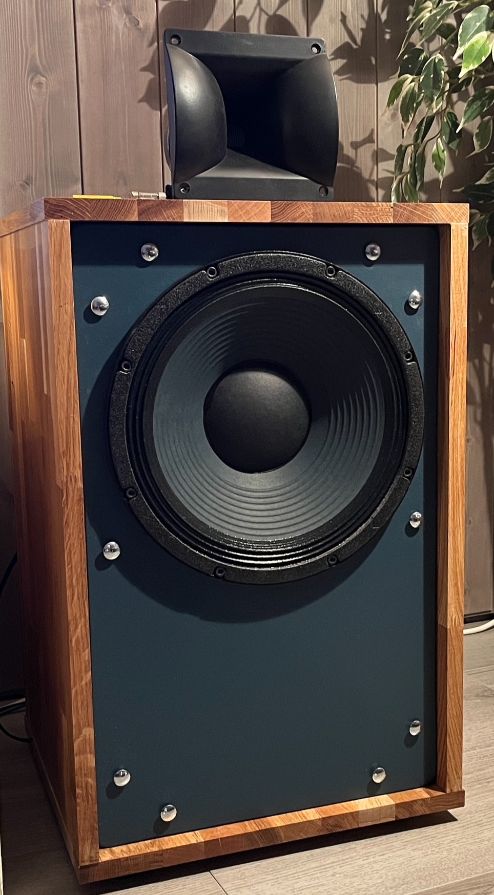

Today I did some testing and small changes to the temporary setup. The 1,6kHz crossover doesn’t work very well nor did the Selenium in the Eminence APT200S horn.
Well to my ears, no measurement.
So I replaced the crossover with the 2,5kHz used on the Celestion coax as planned and I replaced the horn and driver with Eminence ASD1001 driver and APT150S flare.
The result is decent.
Still bright though, treble need some taming, but I’m positively surprised by the Eden bass driver, it seems very capable in a setup like this.
I have not attached the rear baffle yet so it’s free air and no bass ports yet. Plan to do this next.
Also I’m now thinking about getting a larger horn for this arrangement and re-think the whole 3-way concept as a floor stander it seems to perform better with a horn resting on the cabinet like this.
I plan to test with APT50 tomorrow.
But now I don’t know what to do with the Fane bass and mid, and the selenium driver.
So many detours.
Are there any nice larger aluminum flares for 1” drivers out there?
Reactions: 1 user

2-way with top mounted horn (like Im testing now), or 3-way JBL4319-style.
The first would fit the living room great placed on the floor as in the pictures, the second would be nice in the studio on a desk.
In both cases I'm not sure what drivers to use: Fane or Eden bass, Eminence or Selenium trebles.
And what waveguides. So many combination options.
Ill let this sink a little while completing the rear of the box with bass ports etc.

??? Dunno.... complete mess. On average, how long does it take you to read a 1000 pages? You were pretty quick to find ''the answer''. ''Selenium", is that the problem? Let's not fool ourselves - nice things cost money. Man, are you kidding us? I try to be tactful and say things kindly, but if you ask for my opinion, I will give it to you.
In my opinion this aspect makes your project difficult.
Compression drivers/horns tend to have response anomalies that have to be corrected if you are seeking a neutral presentation. One of the larger issues being rising response with decreasing frequency in many, and this is different for different horns/waveguides and different compression drivers. If you are trying to use off-the-shelf crossovers with non-specified drivers and horns the results are going to be pretty random.
Off-the-shelf pro audio crossovers also tend to be kind of basic. They'll protect the drivers and give a reasonable response with the intended drivers, but they tend to be more of a PA system kind of solution, not necessarily an audiophile or studio monitor level of performance.
I can't tell what you are ultimately trying to do with passive crossovers and what you are trying to do active/DSP. Acoustic measurements would make life a lot easier in either case though. Short of that, an analog equalizer can help tuning, since it gives instant response, which some DSPs lack. With a neutral reference to compare to, an unruly speaker can be tamed by ear, but without measurements it is harder and more likely to devolve into extended tail chasing if you don't have significant experience.
There are other complexities, but I don't want to ramble on. Just hoping this nudges the discussion onto a more productive tack.
