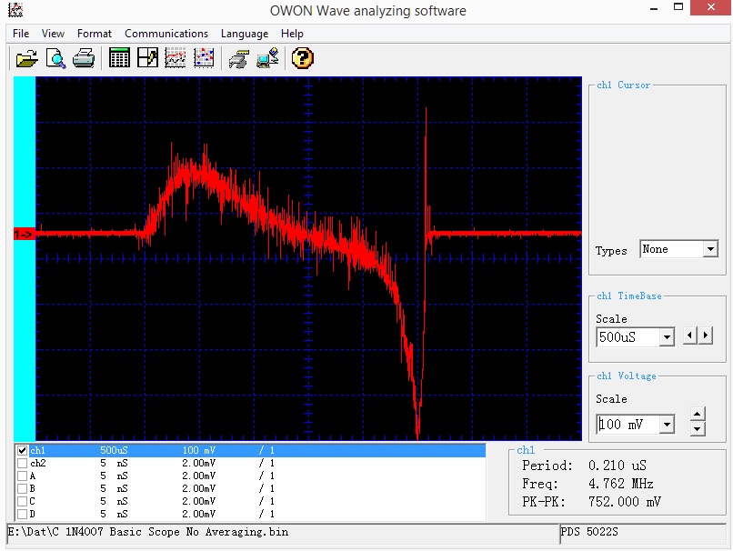

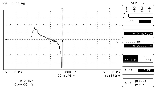

My recent best diode switching waveform is attached. I believe it shows turn on, turn on ringing first 1/2 cycle, noise passed from the power line during conduction time, decreasing current draw as charging progresses, a bit oof the rise in voltage as the transformer unloads from the peak current draw and then the turn off spike.
The power supply was as I recall a 24 volt toroidal transformer feeding a bridge of 1N4007s into a load of 470 ohms & 500 uF. the current probe was custom made and fed the 50 ohm oscilloscope input.

Thanks for your post, Ed! Your current probe must have been mighty sensitive to deliver 15mV into 50 ohms on a current peak of (I'm guessing) 0.6 amps. I note that your current waveform above is a member of a family of waveforms; it is the (zeta=0) member. I had fun in the LA article, plotting both the (zeta=0) and (zeta=1.5) family members on the same graph.
I hope the Editor won't mind if I let the cat out of the bag a teeny bit further, and say that the 1N4005 finished in 42nd place out of 48 diodes; 88% of diodes tested were superior. Furthermore, the 1N4005 was the very worst of the 1-amp-rated diodes; the diodes that stunk even more, were all rated for >1 amp.However I must let at least the cat's meow out of the bag. 1N400x are cheap but have a lot of noise...

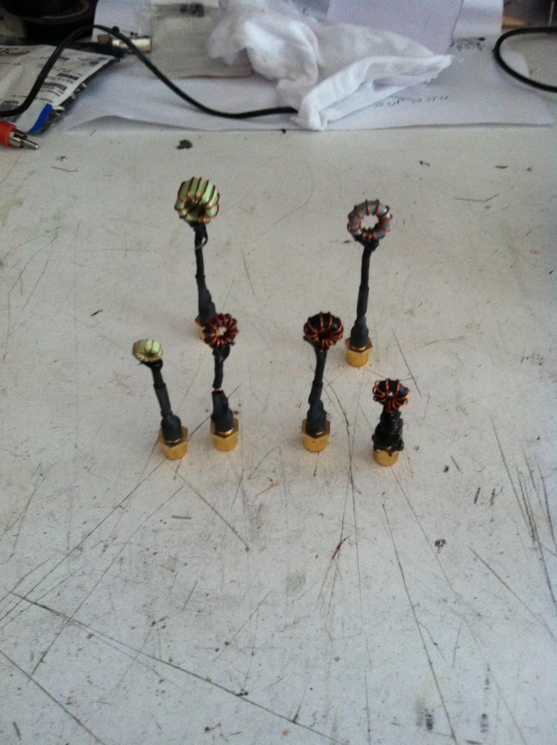

Never really calibrated the probes as all I wanted was a picture!

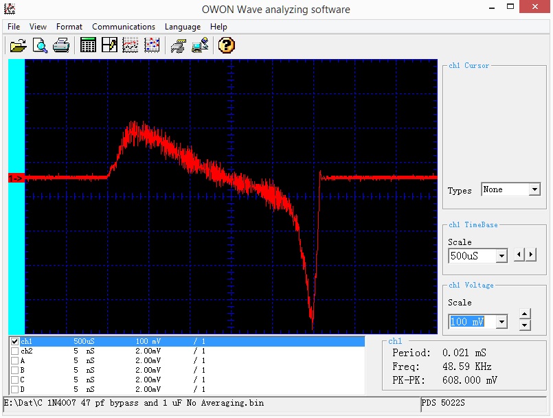

Attached are some older pictures showing the results of placing a snubber on the transformer secondary. Drops the line noise a bit and really cleans up the switch off inductive spike.
It looks like the current probe is being subjected to a DC current in that test setup.
As a reference, would you be able to show the probe measuring a somewhat similar DC current waveform from say a DC supply with resistor load that is electronically switched, and hence give a typical square current waveform of similar 'current x time' duty cycle ?
