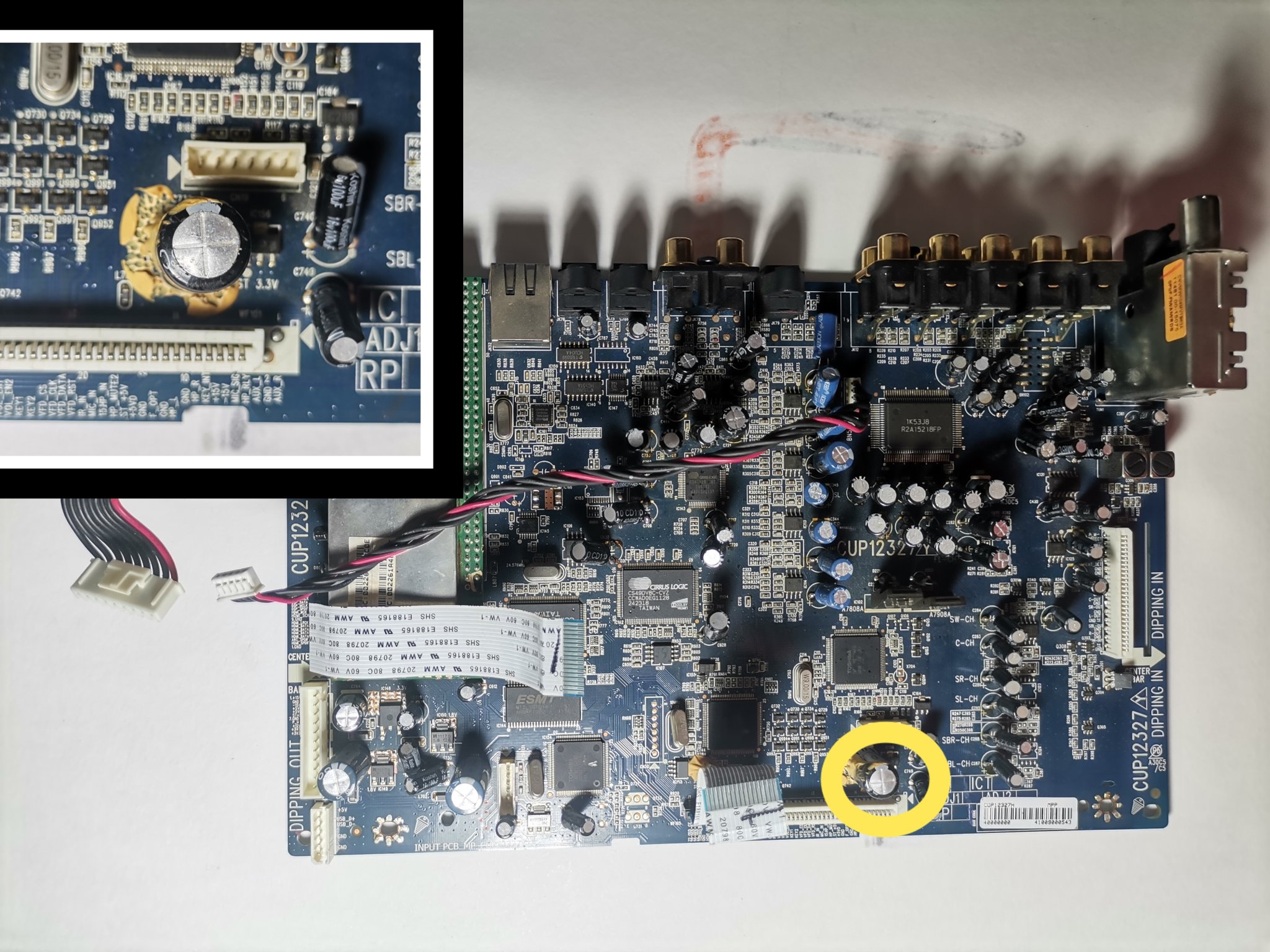

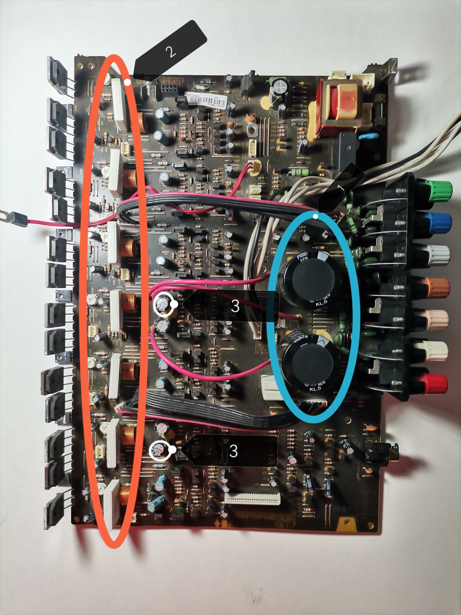

I disassembled the amplifier neatly. Now all the capacitors and processors are visible in front of me, but I don't know where to look for the problem :)
There are a few swollen capacitors that catch my eye, I think I'll start by measuring their values.

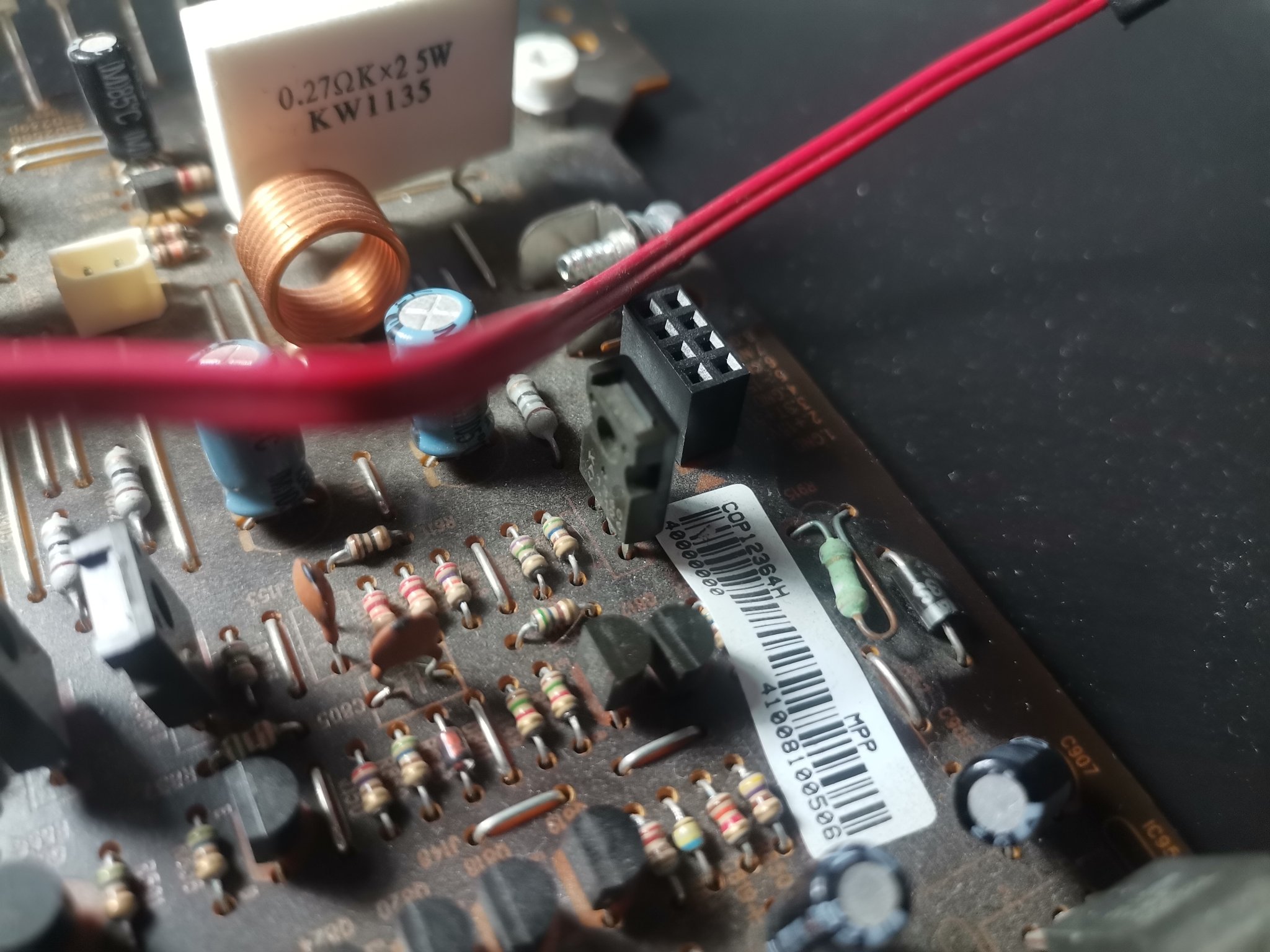

When I checked the PA section, the resistors were found to be intact (I marked them with 2). The one I marked with 1 seems to be solid, but it is a 13-year-old device and I am thinking of replacing both of them. There are visibly swollen capacitors in the parts I marked with 3, I will replace all of them and try them.

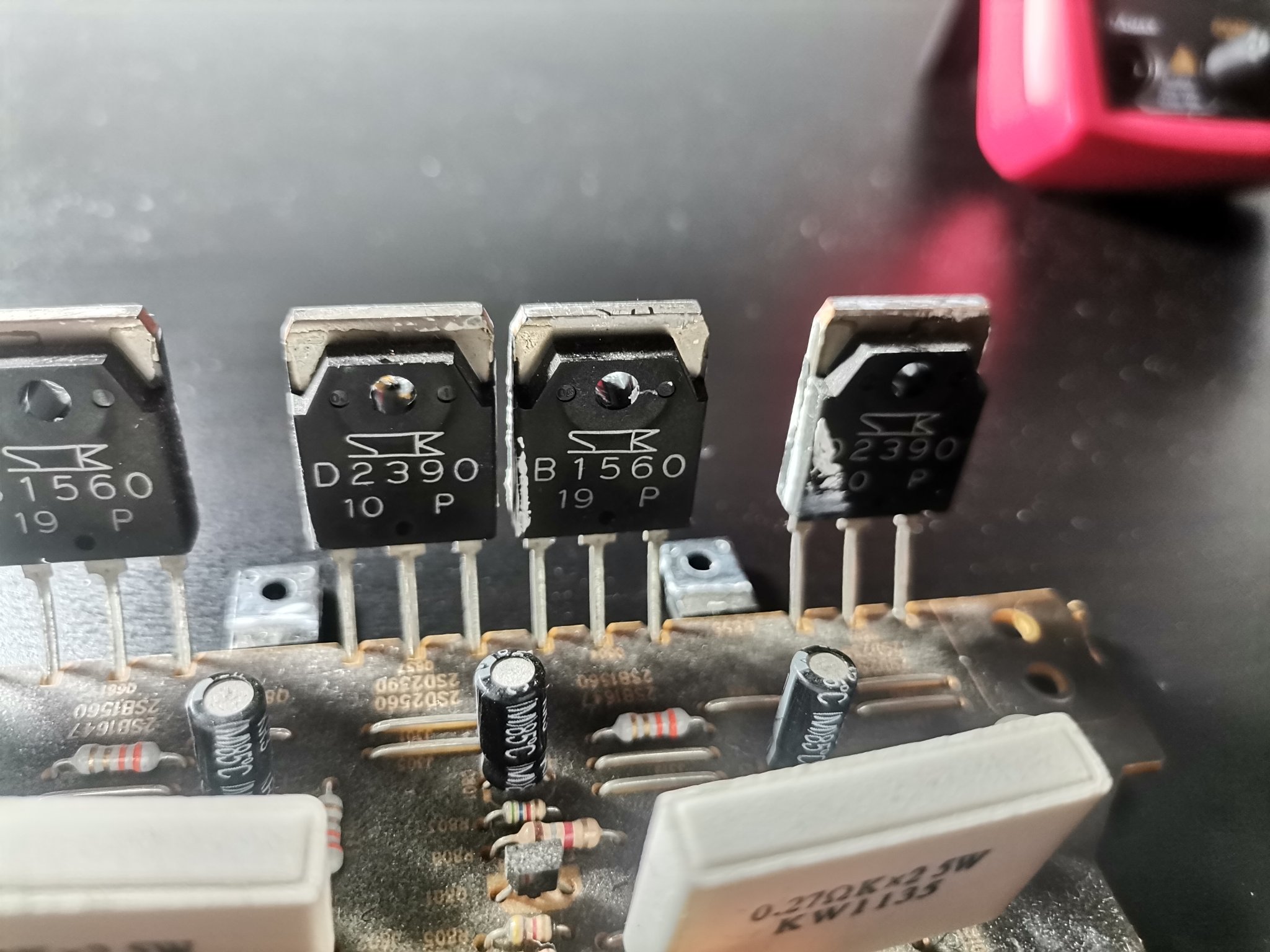

I measured the value of the transistors connected to the cooler and I suspect one of them (the one whose photo I attached, underlined in blue in the D1560 section on the paper).
