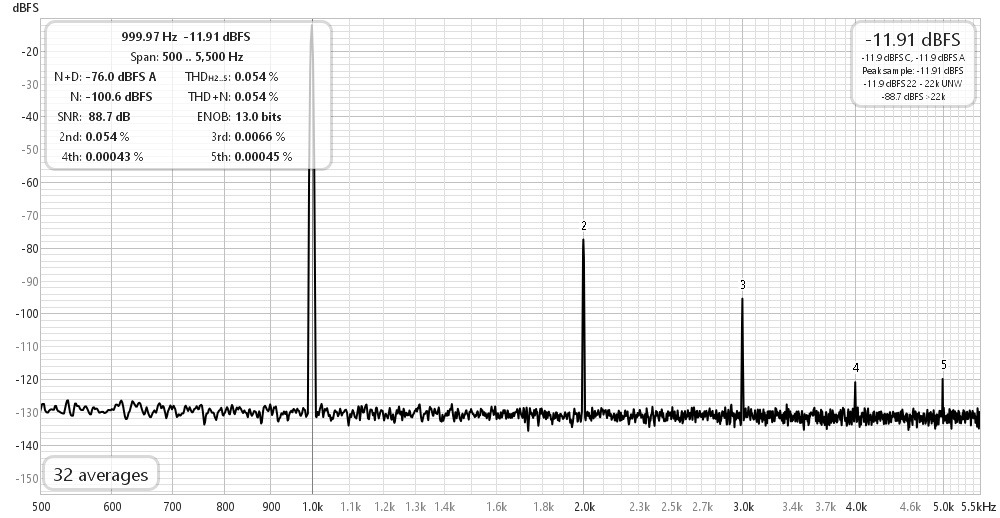

A further addition to the collection -- the xen JFET passive IV :
https://www.diyaudio.com/community/...st-tht-i2s-input-nos-r-2r.354078/post-7160371
Tube lovers must give it a try.
Essentially second harmonics dominant.
Patrick
