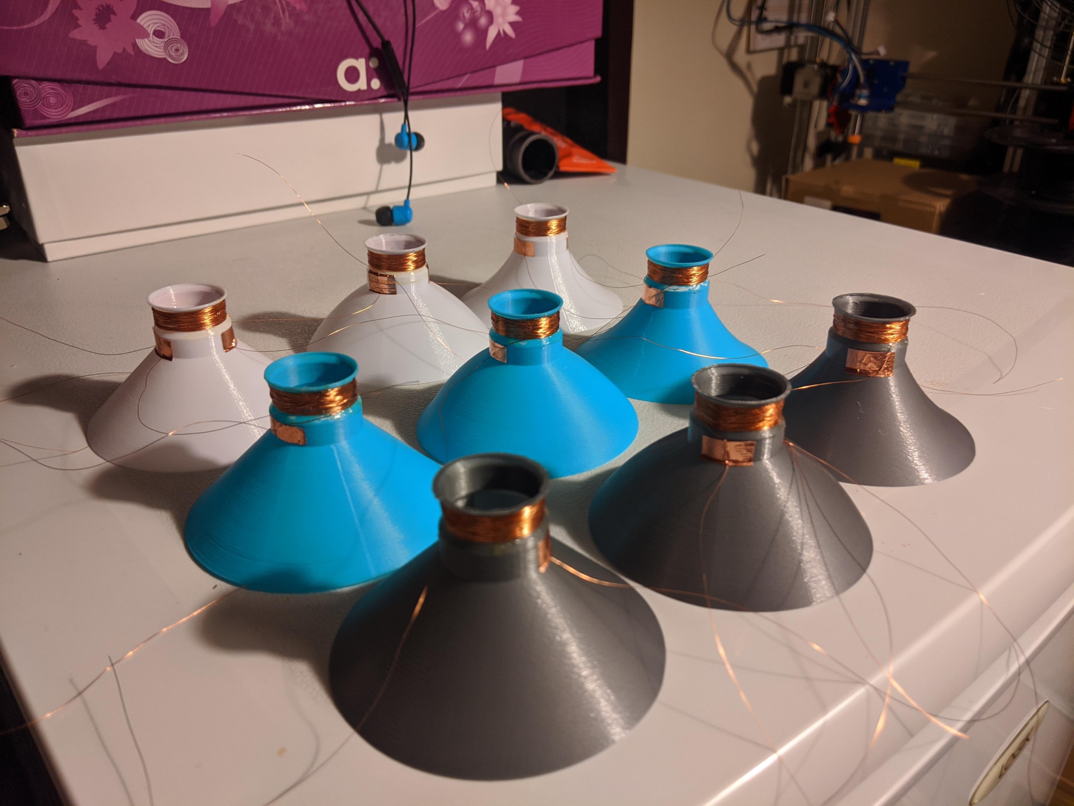

I have started a series where I will be testing different materials with 3 different cone profiles to look at how they react and how viable they would be as materials to use moving forward.
This first video was using common base materials, PLA, PETG and ABS. Just posted in case any of you are interested in this side of the hobby.

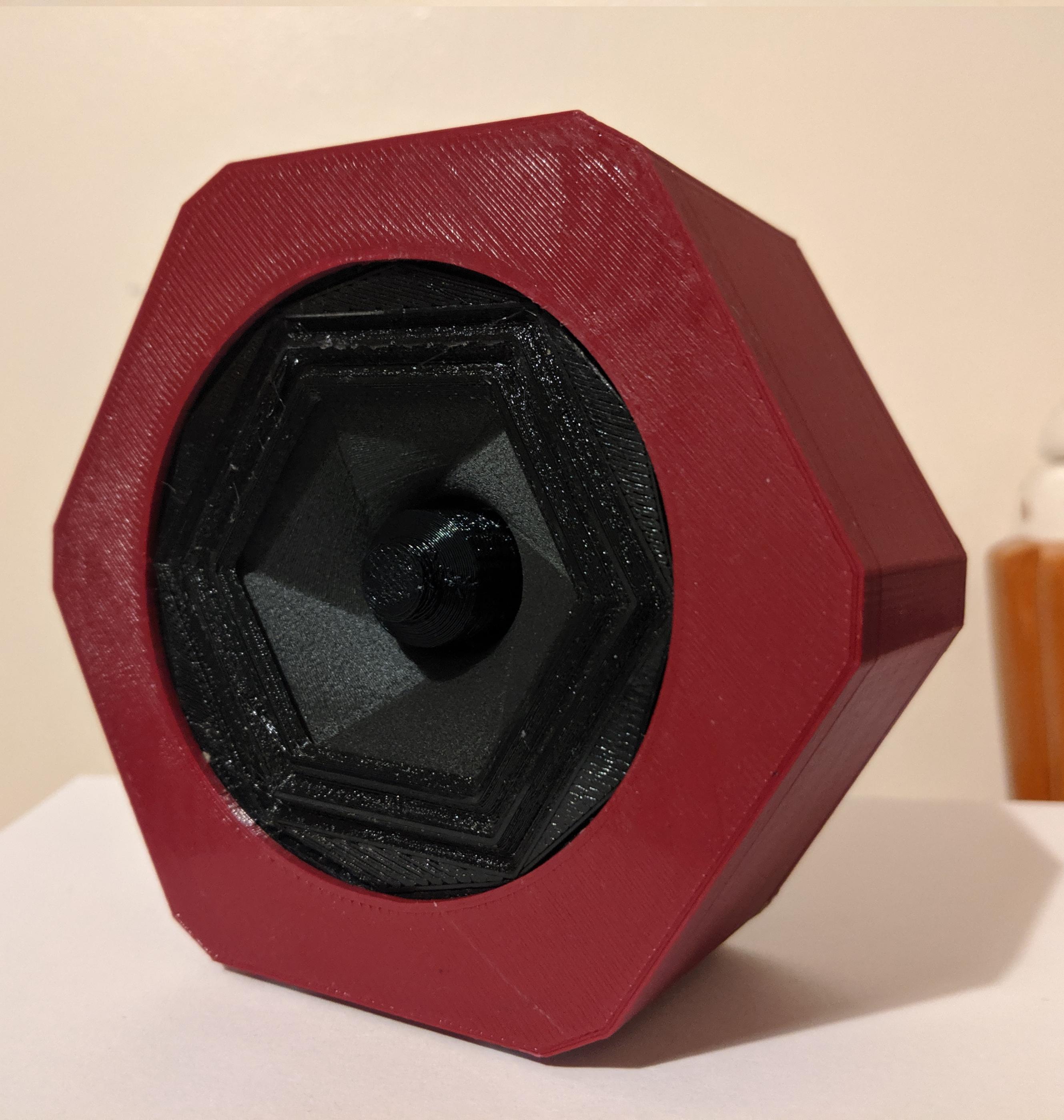

watched the entire video, very interesting, thank you Paul.
Here are my comments:
Would it be possible to have a paper cone as a reference? Say, a convex shape, if you can only have one... Exact same size as the printed ones, but normal pressed paper
I'm not an expert in 3D printing, but would it be interesting to use the 3D printing for what it excels the most: making complex shapes, that would otherwise be impossible using normal manufacturing process? It would probably require a lot of analysis to find the ultimate sweetspot: rigid, lightweight but damped, and, educated-guess here, I think the 3D printing would allow some kind of bi-structure, progressie structure or sandwich structure where the break-up is better controlled, along with the damping requirements, while having a very rigid and lightweight cone...
I personnally think the key is both the structure and the material; a combination. But the structure is probably the most important to start with, as the 3D printing opens possibilities to think ''outside of the box''

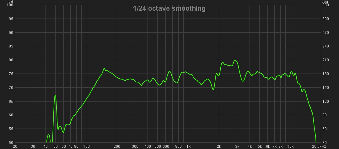

I have attached a frequency response of the FD51-4PE driver as this was my best result so far.
Paul
That's very promising, and I like the shape. 🙂
I'm looking at the voicecoils, and wondering if higher efficiency would be achieved with, er, neater windings.
I don't mean to belittle your work - the 3D printed bits look top-notch - but it looks to me like there's an unnecessary compromise there.

Thanks. I hope to keep improving as time goes on. Time will tell. The cone shape I came up with due to wanting different lengths between the VC and the cone outer edge, along with wanting the stiffness of the cone to also vary. I like the outcome and expect to use the design again, but this testing will clairfy the best routes for me.
@Chris661
Thanks for commenting and it is not belittling at all. The VC is like this for a few reasons, and yes, one of them in being lazy, but I will go a bit deeper than that.
1) This exact VC gap and cone was derived from my WF81 driver design which uses 0.25mm wire vs these at 0.15mm, so the VC gap was built for a much larger amount of wire. Usually this would be in a much smaller spacing.
2) With my printed designs, I early on hand wound them as cleanly as I could, taking some 15-20 minutes to do one at a time, test and then not like the outcome. This led me to go this route for the reason that (A) I can make and test much quicker (B) It makes it easier for 3D printing users to get involved without needing to be super careful.
This is also why my designs are a under hung magnet motor design and why the motor is weak on these tests. It is easier to adopt more people into this experiment by making it easier and more cost effect to be involved.
As I push upwards in by knowledge and design, you will see the performance increase accordingly. Will there be clean windings at some stage? Possibly, but I would want to design a machine to make them here in house before that.
As to the motor power, this one is only 0.5T, and my next driver planned is to have around 0.7T. With my FD61 prototypes last year I managed to reach 1.1T, so getting to a reasonable power is not a concern. It simply makes the tests and experimentation easier 🙂
