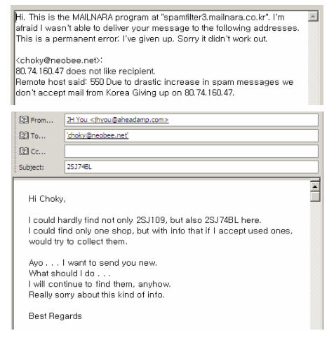

they even not replied to my several mails,from few accounts (to jump through potential spam fillters ) ........
all I can is just to
btw-for my knowledge Borbely always have them
Michael Mik said:Hello Cviller
www.fibra-brandt.com will still have some, in December I payed
EUR 4.57 each..
Good luck
