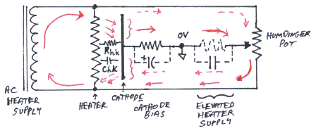

popolin, the test setup is aimed at measuring hum voltage level at the output of the first preamp stage in an amp, that is being induced by the heater voltage.
The first stage is typically the most sensitive stage to hum ingress, and I'd hazard a guess that the most ubiquitous first stage circuit is a simple cathode biased 12AX7, so given that the 'Filaments DC or AC' topic can be quite broad I've just limited my testing to that subset of stage/circuit topology.
The typical hum ingress means was discussed by Cooper back in 1944 (Valve Hum. C. E. Cooper, July 1944. Electronic Engineering, courtesy of Merlin):
The induced hum current paths due to the heater voltage can also be shown in the following simplified schematic:
So the test described in post #128 is not aimed at measuring hum induced by heater current flow per se.
For a 50Hz heater voltage frequency and DCV elevated heater, the 50Hz hum level at the output of the test stage was at or below about 6uVrms, and the 100Hz (H2) hum level was about 17uVrms. My HP3400A mV meter doesn't provide representative rms voltage levels below 100uVrms, so the comparison check of dB to Vrms was done at a somewhat higher level.
https://dalmura.com.au/static/Heater-cathode%20conduction%20plots.pdf
I used a different test jig to measure Rhk a few weeks ago, and that jig allowed Chk to be measured. There was no noticeable change in Rhk (or Chk) when the heater was powered compared to not powered - I did think that was an interesting outcome. That jig didn't allow me to DCV elevate the heater, and I may get a chance to check if I can't get around that limitation. That jig measured the Rhk and Chk between the total length of interface between heater and cathode. The heater wire is typically an 'out and back' wire in the cathode tube - so its likely in practise that the effective Rhk is 2x, and effective Chk is x0.5, as the heater AC voltage varies along the heater wire length.
But put in context, this detail is of little concern when the cathode bias resistor is sufficiently bypassed.
My main incentive with this test was just to look at a typical input stage circuit and valve. The signal to hum ratio of stages after the first stage typically gets much better as the signal level is so much higher - but that said, if a subsequent stage couldn't suppress heater induced hum due to an inability to bypass a particular part of the circuit then yes that stage could become the dominant contributor of hum.There are a couple more tests along that vein.
