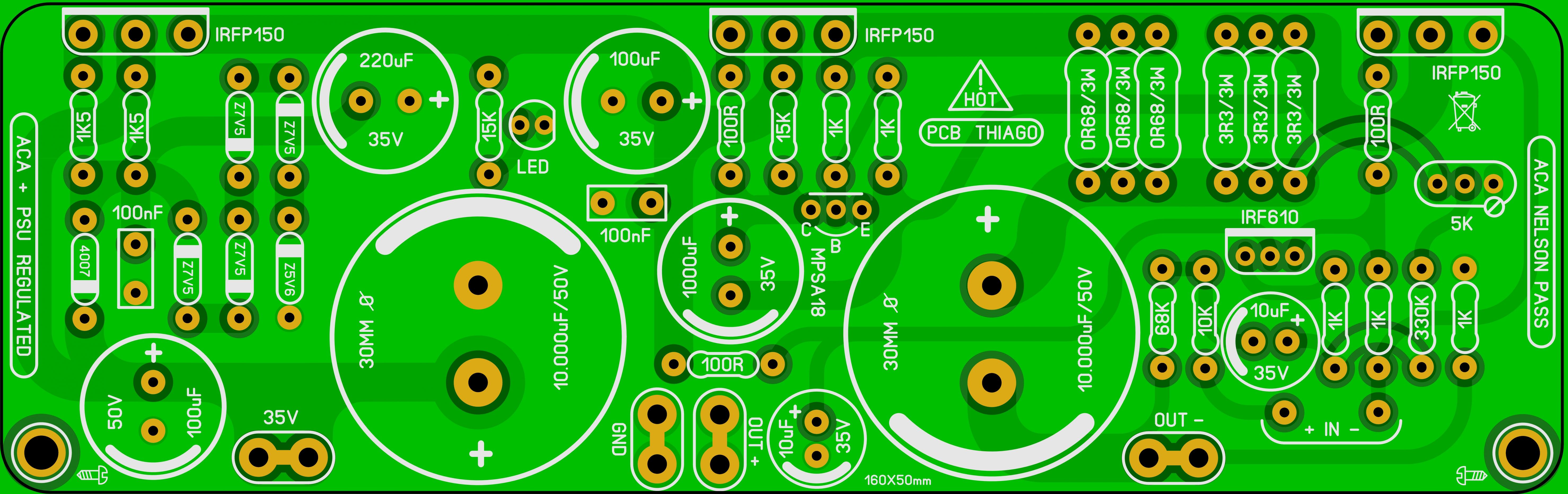

Thiagomongi,
This is one of the freshest variants on the ACA that I have seen. Most people using ACA are driving with a 19v or 24v SMPS which are regulated and have typical 60mV to 100mV ripple. With a 35v supply - I assume you are using a traditional rail from one of your class AB trafo/cap bank PSU's - you are really pushing the power rating up. What is the operating voltage of this shunt regulated amp design now?
Thansk,
X
Beautiful layout btw.
