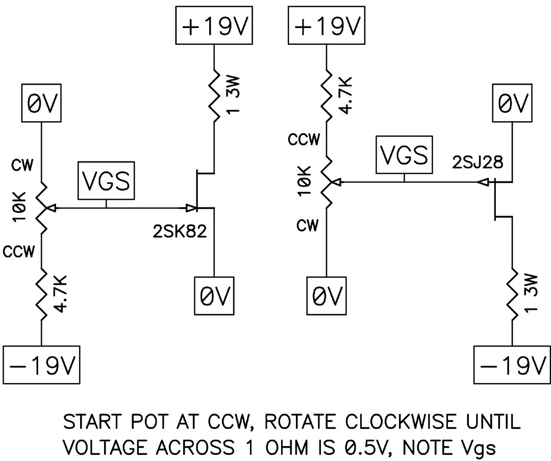

You can just reverse the bias polarity - +19 for the N channel, -19 for the P
:cool:
Good thinking Papa.
If using to247 lateral mosfets my brain is sought of visualising running wires from the gate pads on the pcb to the opposite polarity mosfet.
However Vgs is much lower on lateral mosfets ie less than the 2.5V reference on tl431, so that would need to be swapped for maybe adjustable lm385 with 1.25V reference, I'm guessing.
The second question would be is running the modulated regulated cascode irfp devices still beneficial with lateral mosfets? I guess it would be.
