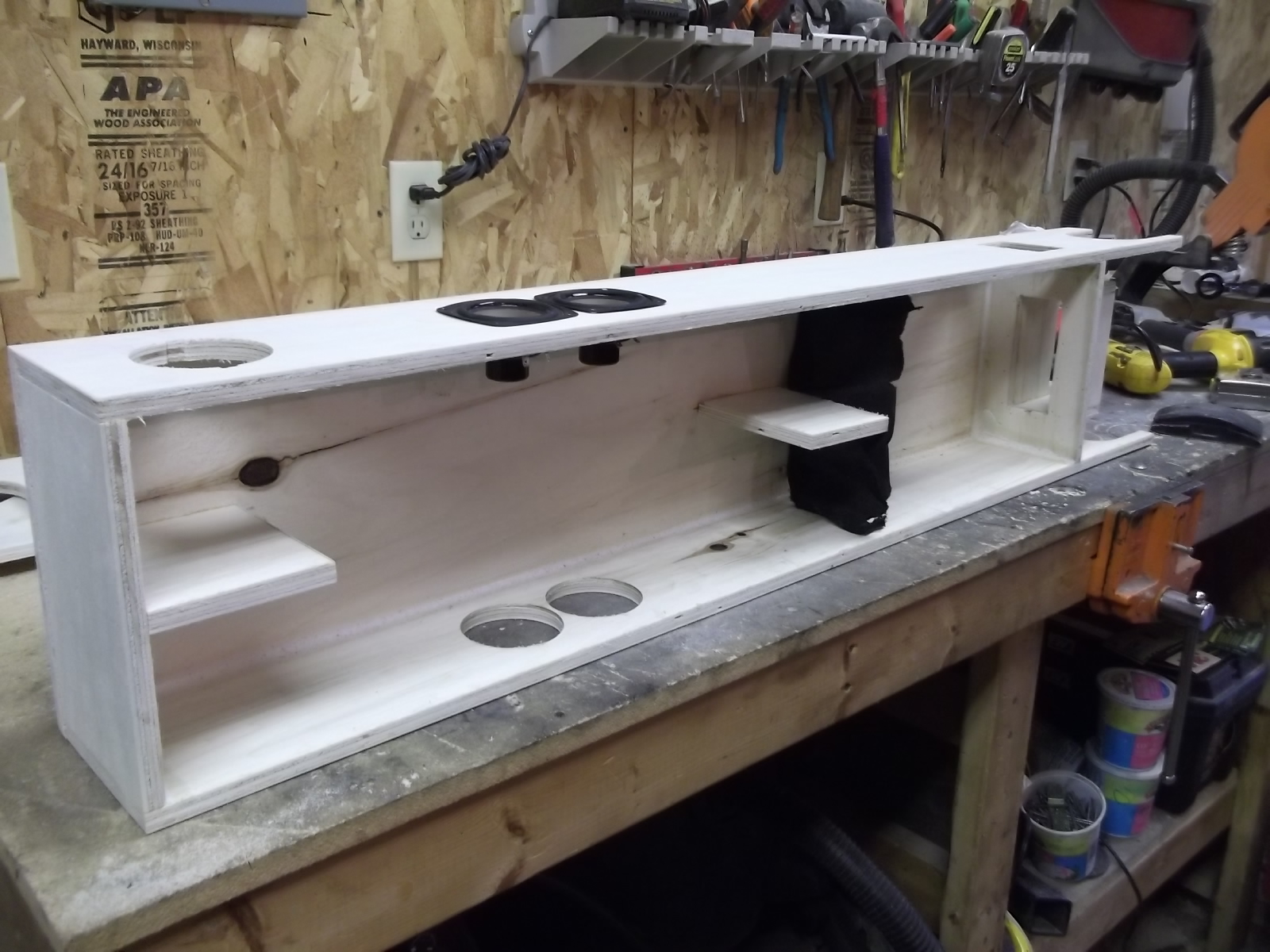

thanks, Brian, I started to make the nanotowers today, tomorrow edge banding the plywood and sanding and staining... I have some carpet foam padding, u lined them all 4 walls (front and back little less?). Most likely I will glue the cabinet, so I want to get this right first time...

Hi, gychang,
On the front, I ended the padding an inch or two under the driver. On the back, I ended about the same distance above the port.
Your cabinets look very good! Good luck in the assembly. I think you will be very pleasantly surprised by the sound these speakers produce.

gychang,
I highly recommend doing some tinkering with the stuffing.
An easy way to do this is to glue up all pieces except the back. Then install some self-adhesive foam weather-stripping around the perimeter of the cabinet and use several clamps to bind the back panel to the cabinet. This provides a good seal and allows you to tweak the lining and/or stuffing to the way you like it.
I lined 3 of the 6 interior walls with 2" thick fiberglass insulation. This wasn't enough, so I proceeded to add polyfil and adjust it till I found the sweet spot (which is very subjective). Then I glued them up tight.
Good luck. Very interested to see the finished speakers and hear your thoughts on the sound! :)
