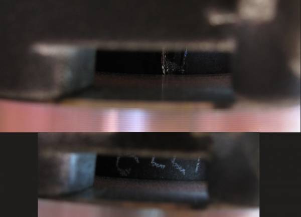

Behind the vented spider a close up of the voice coil former . No coil can be seen above the top plate showing that the driver is probably using an under-hung motor.
