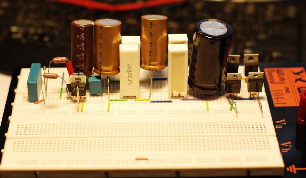

Well I have finally got around to prototyping the YARPS powersupply, well 1/2 anyway.. I don't have enough jumpers in my new breadboard kit to do a full implementation so just did 1/2 (I haven't got the transformer yet either and only had a single 15V secondary as well)
Thought I'd take a photo before powering it up just in case it smokes! Tested up to the reg section and the CRCRC is working well. only approx 2mV ripple before the reg with around 300mA of current drawn.
Stupidly I put the -ve on the wrong side for doing the full implementation on the breadboard should I get some more jumpers :roll:
