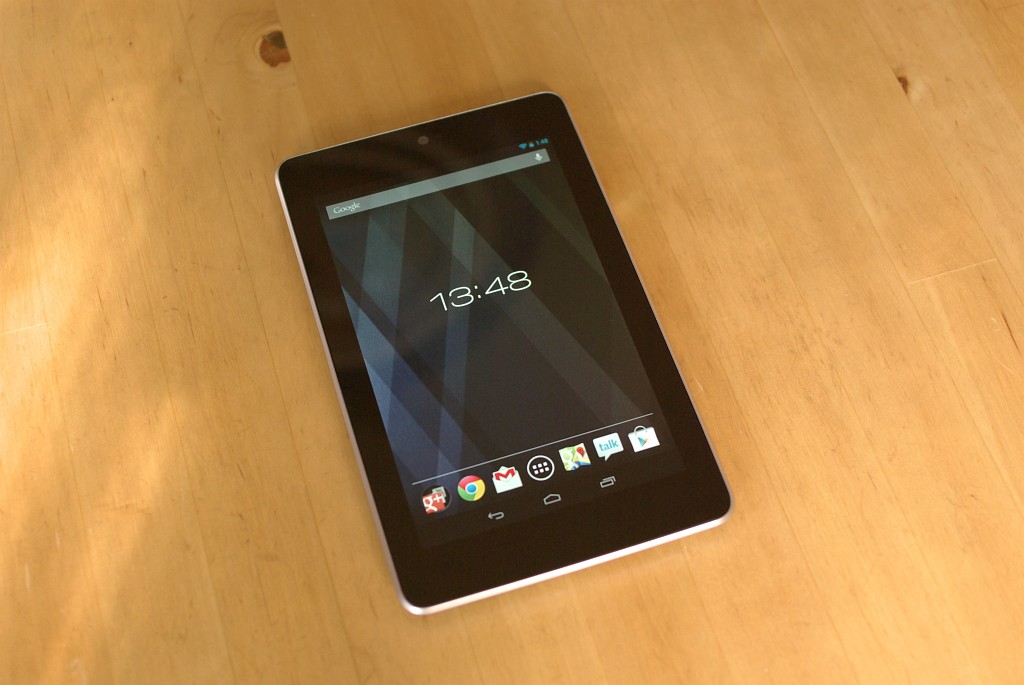

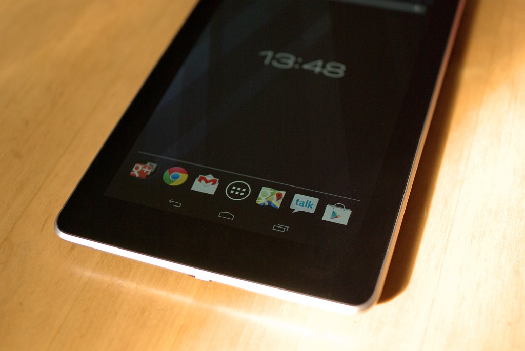

My Nexus 7 Tablet
Posted 12th November 2012 at 07:54 AM by rjm (RJM Audio Blog)
Updated 18th November 2012 at 05:03 AM by rjm
The Nexus 7 is cheap. I paid 19,800 yen for my 16 GB model, shipping and tax inc., and it came with 2,000 Yen credit to buy apps and movies and such in the online Google Play store. And yes, its plastic, even the silver metallic trim around the edge is just a silver-coated plastic part. It is solid, however; sturdy, well-built, and good-looking. The back is covered in grippy, dimpled rubber that feels like leather. The screen is a little dim, but high resolution (800x1280) ~220pi, pretty to look at and easy to read.
With a 7" screen and default portrait orientation the device is closer in spirit to a large smartphone than a small tablet. A giant, wi-fi only smartphone. It's a handy size for reading paperback-format books, comics, and news articles, but not so hot for magazine format publications and A4-formatted journal articles. Browsing the web is generally fine, but the experience varies widely depending on the individual layout of the web page. As you might expect,...

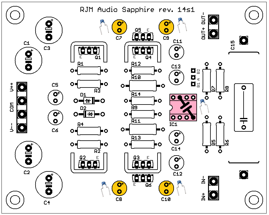

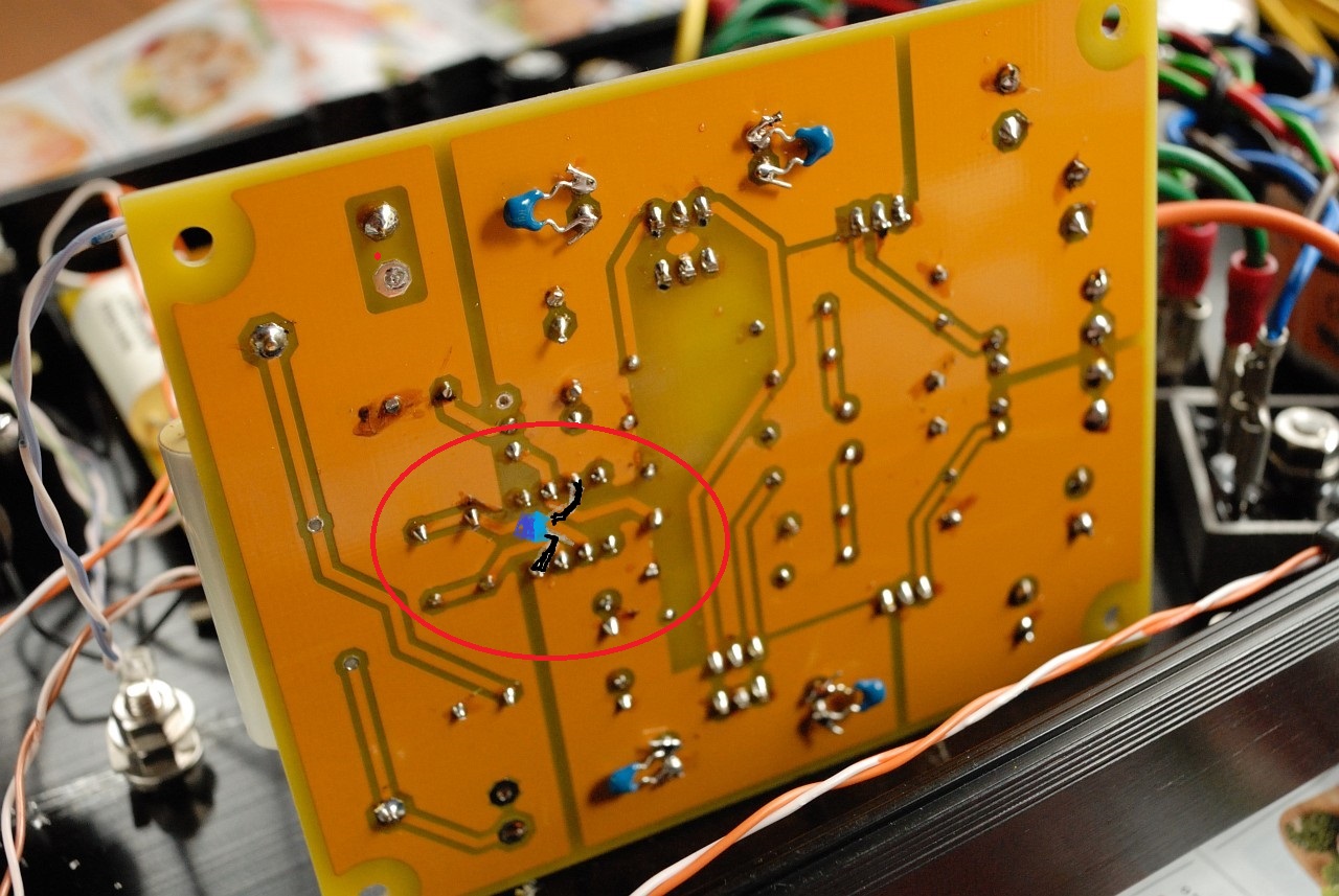

Bypassing, Goldilocks, and the Sound of Nothing
Posted 31st May 2012 at 06:28 PM by rjm (RJM Audio Blog)
Updated 1st June 2012 at 11:53 PM by rjm
Douglas Self writes,
Quote:
The 5532 and 5534 type op-amps require adequate supply decoupling if they are to remain stable, otherwise they appear to be subject to some sort of internal oscillation that degrades linearity without being visible on a normal oscilloscope. The essential requirement is that the positive and negative rails should be decoupled with a 100 nF capacitor between them, at a distance of not more than a few millimeters from the op-amp; normally one such capacitor is fitted per package as close to it as possible.
He's someone who should know. Anyway, it doesn't take much digging on the internet to confirm beyond reasonable doubt that bypass caps should be as close to the op amp power pins as possible. So thinking about my previous experiments with bypassing the Sapphire, by adding bypass caps around the transistors I also effectively also added a bypass for the op amp, but a rather poor one as the power-pin-to-power-pin round trip loop distance is probably 10...

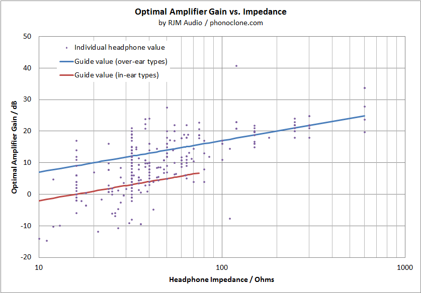

Headphone Amplifier Gain
Posted 2nd April 2012 at 08:45 AM by rjm (RJM Audio Blog)
Updated 2nd April 2012 at 11:43 AM by rjm
I posted this earlier today, but I think it deserves to be put in the blog - if nothing else so I can find it again next time ... and there always seems to be a next time when it comes to calculating headphone amplifier gains.
Starting at the beginning, the encoded data on a CD goes from 0 to 1 in 2^16 steps, but in a typical CD player or soundcard, the DAC output is -2.8 V to 2.8 V or 2 V rms or 6 dB. Many sources, such as phono stages and portable audio, are lower, perhaps as low as 250 mV.
How loud the sound is depends on the source signal amplitude, the position of the volume control, the circuit gain, and the impedance and sensitivity of the headphones.
As a practical matter, most people would want the volume control at the 9-10 o'clock position for "normal" listening.
For standard "line level" source, the gain required to keep the volume control at a 9-10 o'clock varies depending on the impedance...
