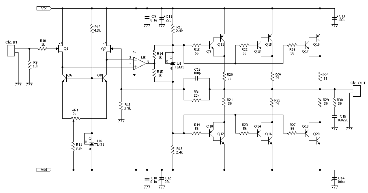

http://kstlab.web.fc2.com/pro003.html
It is certainly a little bit different. One might be tempted to say "gilding the lily", but come on, headphone amplifiers are just the right place for these indulgences.
Building your own long tailed pair (LTP) to bolt in front of an IC op amp has fallen out of favor in recent years. I must admit I couldn't see the point then, and still don't.
I've seen a number of headphone amp circuits with 3 paralleled pairs of output devices. I wonder if there any real advantage over simply using one pair at 3x the current, perhaps with slightly larger transistors?

    A very interesting design indeed. And quite elegant I'd say
