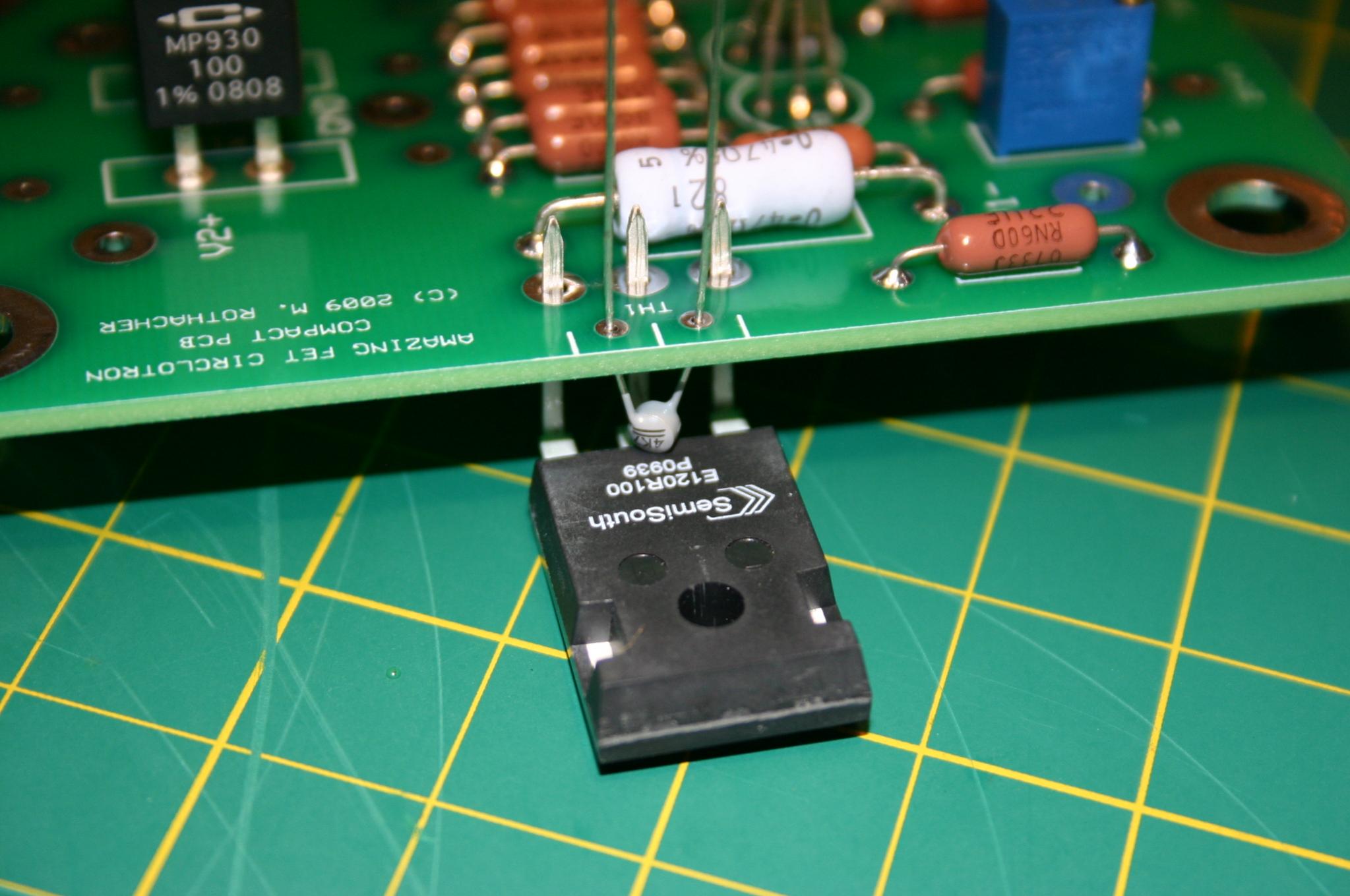

Compact PCB For All JFET Circlotron
Posted 25th January 2011 at 12:59 AM by Michael Rothacher (Audiohobby.com)
Updated 2nd October 2011 at 11:59 AM by Michael Rothacher
This is the artwork for the PCB in the pictures. It fits into the ExpressPCB miniboard profile so it's a little cheaper to have made.
It will be necessary to check the orientation of the bias pots (I can't remember). I wouldn't want you to blow-up your $30 JFETs.

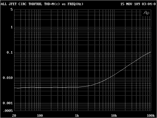

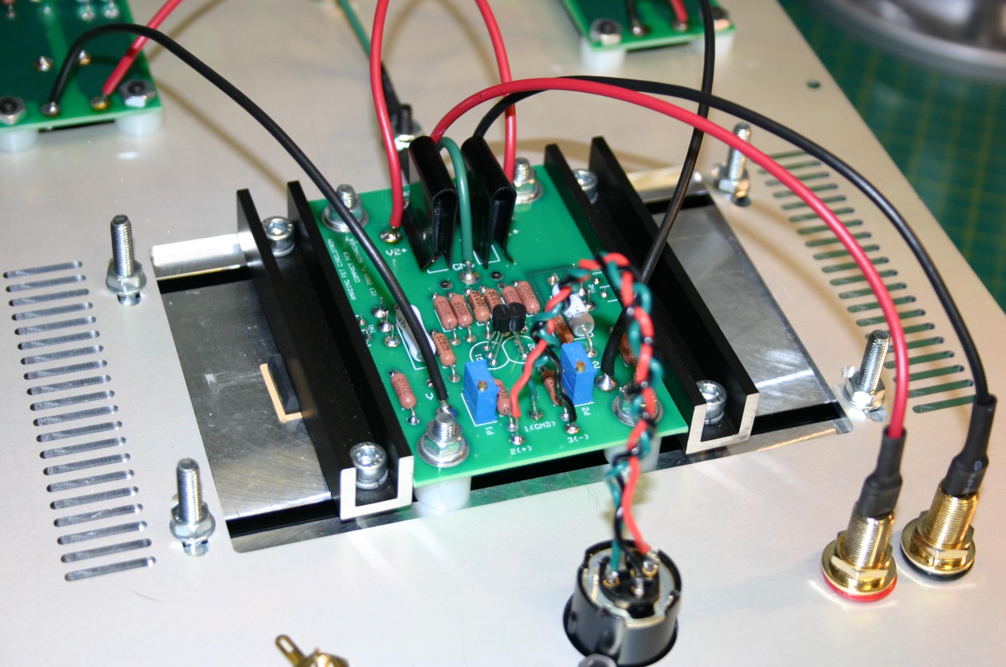

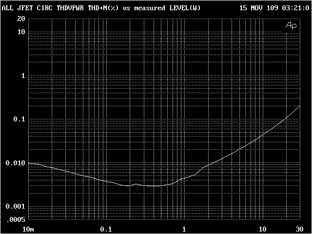

All JFET Circlotron
Posted 22nd January 2011 at 11:29 PM by Michael Rothacher (Audiohobby.com)
I've been mostly out of the audio hobby for a while, but I've had a few inquiries about the SemiSouth version of the Amazing FET Circlotron as of late. So, I wanted to post the performance graphs here before I lose them.
Click image for larger version
ID:	311   Click image for larger version
ID:	312   Click image for larger version
ID:	313   Click image for larger version
