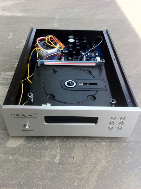

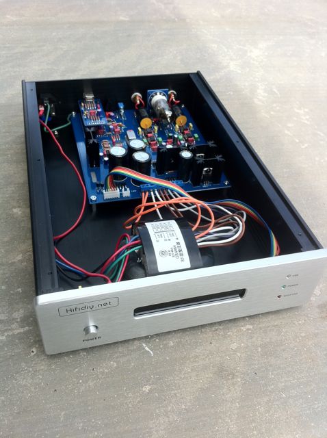

CD transport
Posted 7th July 2011 at 12:48 AM by alexcp (My DIY projects)
Built from a kit. Sound lacks finesse.

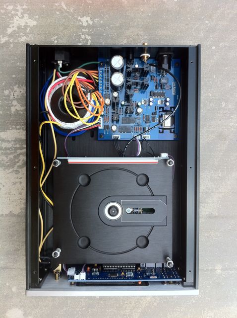

24/192 DAC
Posted 7th July 2011 at 12:46 AM by alexcp (My DIY projects)
Updated 16th March 2013 at 02:33 PM by alexcp
Built from a kit. I don't like the sound at all.

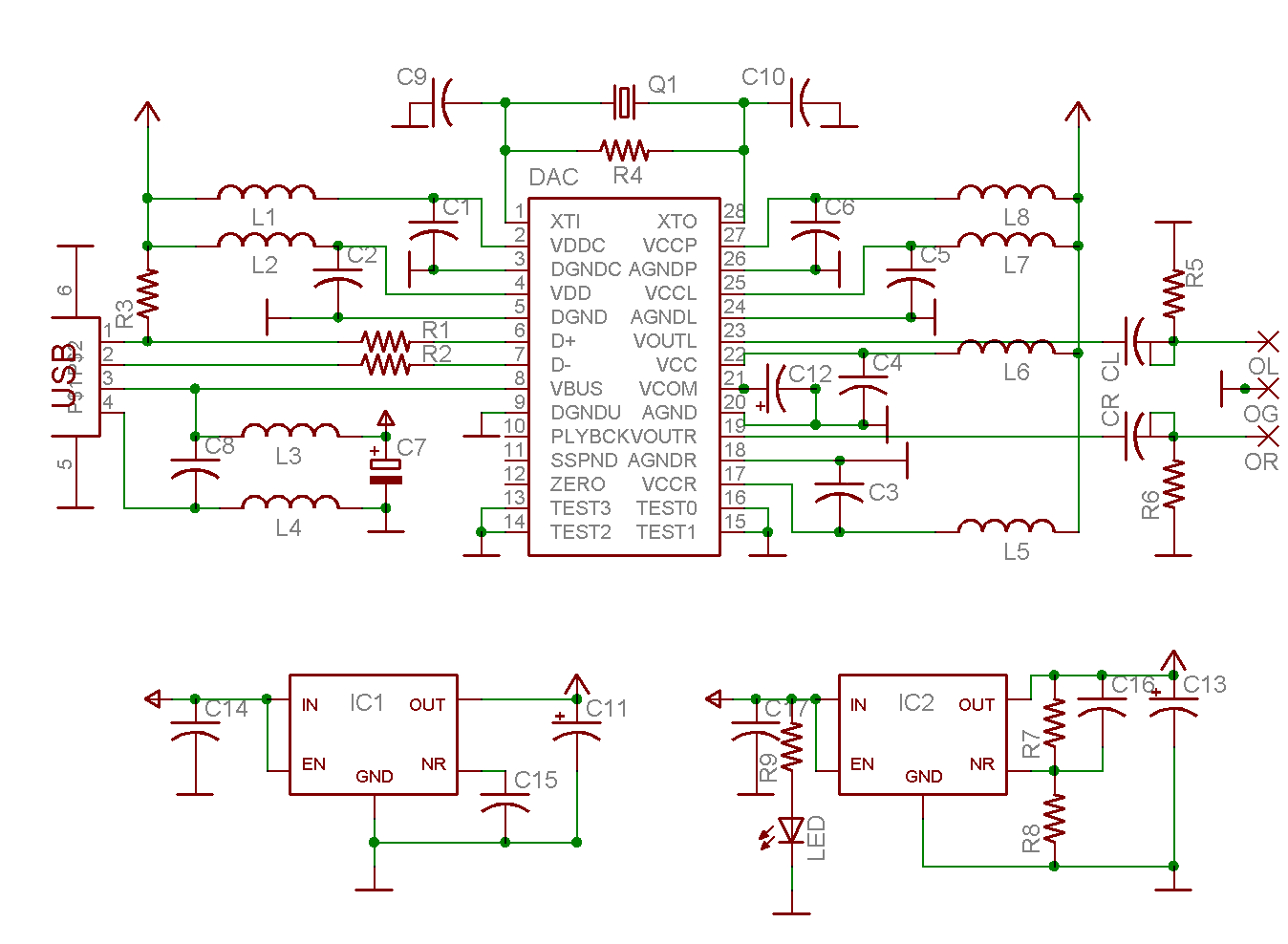

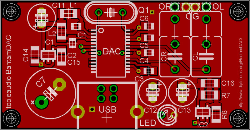

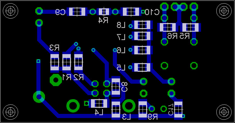

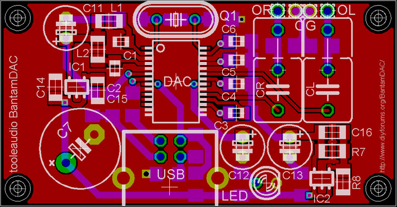

BantamDAC
Posted 12th August 2010 at 07:57 PM by alexcp (My DIY projects)
Updated 11th April 2016 at 08:09 PM by alexcp
ezDAC lacked a USB input, so I leveraged my newly acquired SMD soldering skills building BantamDAC from a kit. While PCM270x-based USB DACs are rather common, BantamDAC is a compact (1" x 2"), neat version.
