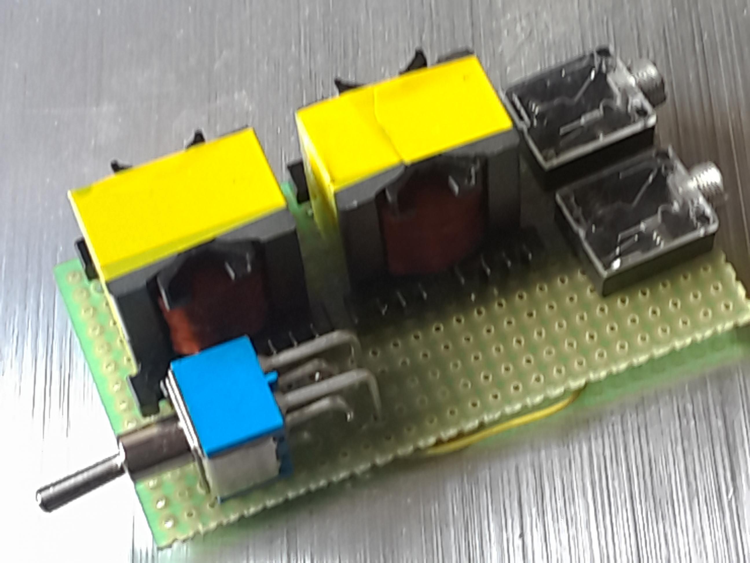

Posted 15th April 2016 at 04:09 AM by abraxalito
Updated 25th April 2016 at 03:15 AM by abraxalito
Listening to headphones creates, on many recordings, an unnaturally wide soundstage. I decided to play with the idea of 'crossfeed' whereby some deliberate crosstalk is introduced between the two channels. With transformers its jolly easy to do - just create an extra winding with the right number of turns then put this winding in series with the main output of the opposite channel.
In the picture I've done this with some EP17 ferrite cores and added a DPDT changeover switch to A/B between the original and crossfed version. The crossfeed factor I've gone for is 25%. It works in practice in that there's a more natural presentation without any 'extreme' stereo effects (almost a kind of phasiness on some recordings). But sometimes I enjoy the 'all around' effect so switchable is the name of the game
Trafo winding details as follows - primary 500T of 0.1mm, two secondaries first 120T 0.21mm, second 40T 0.21mm.
Made a second one as a colleague liked...

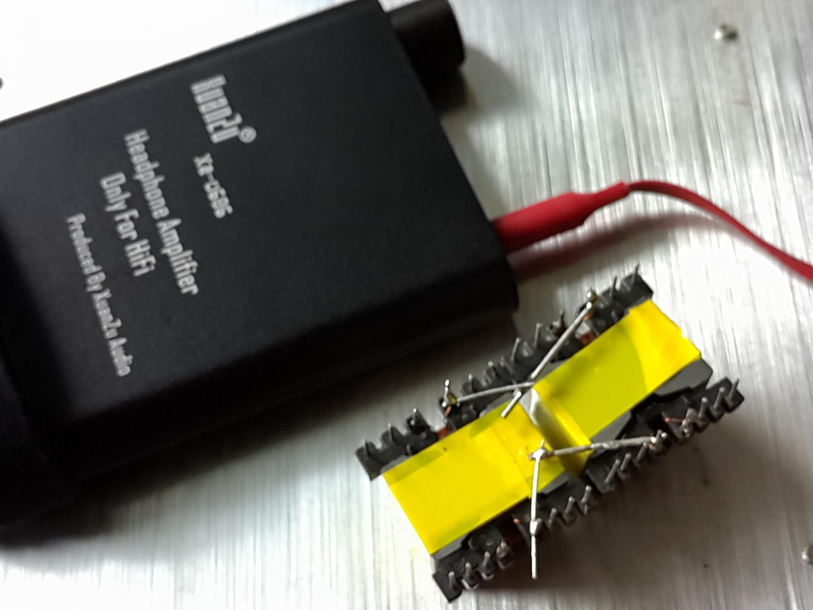

Pocketable headphone transformers
Posted 24th March 2016 at 02:44 AM by abraxalito
Updated 25th March 2016 at 11:54 PM by abraxalito
Seems I got a bit carried away with listening to my heavily modded XuanZu amp in the last-to-one blog post. I even considered it was superior to my current headphones - that would mean shelling out on some new ones. Before I went shopping though I did try it into my DT880s, which are 600ohms (hence I usually only use them for special occasions) - they sounded cleaner, although considerably quieter. This amp doesn't have enough voltage swing available to deliver the SPLs into such a high impedance. So was the cleanliness of these phones due to their being higher quality (they're at least 4* the cost of the others)? Or just because of listening at a lower level?
When my over-enthuasiasm for the amp had subsided a bit I decided to consider a way to answer these questions. If the amp was indeed not producing the artifacts which I was hearing on piano into the low-Z cans, then putting a 2:1 step-down transformer on its output would make no difference at all. The amp has plenty...

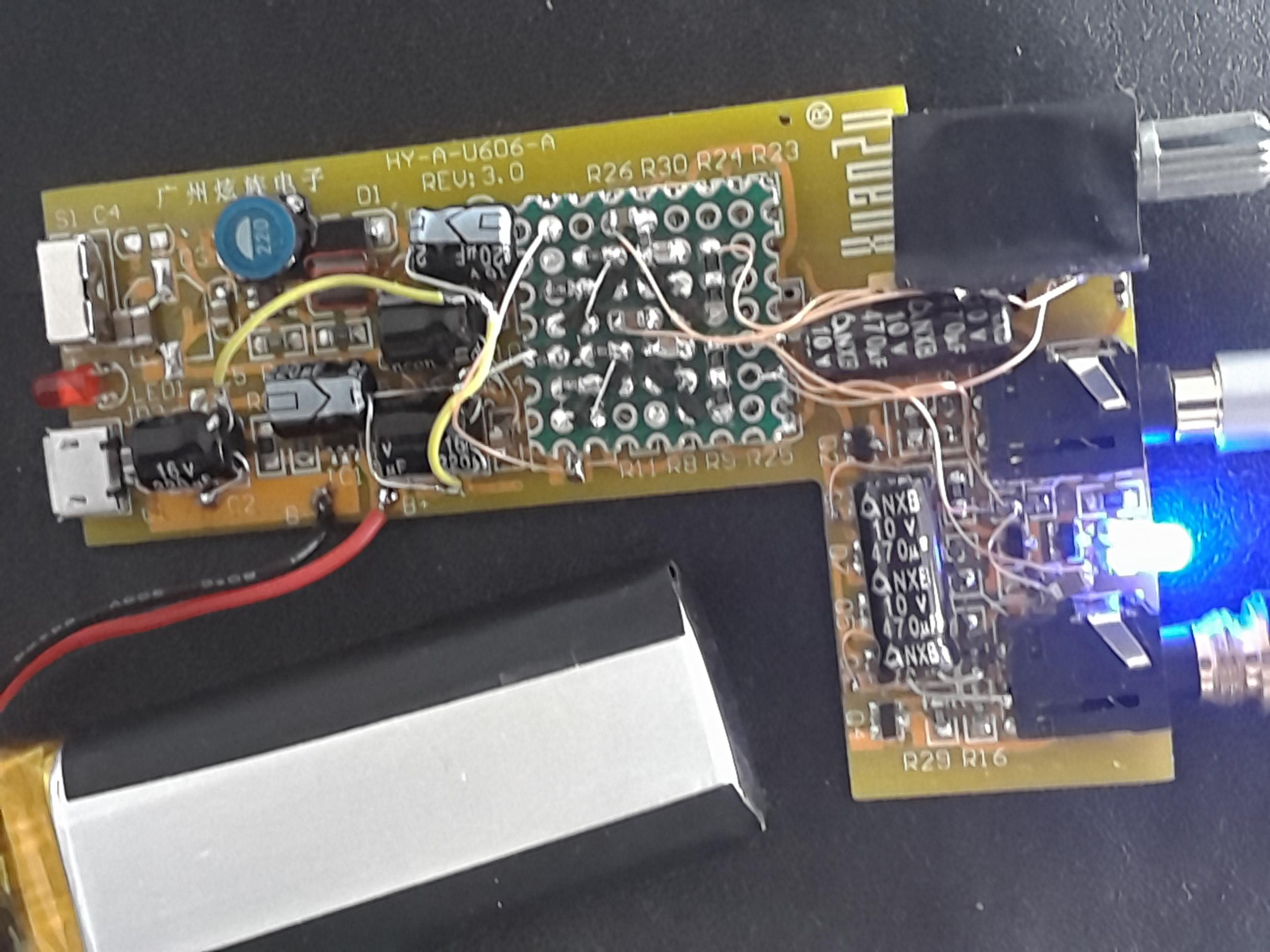

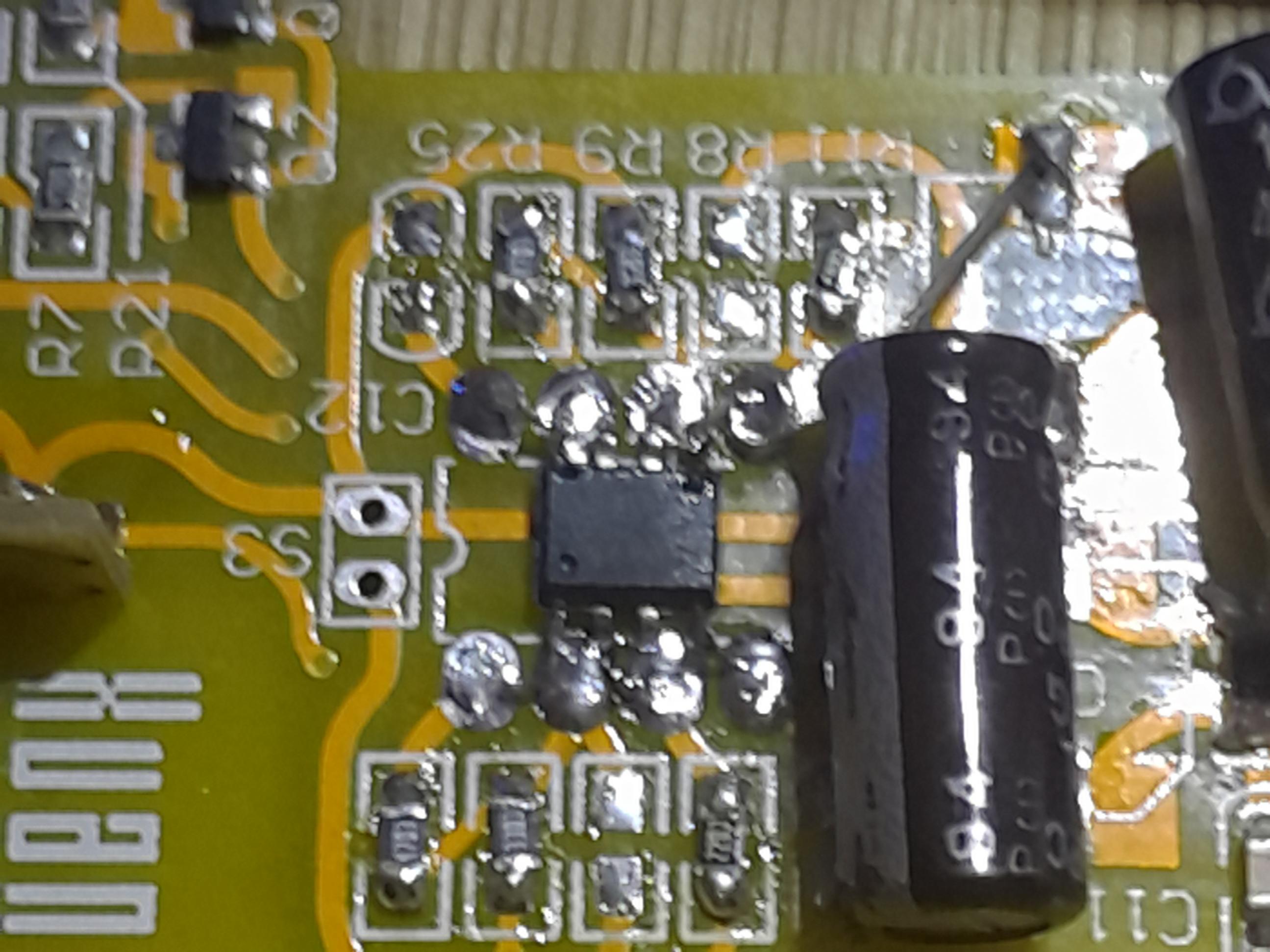

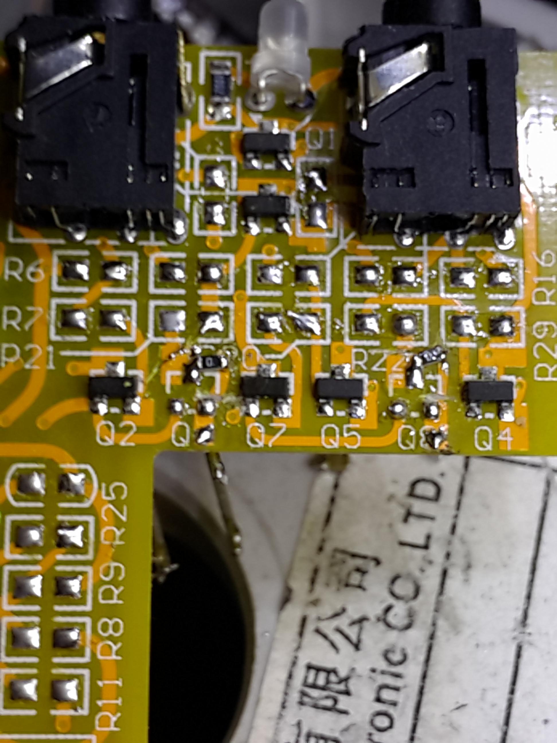

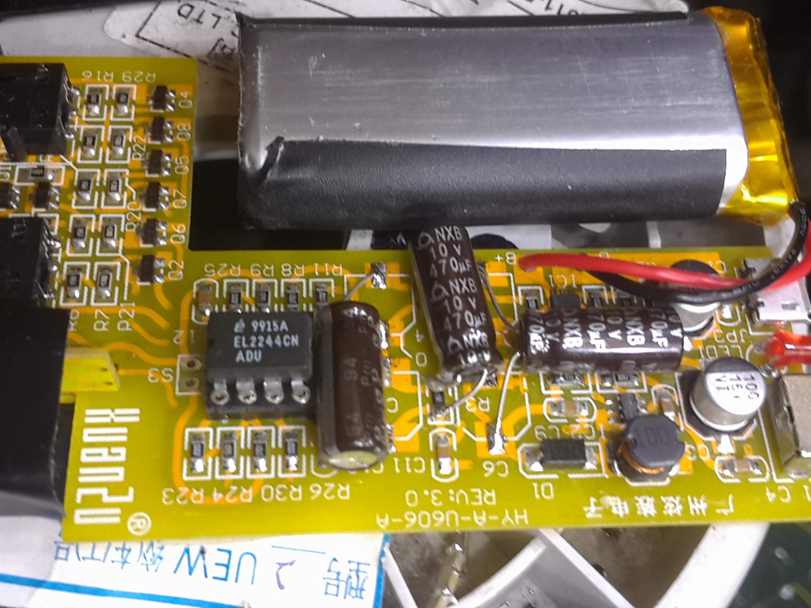

Posted 27th February 2016 at 12:22 AM by abraxalito
Updated 14th March 2016 at 06:23 AM by abraxalito
This device is a steal on Taobao, but having had a quick listen last night it could sound clearer. When connected to my smartphone (Meizu MX4 pro) and compared side by side with my 'Buffalito' (not a blind comparison mind) into my SuperLuxes, there were a few notable deficiencies.
First the soundstage air was less apparent. Second there's some sibilance noticeable on voices. And third the background hiss is slightly more apparent and a slight whine comes from the power supply. So I figured - open her up.....
Inside its fairly simple, the more or less standard configuration of a pot, then opamp gain stage then discrete diamond buffer. Which is great because I already have experience with this topology. The power supply is a built in LiIon cell with a boost converter supplying 12V in a single rail and there's a passive rail splitter. The dual opamp is an EL2244, one I've not seen before in such a setup.
First up - the input pot is too low a value at...
